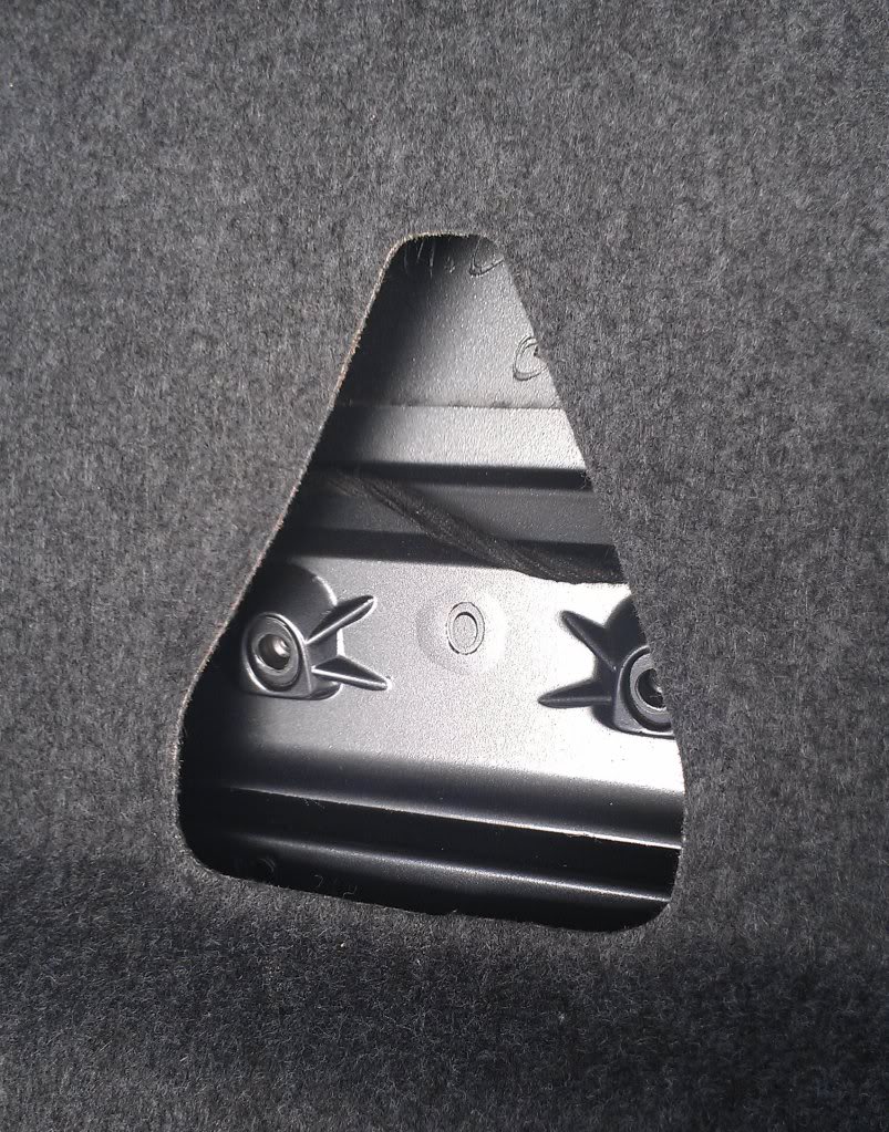

We’re going to want to pry off the grey carpet liner to get to the back of the brake light. And that means first focusing on the hazard plastic. Unscrew the plastic screw and remove the orange plastic. You’ll see two screws holding this black plastic triangle in place.
Once removed, it will look like this:

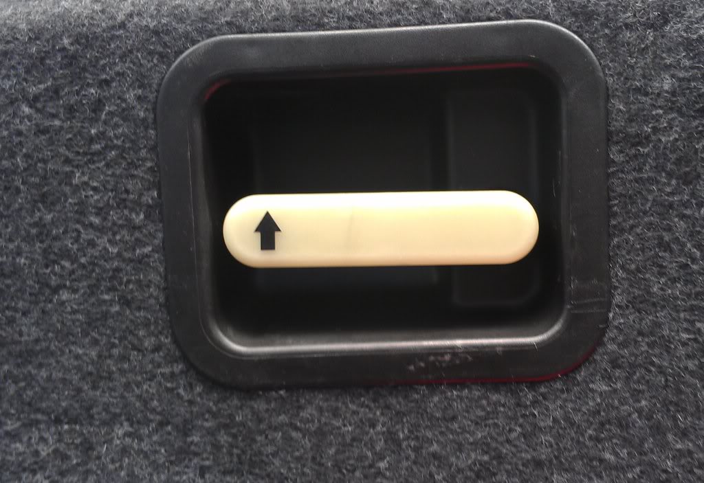

Look to your left, its time to work on the emergency latch, easily spotted by its glow-in-the-dark handle.
Separate the glow in the dark cover off the handle with a screwdriver or your finger until you see the handle itself.

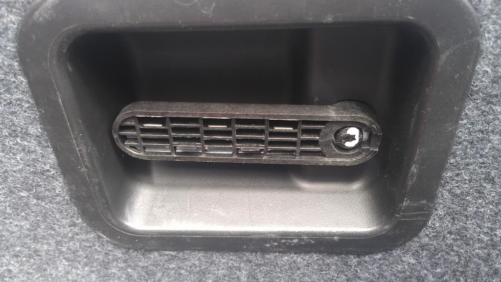

That screw with the white paint on it is next to go. Unscrew and remove by pulling the handle straight off, toward you.

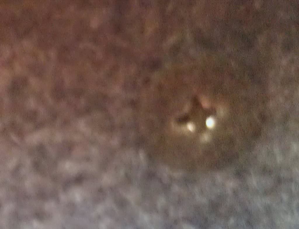

Next, under the grip is a sneaky little screw covered in carpet fiber:

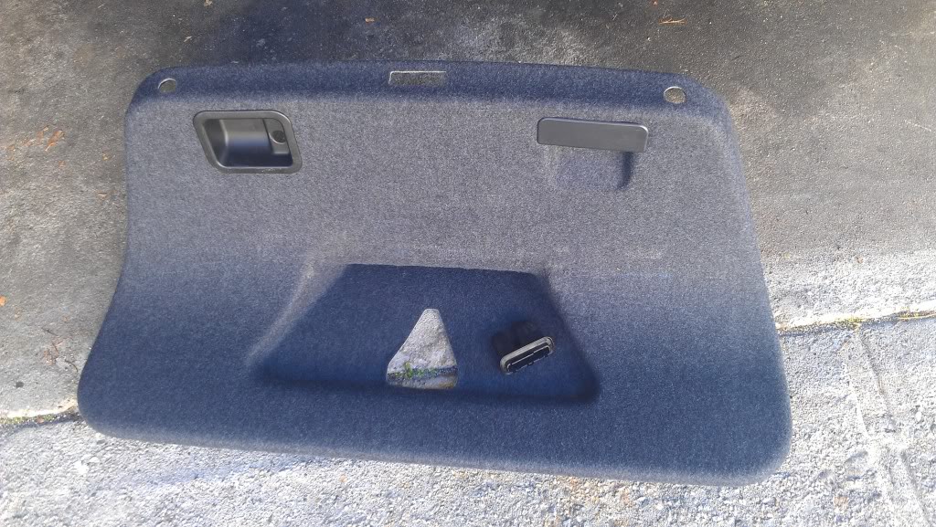

Great, everything is removed and now the only thing holding the liner on are clips. Start gently pulling the liner or trim away from the frame
Eventually you’ll get the entire mold off

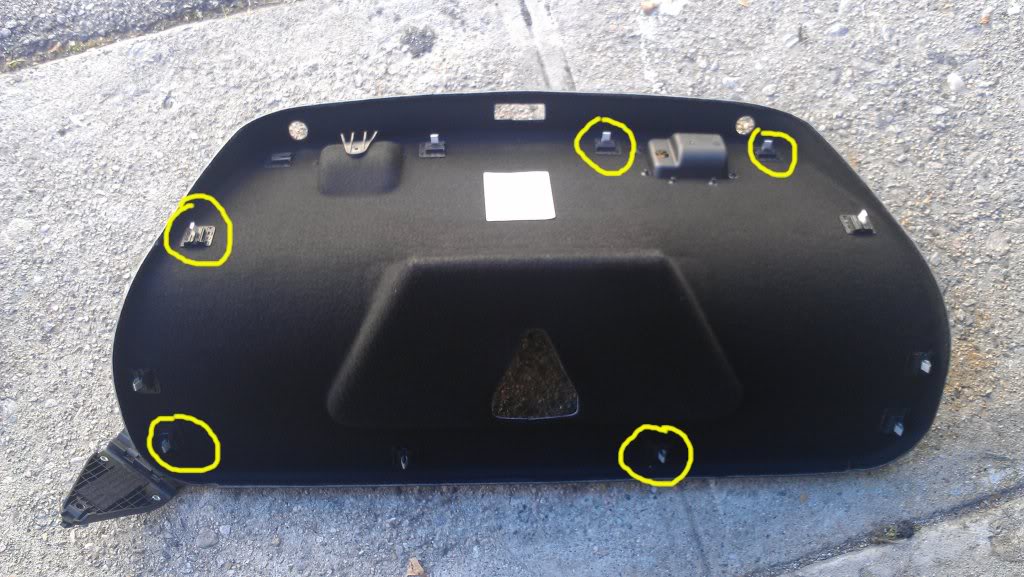

On the back, you’ll see the 12 clips that were holding it on-I've circled some on the pic with a highighter
Here’s a close up as you’ll want to make sure all 12 of these get fastened back to the frame when reassembling

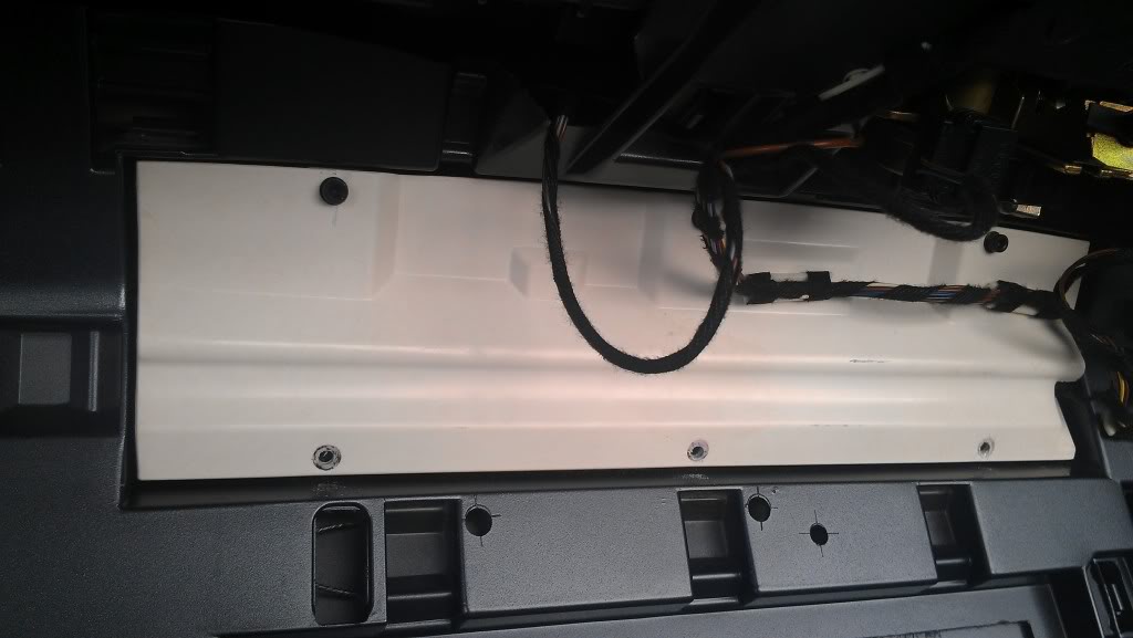

Ok, so here’s the trunk lid now.
The third brake light is an entire piece, not just a bulb, and it is the white piece we are looking at.
Just remove the 6 black screws, disconnect the clip on the right and you can pull out and replace in its entirety.
