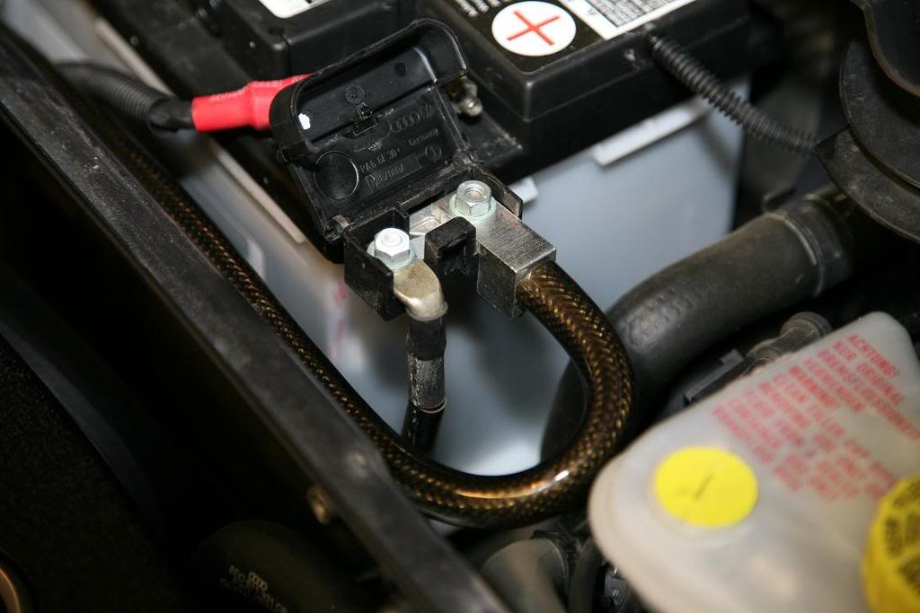

Here is where the power wire connects to the battery:

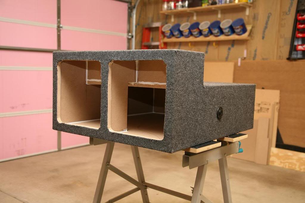

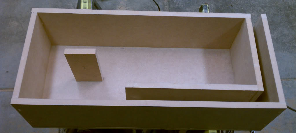

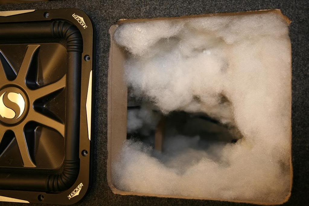

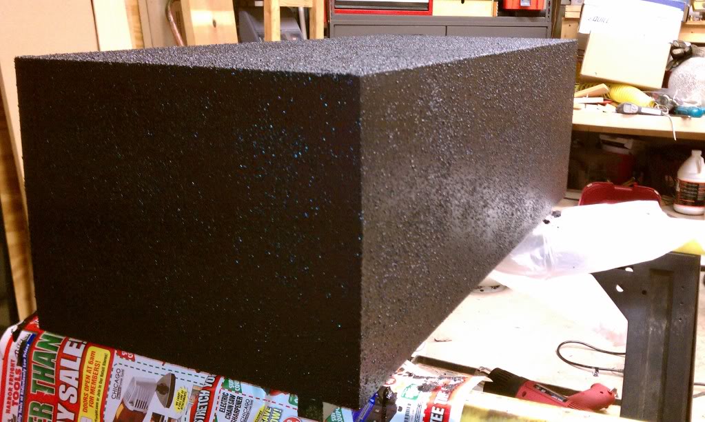

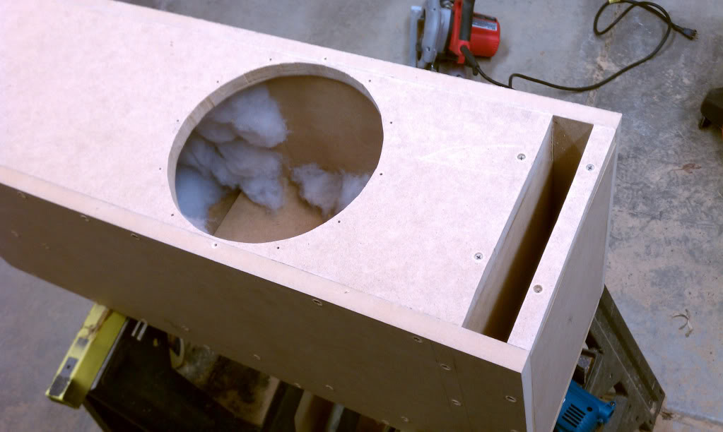

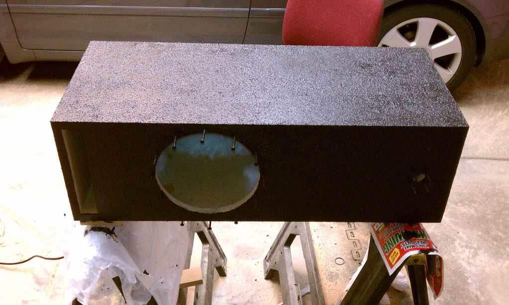

Using 0AWG and was running a Viper 1200.1 amp on 2 kicker L7s. Subs are sold and now I have a 10W7 in a new box I built. Going to change head unit, speakers amps soon, still waiting for parts. I am going to install Pioneer AXH-P3200BT head unit, Alpine M1000 for 10W7 and 2 M300s bridged for the rest. I have not chosen speakers for the surrounds yet.
