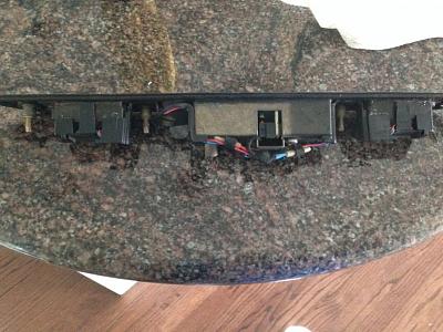

To remove the handle/lock and lights assembly you now have to make sure you push down the 2 clips at the top of the assembly located where the two lights are - you cannot see these clips, but you can feel them - here's the pictures. I wish I had these pictures before I struggled to remove mine!

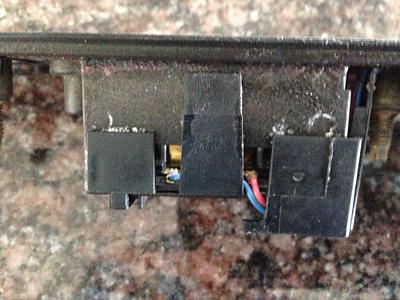

The clip I am referring to is in the centre of the picture with the blue and red wires disappearing behind it. Push the clip down so it doesn't snag on the trunk hole as you are maneuvering the assembly out.

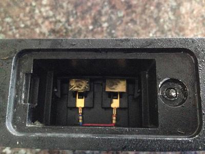

The last picture shows the screw that needed to be removed, I soaked it in ATF, then heated the casing around the screw from underneath, then rocked the screw back and forward until it finally came out with a pair of needle nosed pliers.
Fitted new bulbs, holders and screw - and made sure I put plenty of 'copperslip' on the thread.

my screws have almost nothing left of the head and really wanted to replace them. do you guys remember what size screws these things use? i can't seem to find that anywhere.
I'm trying to get the license plate light assembly out of a B6 sedan right now. I can't get my fingers between the light and the sheet metal of the trunk to push the clips you are showing in the pictures down. I feel like the outer bolts are stuck in the sheetmetal too. How were you able to press the clips down? Thanks!
