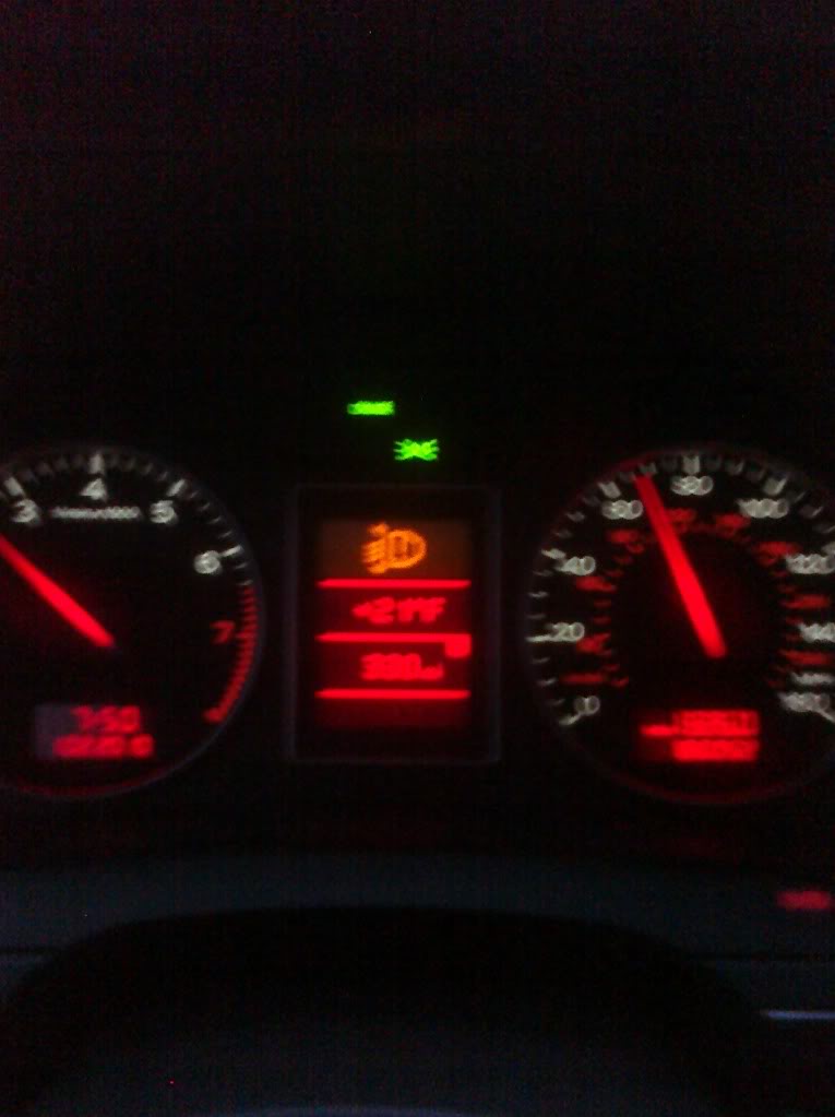

its the sign for the foglight. after takeing it to an audi mech. they informed me that i have a knock on my lifters, most likeley need to drop oil pan and clean it, also that my front engine mount is broken, both of them he says he can do for about 1500, the foglight light apparently is caused because the headlamps arnt properly aligned

That is not a foglight warning... Is the dipped headlight warning. The car you're looking at is a 3.0 with xenon self leveling headlights, and they have a motor to level them, when the motor fails, you can replace the headlight for about 1200USD, or maybe it just needs aligntment with a VAG com tool, which I doubt. The knock on the lifters wouldn't be fixed for about 1500 if there is any knock, that would be a sign of something else damaged and a possible timing belt job in need.

that light is indeed the leveling warning... after my accident I needed the motor replaced, the damn collision shop failed to realize that I have the self leveling headlights and skipped it til I brought it back to them and showed them the light.
You probably need a new motor.

well i indeed did buy the car. the light is still on what needs to be dione to repair the self lvling lights? do i need to replace a light? i was actualy looking at some headlights anyway... any particular modls i should stay away from or will i have problems with the self lvling if i replace with non oem?

you need to replace the leveling motor....
