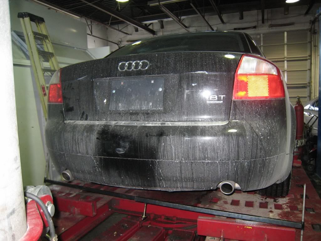

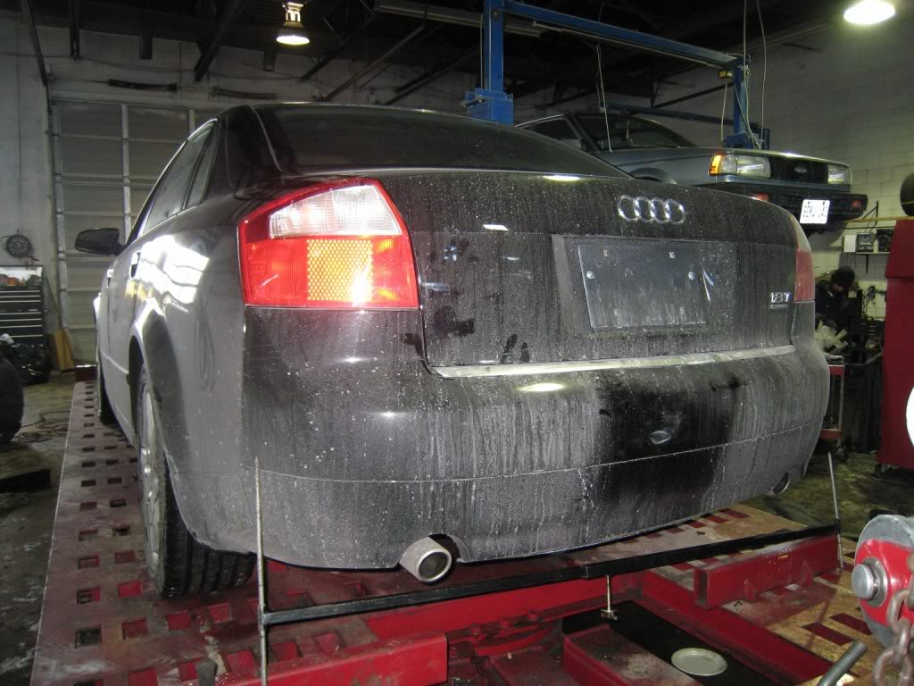

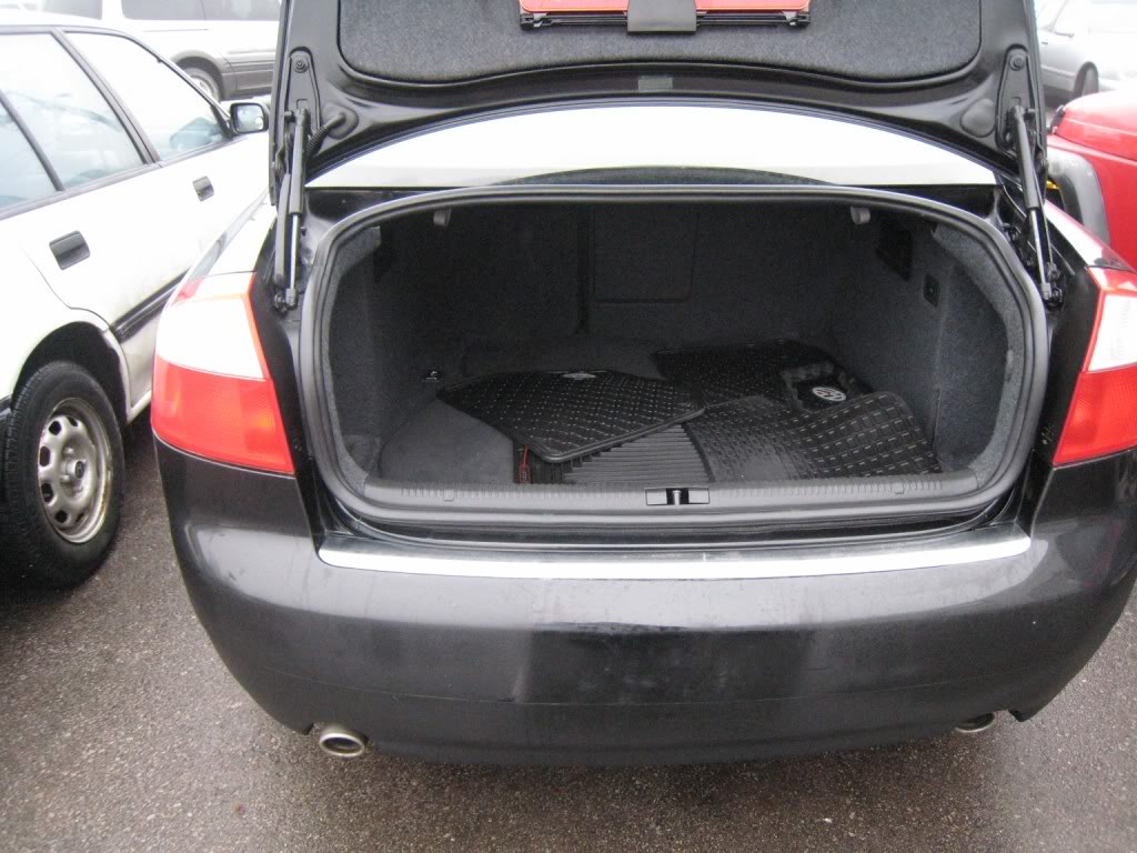

Here is some pictures - if you look close the you can see the slight impact at on the rear in the first to pictures..these were taken after he purchased the car right after the accident.
Right after the accident:
Different view:
Repaired:
if the dealer says it looks good I'm going to purchase - great price - about 5K less then other 05's with the same mileage.

Looking at the pictures it appears as if the body work came out pretty well. The exhaust looks a little bent on the right side tho. I work at an auto body shop and we see major rear end damage all the time. If the estimate approached 13k there had to be some sort of unibody damage to the floor plan, rear rails, rear body, quarter panels etc.
Since it is a unibody car (does not have an actual frame) it is designed to crumple and absorb impact. I would ask them to remove the carpeting in the trunk so you can see what actually got repaired. Make sure the trunk lid, tail lights and bumper all line up properly. If a gap is larger on one side that means the unibody is not aligned properly.
If the dealership had it repaired for only 2500 that most likely means one of two things. They pulled and straightened things that were originally suppose to be replaced or they got a rear clip from a junkyard and sectioned in what needed to be replaced. Being very familiar with collision repair either is a cost effective way to repair a heavily damaged vehicle. If done correctly, the overall quality of the repair and the integrity of the vehicle structure can be nearly as good as new.
You definitely want to check for is any water leaks in the trunk. When there is heavy damage to the rear of a car, sometimes, seams along adjoining panels split and can let water in. I'd also ask if an alignment has been done. If so ask for a print out that displays initial and final readings.
If all these things check out, and the dealer has a good reputation, I would not hesitate to buy the car.

Assuming the unibody was damaged, the overall impact on the car and the effects on its driving characteristics really depends on how hard the car was hit. The best way to fix a car with unibody damage is to cut out the entire panel that is damaged and weld in a new panel. But since the car was only fixed for $2500 the odds of this being done are very slim. Everything was most likely pulled on a frame machine and straightened.
Once metal is bent, and then bent back the opposite way to straighten it out, it is weakened and stretched. The severity of how bent the metal is determines how weak it becomes. However, the rear end of a car is not the most structurally important part of the vehicle. Most of the rigidity of the structure comes from the rear seat crossmember forward and rarely does damage extend that far forward. If the car was hit in the front or t-boned I would be much more concerned.
Under normal driving conditions there is probably absolutely no noticeable differences in the way the car drives. Under extreme driving the body structure may be slightly more prone to flexing but again, would probably go unnoticed.
A slight difference in the trunk gap is fine as long as the trunk shuts properly and has no leaks. It could maybe be fixed with a small adjustment too. Hope this helps

I took the car to the Audi dealer and the service manager came out to have a look.....first thing he noticed was all the body work at the rear panels - then he opened the truck and looked at the floor panels where the spare tire is kept...he said "run - don't walk away!"
To much damage - he pointed out the metal wrinkling which I never noticed before.
He said the car was hit hard which is why it was not repaired by the insurance company.
