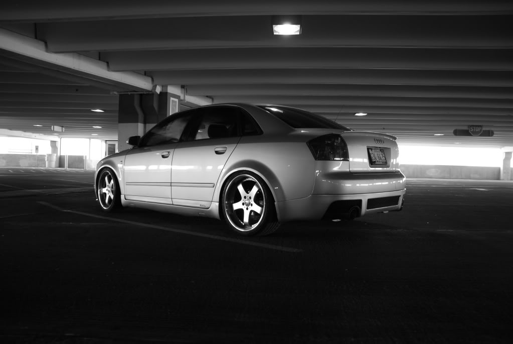

love that rear plate. how deep is the dish on those rims? looks great.

2.5 in the rear

What rear spoiler do you have?

votex i believe

wheel specs, sizes/widths, offsets and tire sizes?? any rubbing?
Also, suspension mods?? Thank you!

Monet Gothics
Front 19x8.5 235/35/19 with a 1.5" lip and rear is 19x9.5 265/30/19 with a 2.5"
Front ET 32 and rear is 37 i believe
suspension: NS race + Koni Yellows
rubbing: I WAS pretty bad as soon as i put them on... my left rear fender got burnt because of it... i dunno how, but the camber on the left side was -0.8, so i had to make it -1.8... then it still was rubbing on the right side on every uneven pavement....
so me and my buddy made it even more negative and pulled rear fenders (quarter panels) with a screw driver a bit... Now im fine with 3 people in a car
