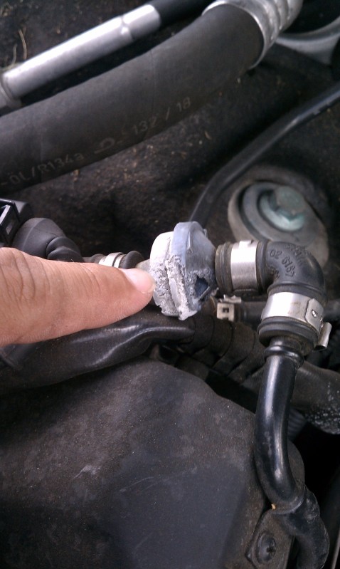

also noticed after taking out the MAF that there is a valve?(white and gray) on top of the air box that has a hole melted in it. no clue what its for but sure its part of my problem. can someone help me identify it so i can replace it?

That is a bypass valve, mine was in worst shape(holes in it) just caused a vacuum leak, car drove fine though. Dont think thats ur problem.

Dealer said that was causing a code to come up for the brake booster, $150 replaced at Audi dealer for 5min job lol
