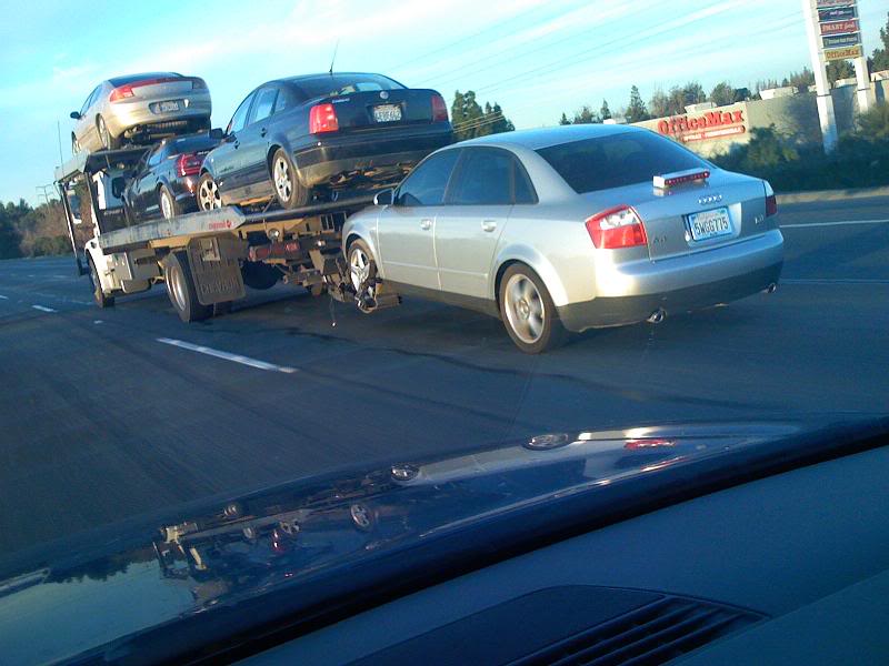

If your car w/ quattro is towed behind a truck, it will f*ck up your quattro. Don't ever try this at home:
By the way, the A4 in the picture has quattro!

On a wheel lift, yeah it will **** it up, but if you are just pulling at behind something with all 4 wheels spinning @the same rate it shouldnt **** it up should it? only the front/back spinning at a different rate should cause any damage if im not mistaken... quattro is pretty robust though compared to the counterparts.
wow. that genius driving the truck should pay for the damage.
