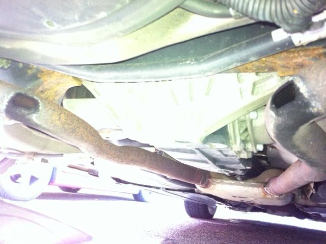

Appears the previous owner cut two rectangles into the bend of my exhaust for god knows why.

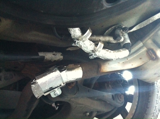

Photo is kind of crappy but the heat from one of the holes blowing onto this hose caused it to melt open. This hose goes directly into the EVAP cannister.

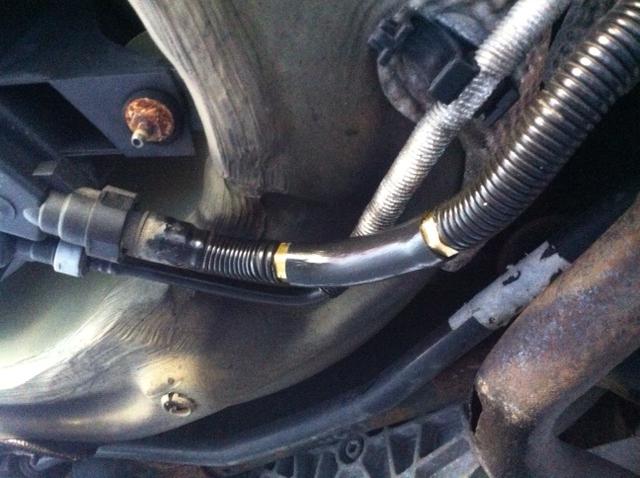

To fix it, I cut the old piece out and attached a rubber hose in place held on with copper fittings.

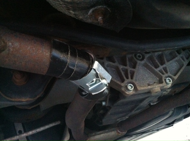

I then wrapped some exhuast wrap (seems like tinfoil) around it and secured it with clamps.

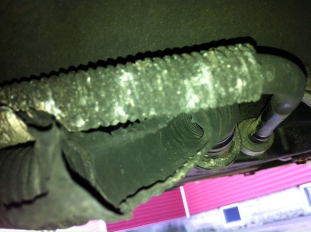

And as you can see here and in the last picture I covered the holes with some exhaust wraps and clamps.

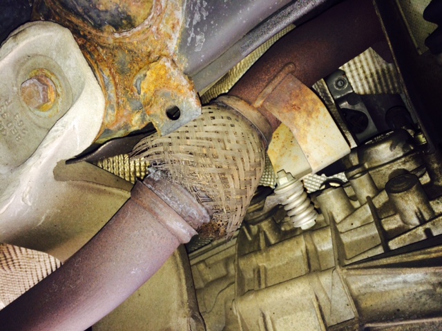

Too add to my troubles I also discovered this. Not sure if this is causing a leak or not, hopefully someone can help me identify what it does (I'm not a noob I swear! Just not familiar with the exhaust pieces)
Finally after all is said and done, I cleared the CEL twice and it keeps coming back. Also checked the gas cap gasket and most of the EVAP lines. Is it time to just replace my exhaust? Will these holes throw codes if they're not tightly sealed? Thanks so much guys, been coming here for a while for a wealth of information!

Sorry I can't be of any help with the codes, but the last picture is your flex pipe. If it's not leaking already, it will eventually.

I see the compromised and cleverly repaired Evaporative hose. I was just looking at this on my B6, but for a different reason. I've got fueling woes (as I posted just last night) and was looking that the same system for being a culprit. Not sure just yet. . .
