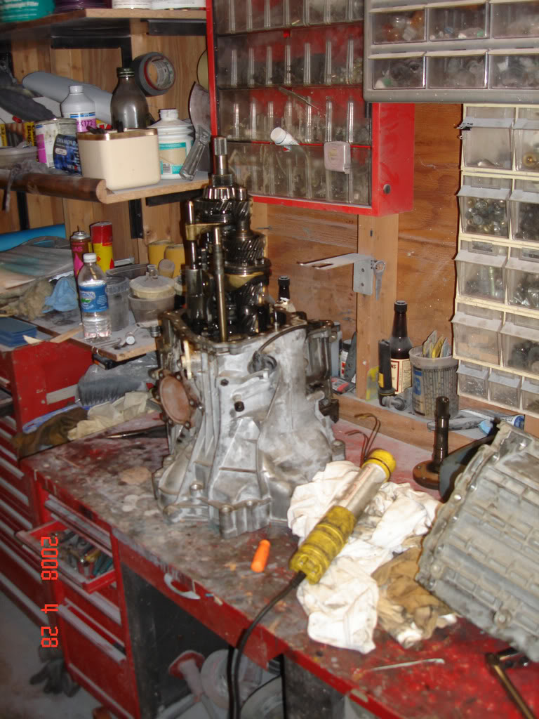

Well I took it apart and on the 1st gear a tooth was chipped off and the small piece ran through the gear causing more damage to the rest of the first gear. Even w/ a discount I would probably have to drop 1k.

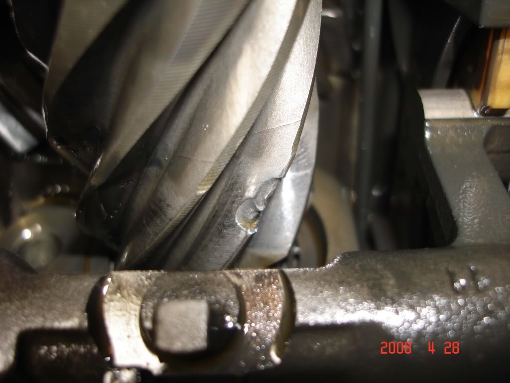

Here is a pic of the chip,Name:  DSC00824.jpg

The reason the part alone costs so much is because the shaft is connected to the gear and it's all one piece

Great job Cbass, thats a big help to us guys with this same problem to actually see the damaged part.Any chance you could post a step by step procedure of this repair for some of us that may want to tackle this ourselves (or have a buddy with some mechanical knowledge tackle it).

thanks for the pic. such a small chip but it makes such a loud clicking sound. i guess changing the oil wouldnt make a difference. maybe i will just wait for my clutch to go and will fix the trans and the clutch in one go to save on labor.

Slightly old thread, but I'm dealing with the same noise on used transmission I bought and just installed. The picture posted does not show up anymore. Can that pic be reposted? The original tranny didn't have this problem so I plan on taking 1st gear from it and putting it in this new tranny. Cbass - how did this story end?
