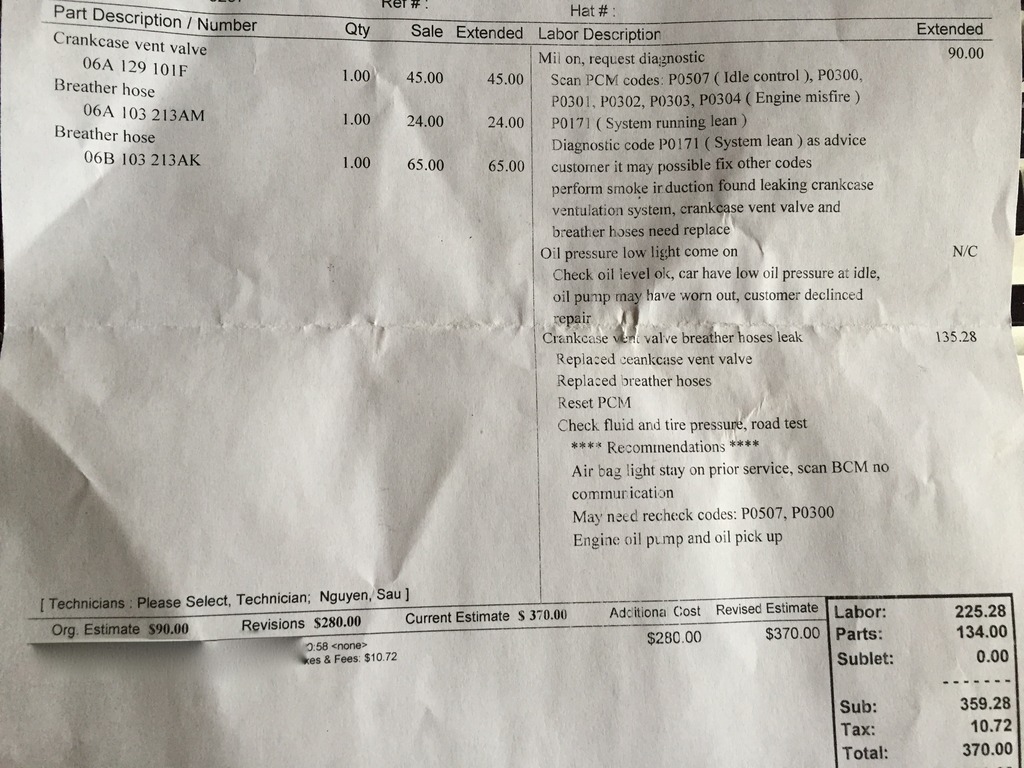

-Year Later I had a check engine light (P0507) for a week come on which lead to a blinking check engine light and my oil pressure light coming one as well not being due for an oil change.
-$370 later the crankcase vent valve and breather hoses were replaced. This fixed the check engine light and the other codes.
There I was told the Oil pump MAY have worn out and that was causing the oil pressure problem and priced at $750 to fix.

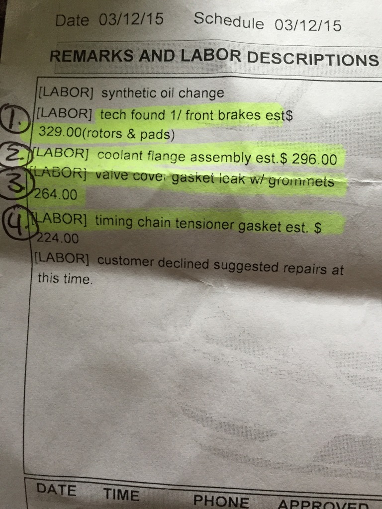

-I went to another local spot a 1/4 mile away from my house to get an oil change just to see if anything might change. There they didnt mention the Oil Pump instead:
1. Coolant Flange assembly $296
2. Valve Cover Gasketleak w/ Grommets $264
3. Timing Chain Tensioner gasket $224
