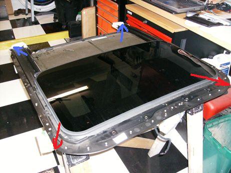

The drains on the sunroof are located at the 4 corners of the tracks. The blue arrows are the rear drains and the red ones are the front drains. You can only visually check the front ones per the new maintenance info.
