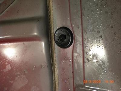

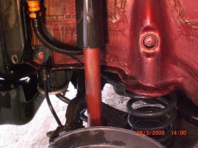

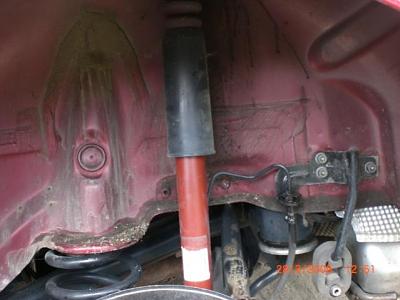

Hi
For the rear drains you have to remove the rear wheel and iner cover, usually is enough to squeeze the ruber of end drain because all dirty is blocked on the end. there is pictures of ruber end of rear drain on my A4 avant 2004 b6.
