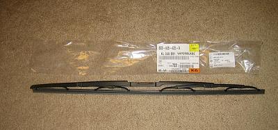

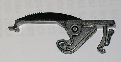

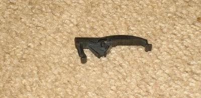

I recently went to Walmart to look for winshield wipers for my 2002 A4 3.0L. The wiper blade catalog indicated I should purchase RAIN-X 21" blades. When I attempted to install them, I found that the Audi OE blades have a clip that must be depressed to unlock the blade from the arm. I am probably not the first person to do this, but I snapped a piece off that keeps the blade attached. If you look a the picture of the clip below, you will see that the clip is missing part of the plastic hook in the middle. I tried AutoZone and a few other local parts stores and they all said their database tells them the part is only available OE (aka from the dealer). I went today to the Audi dealer and picked up 2 new blades, and a new clip. Blades were priced at 26$ each and the clip was 2$ (US). The first picture is of the blade itself. I believe some Audis are equipped with a different style blade but this one is the most common. The last picture is a picture of the blade along with the parts information in case any one has a similar problem and needs to call ahead to the dealership. I hope this clears up some questions that might be out there. The part information is as follows:
Wiper Blade: 8E0-955-425-A
Clip: 8E0-955-247

Know these are hard to get but seen these in ebay attached picture
http://cgi.ebay.co.uk/ws/eBayISAPI.dll?ViewItem&item=190823426685
