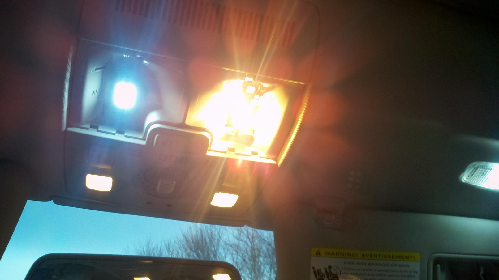

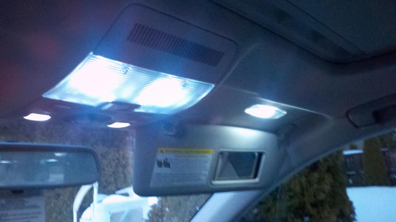

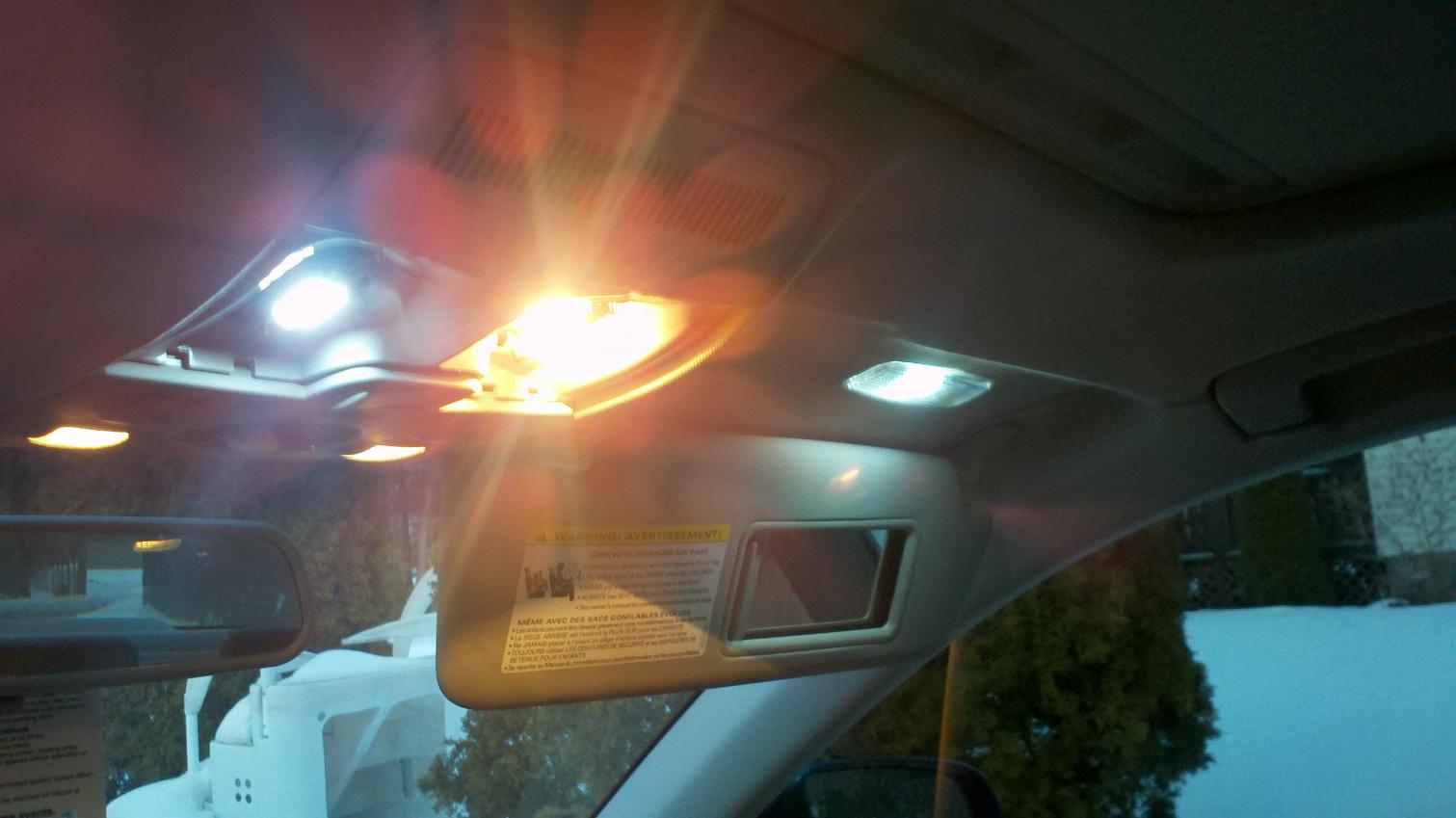

here are some pics for anyone interested. cell phone quality but you can see the color difference. the yellow may seem brighter at first but the leds are definitely brighter at night and fill the cabin with light
waiting for weather to warm up to add the resistor to the plate light but ill update when i do that
