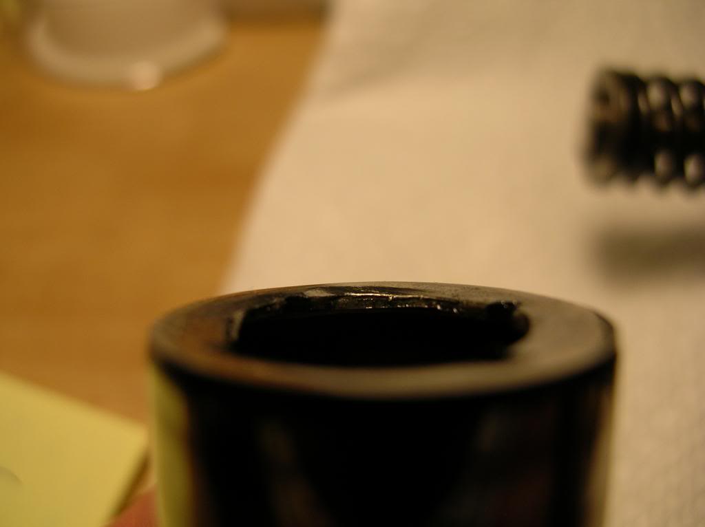

Hi all,
I recently bought an 06 A4 2.0T. After reading plenty of info online that the cam follower could be an issue, I purchased one, got the tools I needed, and pulled it out. Unfortunately, the follower already has a hole in it! The follower didn't just wear through, by the way the hole is torn I can tell there must be pieces that went into the engine somewhere (probably the cam chain cover from what I understand?).
The follower:

View showing broken edge:

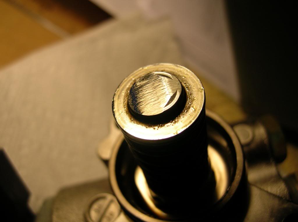

Fuel pump piston:
Cam:
My understanding is that Audi will replace the follower, pump, and cam up to 120K miles, and I have 100K (the VIN is within those specified on copies of the letter I have seen posted: https://www.audiforums.com/forum/b7-...letter-168717/).
However, will they frown upon the fact I opened it up in the first place? If I hadn't, there would be no way to tell there was damage since there were no symptoms, engine lights, etc. Waiting until something happens seems like a terrible idea!
Should I call the dealership, tell them I looked at it and it's broken and ask them to fix it? Or put it back together, ask them to check it out so they find it? That just seems suspicious from my point of view. I also want to guarantee they will tear apart whatever it takes to find any pieces floating around. I have heard some dealerships have been reluctant to do this. I live in NH if it helps.
Has anyone had first hand experience doing this?
Thanks!
