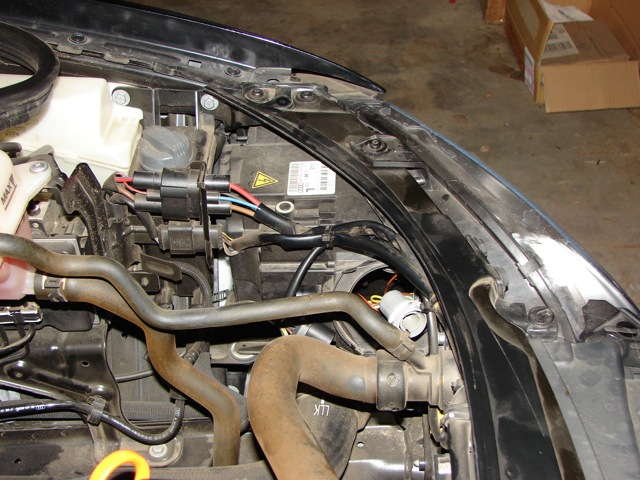

First, an overview shot from later on in the process to set up the location. The DRLs are the inner bulb in the bi-xenon headlights.

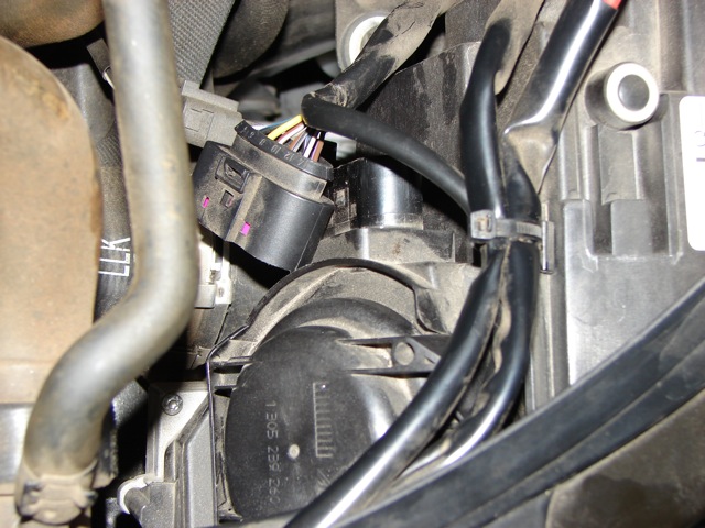

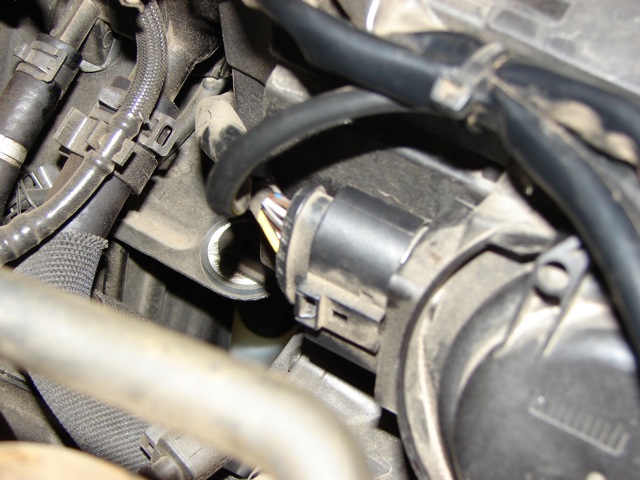

First, take off the wiring harness. Press the tab with a flat-head screwdriver to release it, and pull the harness off.

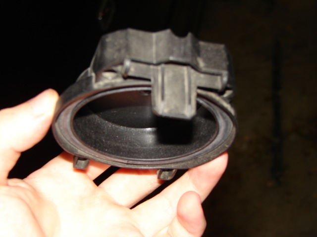

Next, take this cap off. Just press down on the top tab, as shown in the second picture below.

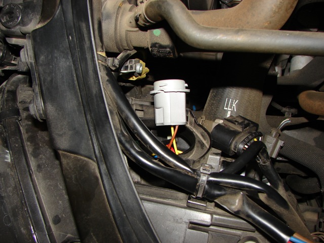

Then reach in and twist the white bulb holder counterclockwise a bit, and it will come out.

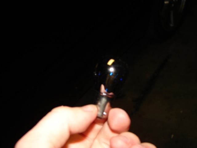

Here's what the new bulb looks like.
Put it into the bulb holder (without touching the glass... I used a cotton cloth), reinsert the holder, and twist clockwise to lock. Here's what it looks like installed.

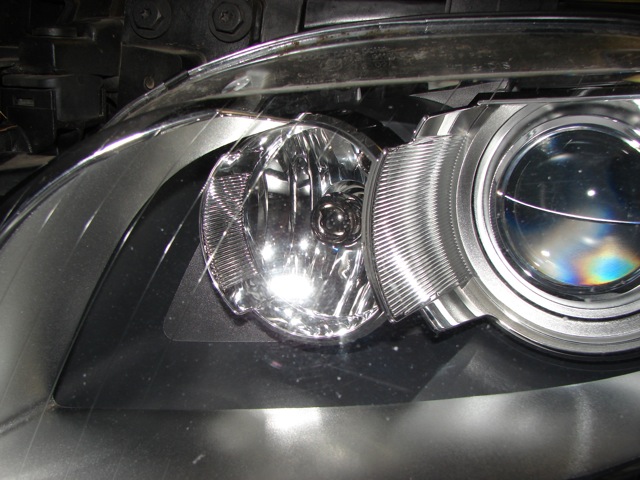

The stock DRL is much brighter... but also much yellower. And... I need to get some Scratch X on there.
Comparison shot.
In summary, this is pretty easy, costs less than $20, and looks a lot better! On the passenger side you'll have to take of the intake snorkel to access the bulb, but that's also trivial. These bulbs look pretty sweet, but unfortunately they aren't very bright... I'll probably replace them with LEDs at some point.
Comparison shot.
Bringing a thread back from the dead here, but just did this also, and like it. However, what is the little halogen in the DRL "compartment" and why does that come on, and the DRL go off, when the headlights are turned on? Thanks.
AH, those are the city lights I've read about. Hm I've always thought of parking lights as the amber turn signals. Crazy Germans ha (I can say that because I'm Germish!). Is there a way to disable those? The tiny halogens look a bit awkward when the beautiful xenons are on, IMO.

I think for the city lights, you'd have to remove the bulbs, and then put a resistor across so you don't get a bulb out warning. I'm with you that they look retarded, though.
