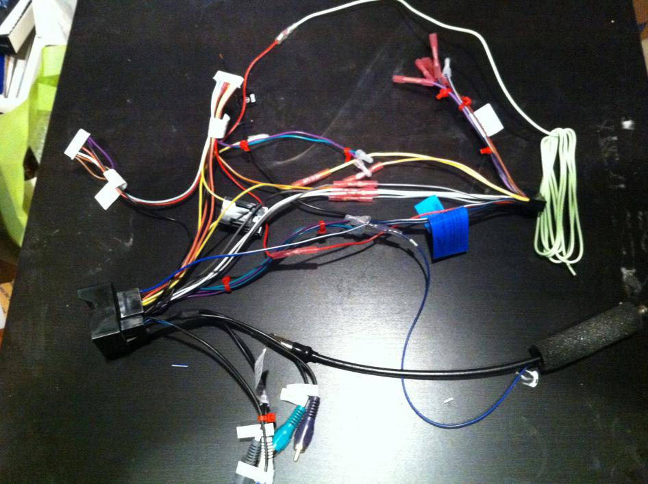

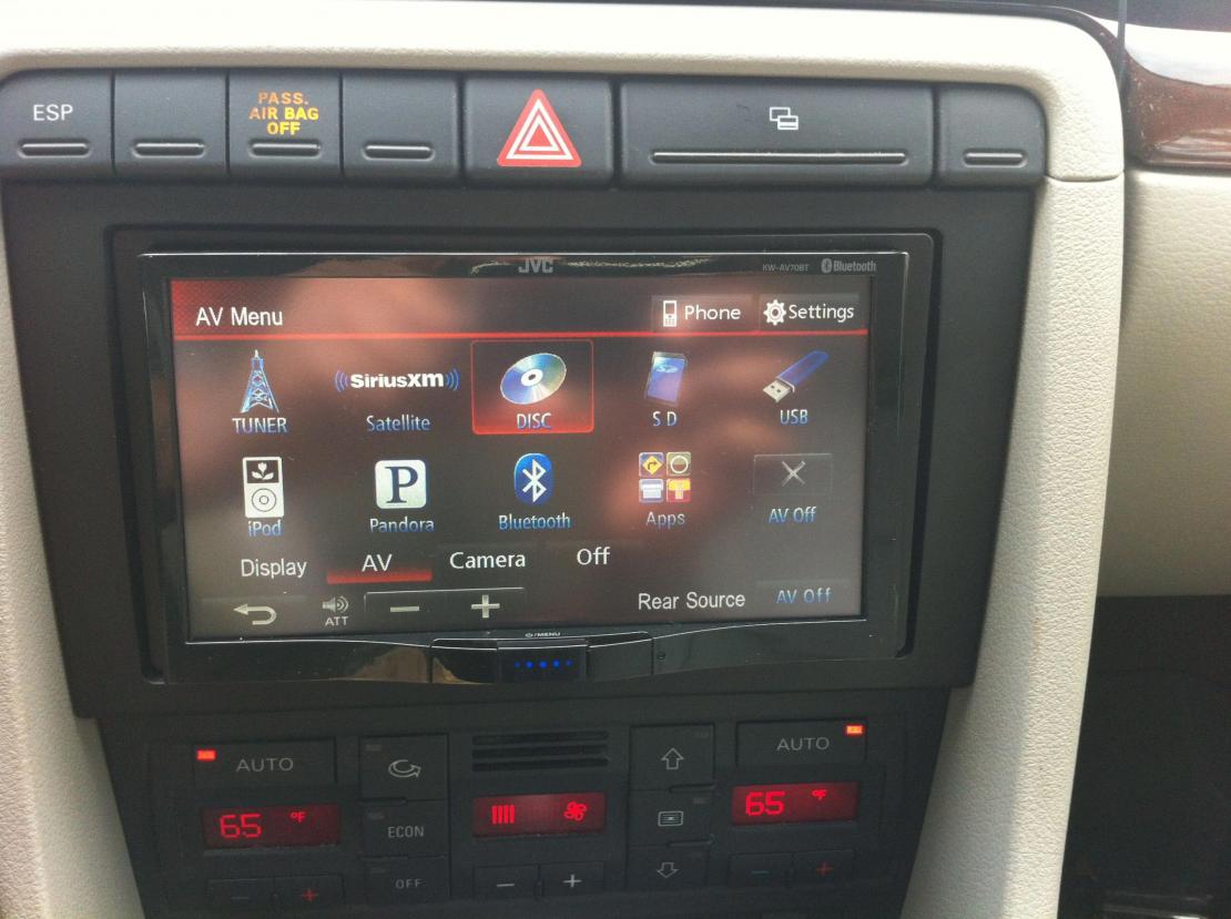

Ok so it took me a while to do this. I finally go around to purchasing a new head unit. I went with the JVC KW-AV70BT. PAC CR2-Audi harness(see pick). Also adding the XM tuner.
So far I have finish the harness connection. This harness is a mess. The instructions that they send are kinda of useless. So I am hoping that it done correctly. If you see anything in the photo that doesn't look correct. Please let me know. I will connect the PB wire once in the car. I will upload additional photos as I move a long.

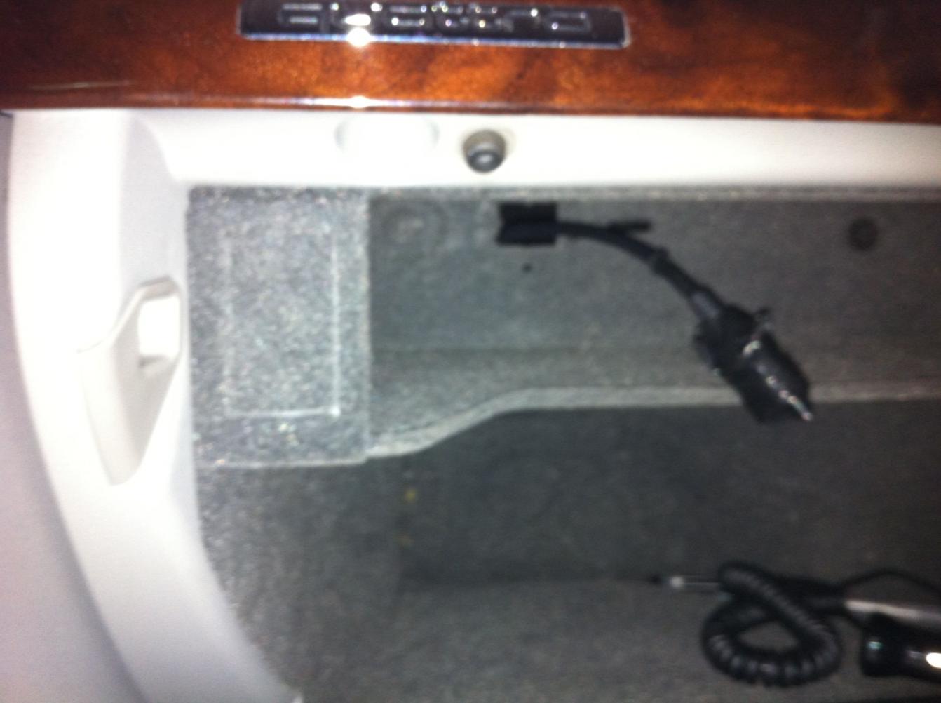

Ok so I had to switch to the other harness. Learned a hard lesson. Anyway, once I had that taken care off. I ran a long ground wire to the fuse area. I took a wire to feed the USB cable in to the glove box. So here is a note. If you have a B7-non Bose and thinking about use a PAC cam bus. Use the one with the RED connector. I their pictures is the hardness on the left. Other wise, if anyone has any question feel free to ask.

Ok so after listening a few days. I notice that there was a lack of Bass. If I faded to the rear. I only get sound from the right rear. and that is kind of muffled. So I thought perhaps one of the RCA's wasn't connected. So I ripped out the metro case. ( replaced it of course). The RCA's weren't the issue. I have the blue from PAC connected to the Blue and the antenna connected from the JVC harness. If anyone has any suggestion please send them on.
