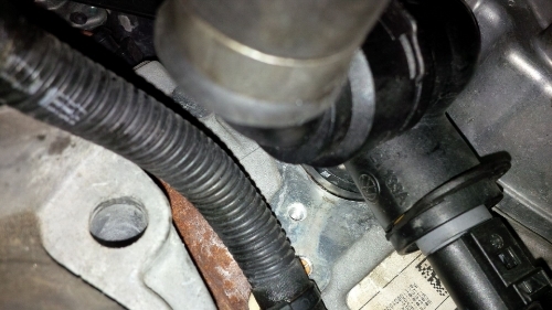

Tell them to check the coolant flange. It's on the backside of engine and protrudes facing the firewall. It junctions the two rubber pipes to the heater core. It's not visible unless you go back there with a camera. Evidence of a leak can be as severe as a pink/white crusty buildup to a barely visible dry drip residue. You need to take a camera to the rear of the engine going in from the left side. It'll take several attempts to get a good picture with flash. I'll post a picture later today when I have a chance. They're in for a treat if they've never changed one before, but there's several ways to do it.
Here's a visual of what the B7 coolant flange from the internet. The leak can be as little as this and still cause noticeable coolant loss....
Or as messy as this...
Don't burn yourself on the catalytic converter trying to take pictures or a video like the above please.
Audi dealerships will charge you for the removal of the entire engine to get to the flange, but they really don't, they lie and will charge you up to $800 for it to be removed. A good DIYer won't have to move much out of the way. Some may take off the vacuum pump, but that isn't even necessary. Independent euro shops will charge you about $300 if they even know how to do it...seriously.
As I stated before, this is the season for flange leaks because of the weather change. The reason it's so difficult to track down is because the leaking occurs when the engine is cooling down due to hot to cold expansion and contraction of materials.
This is my best deduction on your coolant loss since it's most prevalent as a "hard to find B7 A4 coolant leak" and no other symptoms you mentioned.
Make sure they use the proper mixture of G13 coolant...there's a reason. High maintenance these cars are. Don't be afraid to show this thread to the Honda dealership if they're gonna work on it. Good luck
Here's a good forum thread on the process for all you who want to learn about doing this yourself. DIY B7 Coolant Flange Replacement with Pics
If you own a B7 it's a matter of when, not if this is happening.
