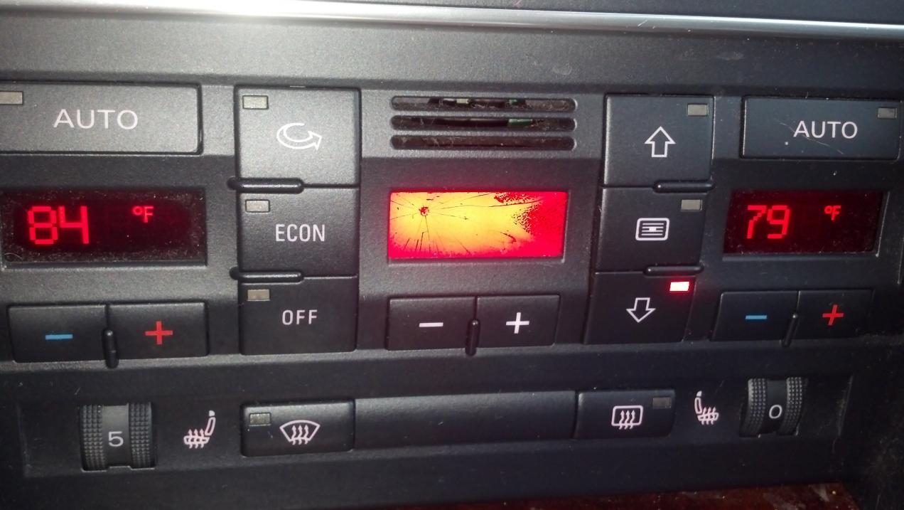

Great! The Sunroof is now working just as it should. Opens and closes without issue! Thanks! On to the next small issue. The middle LCD screen is cracked where my AC controls are. How hard is it to change this out? Can I just get a replacement LCD or do I have to swap the whole unit?
Thanks guys!
Ron

I am guessing that screen is part of that whole unit. Might be able to find that whole unit on ebay or at a parts yard. If I remember correctly it shows the fan speed.
