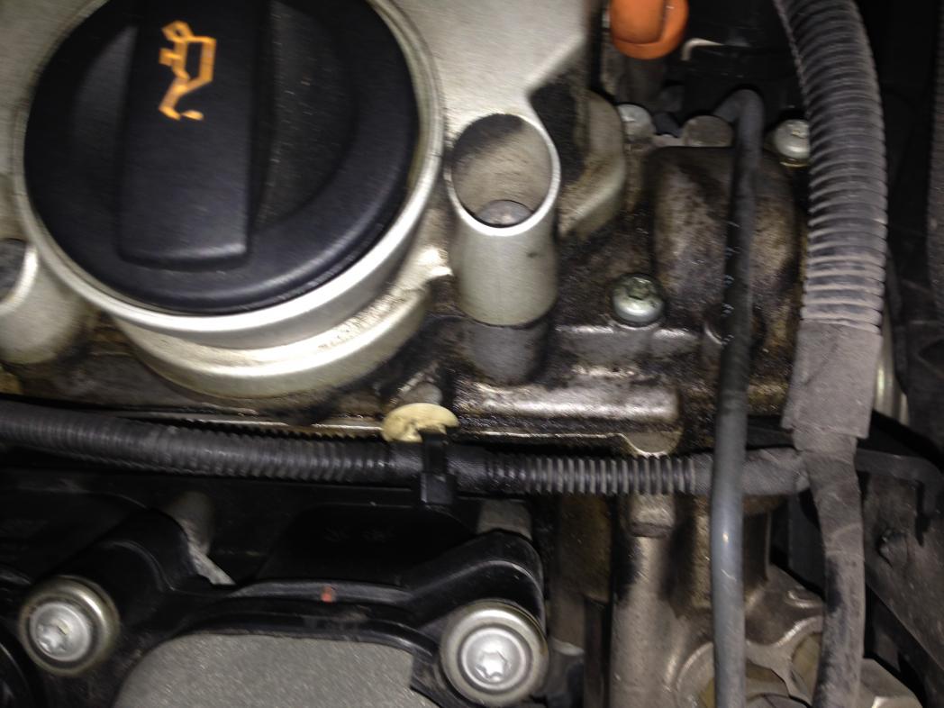

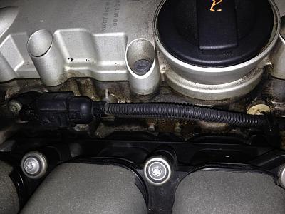

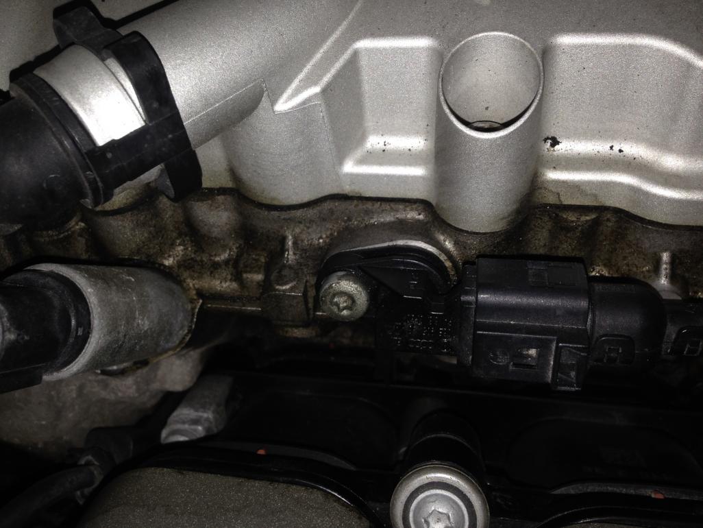

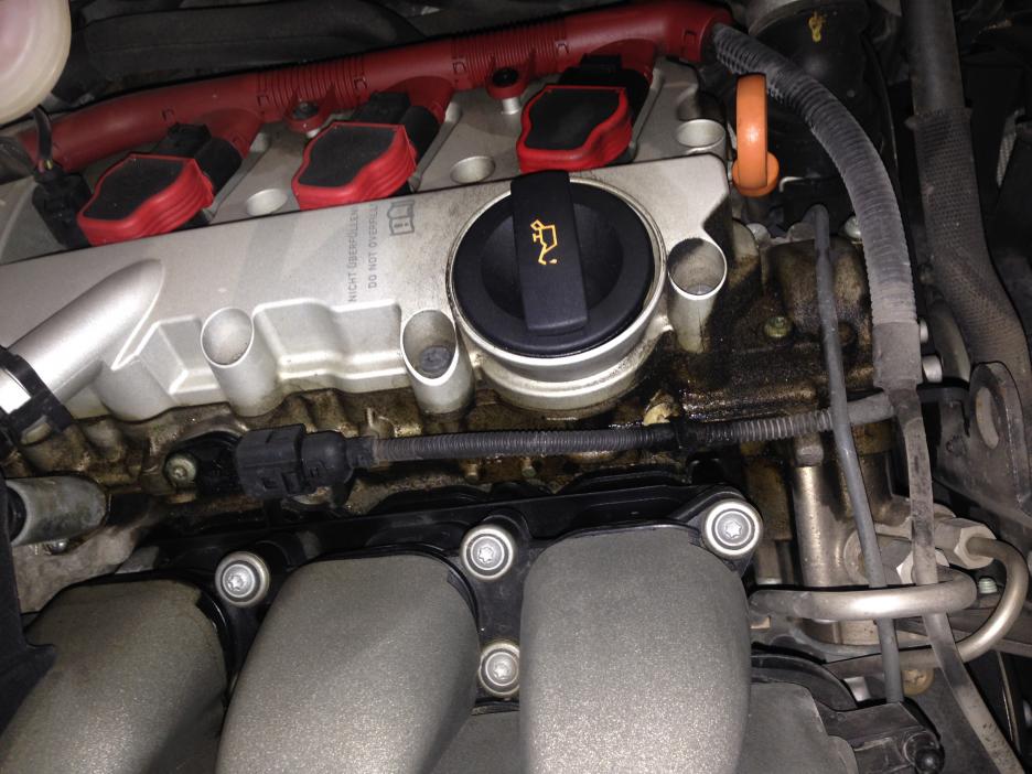

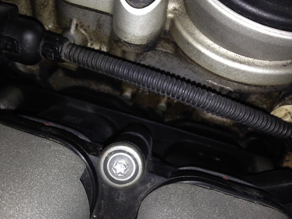

So my wife just got an 05 Audi A4 3.2 from a friend two weeks ago and I only just got a chance to go under the hood and see if everything looks good, and I saw oil around the heads on the driver side. It did look old although there were a couple spots that looked fresh. I am far from a mechanic and I have never owned an Audi (I'm a Mustang owner) but to me it looks like a head gasket leak. Can anyone here give me a little help and let me know what I am up against. I would appreciate the help. Thanks.

from my little experience, it doesnt look that bad. looks pretty clean considering its an '05. that seems like normal dirt and grime build up. if youre worried about a head gasket, i would look for more oil (pools in low spots), oil spraying when running, smoking, or possibly coolant leaking/spraying or extreme oil/coolant consumption.
At first glance it looked worse to me, but I have been messing around in there today and I think it's possible that someone spilled oil in there, or something along those lines because it does look a bit older. My wife checked the oil when she first got it and said it was good and I checked it today and it was at the same level, so it doesn't seem that it is burning any oil.
I was really concerned because the other side is SPOTLESS! Yet that's the only part of under the hood that is. I opened up the air filter and there was leaves and sand inside there. Makes me want to punch my wife's friend who sold her the car. I was not around for the transaction, wish I was. After I put it back together I promptly threw a CEL, but I believe I didn't get the clamp back on perfectly cause I was having trouble with it. Nothing seems easy with this car so far.

Have to agree with imaudi5000,the oil looks like a little spillage from pouring,
seeing as the cap is right there.Keep as eye on it the next couple hundred miles for any new seepage.If anything,it looks like a valve cover gasket thou.

Neal4007, thanks for the information. I am pretty sure it is spillage, but I bought some degreaser to clean the area and keep an eye on it.
