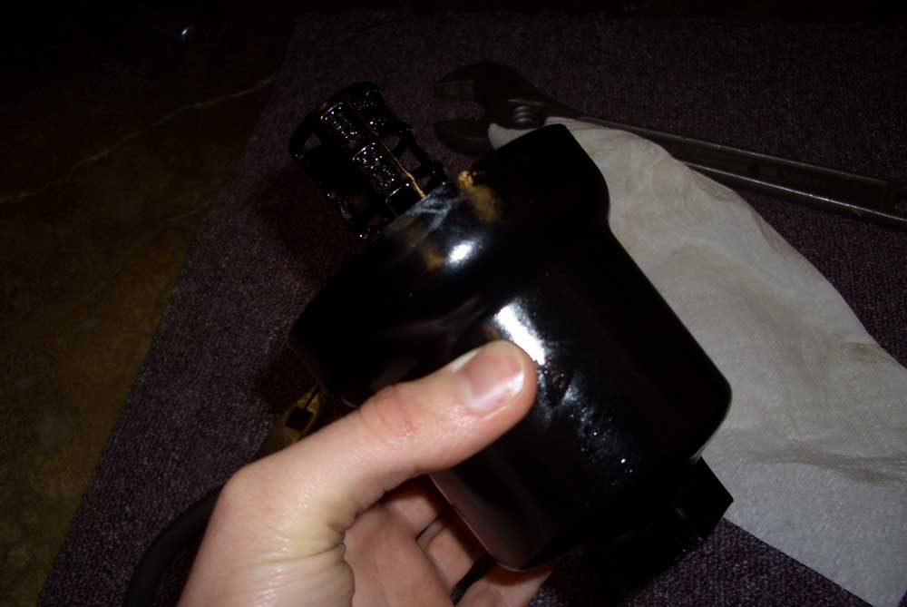

I am trying to change the oil on my sister's 2005.5 A4 2.0T. I have read the 2.0T oil change guide, but I still can not get the filter off.
I have this filter and the exact same wrench you see in the background. All I am doing is damaging the plastic nut on the end of the filter. What size is that nut? I might just buy a socket. Why would you make such a thing out of plastic?

In an attempt to get leverage I managed to brake off the coolant connection to the overflow tank.
Please tell me how to get this stupid filter off before I destroy the car. I also need to know what the part I broke is called, and where to get it.

I use a band style filter wrench on mine. I've never had a problem using that method. The fliter housing shouldn't be very tight. Perhaps the last guy over did it, or buggered the threads. I can tell you it can be more difficult to remove when the oil is cold.
Try this. Mine is a 2006 2.0T, and it has a drain at the bottom that is accessed by removing a screw-on cover. Take the cover off and use the handle end of a medium sized screw driver to push up on the metal fitting you will see inside of the drain housing. This proceedure will release any vacuum that might be in the filter housing. CAREFUL, oil will come out when you do this.

I believe it is a 35MM socket. Because I have a lift in my garage it isn't to big of a problem to remove. It's just a pain to remove the plastic under tray and then drain the filter housing. But after that all I do is use the socket on a 10" extension and ratchet . Comes right off and I just make sure I use a torque wrench when I put it back together. Oh and yes it is a poor design. It's thanks to the eco-nuts who made the change from a spin on to a cartridge type filter.

With the coolant system back in place I let the car idle until it was warm. The screwdriver didn't work that well for me on releasing the oil valve in the bottom of the filter. I used a wrench and there she blew. The only 35MM socket I could find was for an axle nut. The socket was too long to fit in the space available over the nut. The belt oil filter wrench worked like a dream.
