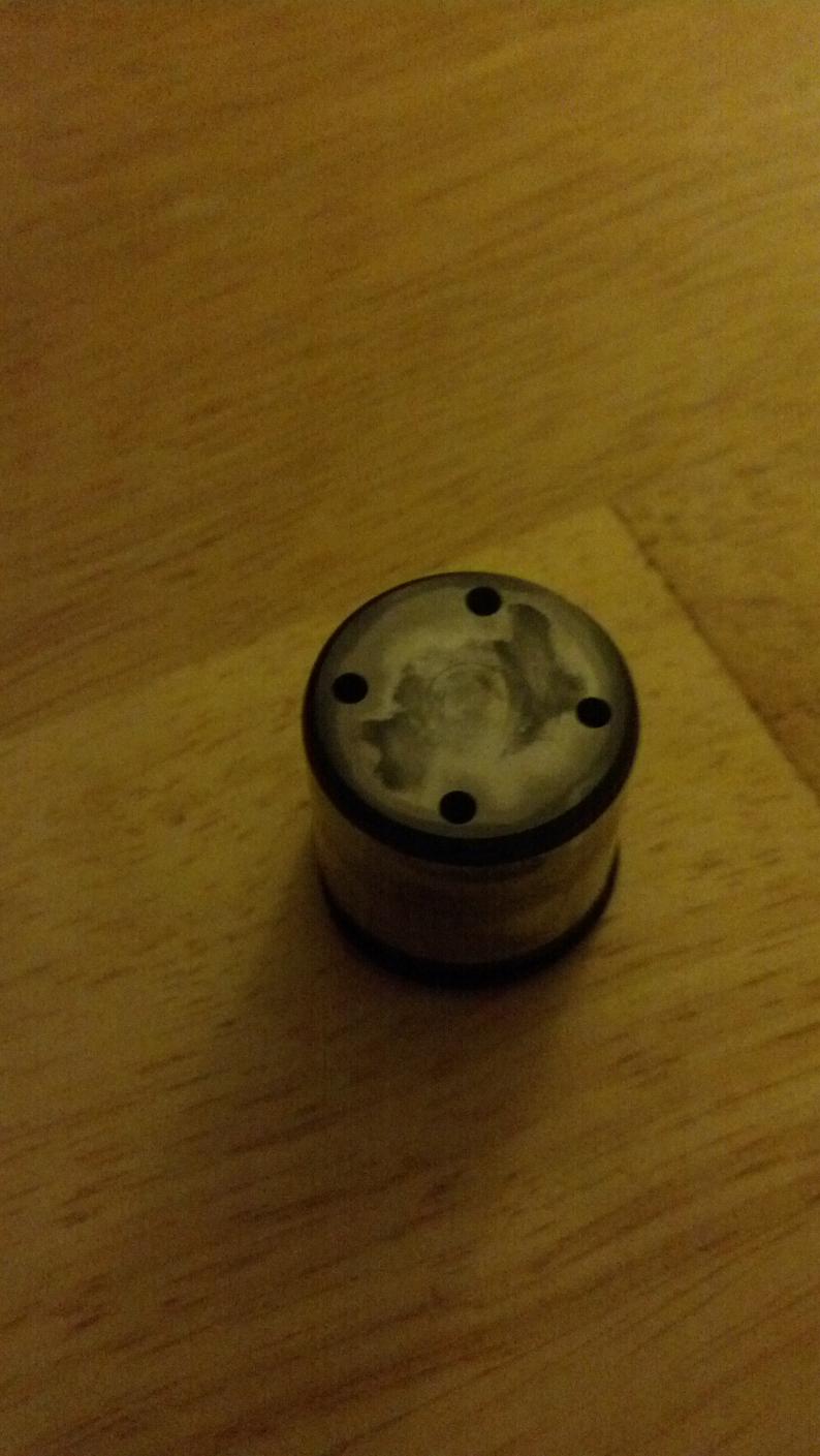

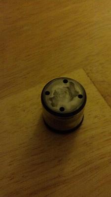

I tried changing my cam follower yesterday only to realize the 12pt M8 I had did not work in the banjo bolt (came in a cheap set) so I had to close it all up and redo it today. The swap went successful and the follower that was in there didn't appear to me to be in too bad of shape but did show wear so it was good peace of mind, I will try and post a picture later. I use a new o-ring and bolts from ECS as well for the hpfp.
I did drop the bit after torqueing the banjo bolt back in place, and it was a SCARY feeling. But I was able to successfully find and remove it from where it landed with a pen magnet. All in all, for anyone contemplating on doing this at home it's not very hard but it is not a job you can not rush through. Take your time and don't drop bolts/bits! Also, definiately take the time to wrap a rag around the fuel lines before taking them off of the hpfp, I'm glad I did because there was a decent amount that came out and I was able to just throw it outside so I did not have to smell the fuel.

Here's some photos of my old one
Attached Thumbnails Replacing Cam Follower...What else?-img_20140308_182843_626.jpg   Replacing Cam Follower...What else?-img_20140308_182915_239.jpg

Wow lucky! I checked my cam follower last week and it was done! Whole right through that bish. So now im just waiting For the motor to blow up so audi can replace it under warranty because its not throwing any lights right now. While trying to put the banjo bolt on I also dropped it and I thought it fell inside the bell housing haha I was Trying to find it for an hour. It fell in a weird spot but I was able to retrieve it. Definitely a scary feeling
