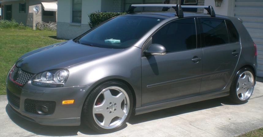

You can go many ways with tires. They can hang over or stretch back as long as they don't rub you are fine. I run 225/40/18 in the front of my GTI on 8.5 inch wheels. I run 235/40/18 on the rear on a 9.5 in wide wheel. Looks wide and fat in the rear but FWD can get away with mismatched tires.
If you are AWD you need to be careful to keep your tires at the same height to keep from screwing up your AWD system. Here are 2 good size links.

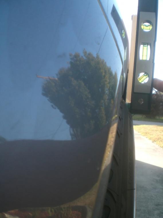

Stretch was a matter of preference for me. To fit the 9.5 inch wide AMG wheels on the rear of my GTI and give it that slightly staggered look the rear tire had to strech in slightly to clear the inside fitment and sinch the tire was about level with the fender, the outside stretch pulls it in for suspention travel and does not hit the fender. Plus my GTI is lowered. It looks Good. Not Gay. Keep in mind the tire alone is before lowering but you can see how clearance on wide wheels would be a problem. The whole car shot is lowered.
Attached Thumbnails Tire Size Question-small.jpg   Tire Size Question-smaller.jpg
