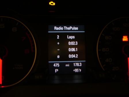

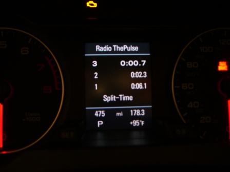

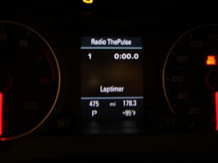

Funny you should ask... I just found an option for a Lap Timer, so I figured what the hell, see what it does. I turned it on and I now have a lap timer in my instrument cluster. I don't know what I could use it for since I won't be taking my car to the track, but it's pretty cool anyway. The first picture below shows the lap timer screen when you scroll through the different mileage and mph screens. The second picture shows two laps recorded and the third screen shows the calculated average of those two. There's gotta be another use for this... I just can't think of it now.
