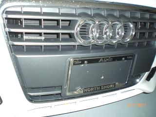

Default License plate holder removal and install
I took off the license plate holder panel from the 2010 Audi A4. It is held on with only 3 star-head screws. one on the bottom of each side and one right in the center behind where the center of the license plate goes.
See the pictures, one picture with it installed, one with it taken off, and one with the panel on the floor removed.
How does the filler panel attach? Anyone have pictures of the filler panel? Does it attach with the same 3 screws or differently?

It goes on exactly like the other one came off but doesn't use the center screw.
