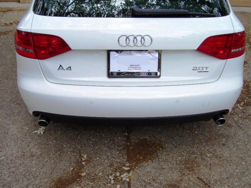

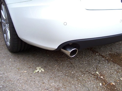

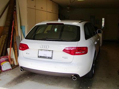

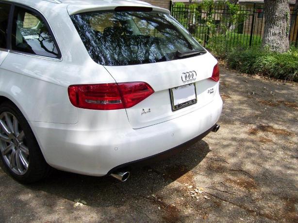

My build date was 03/09, so the car had the larger tips (~3.5 inches). I didn't want to put 4 or 4.5 inch tips over those, so I had my tips cut off and installed clamp-on tips. I got them cut off at Midas for $20 and the stainless steel tips at PEP boys for $15 each. They're angle cut with a rolled lip.
