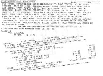

if possible could you give a little more detail to the problem? i brought the car in today and told them, they said they had looked around the breaks, but if i can get this fixed faster it would be a lot better.

hey cbrandt, life was just too busy to reply any sooner. I attached the portion of my work order where the issue was described although the tech didn't explicitly note which mechanism he had to adjust.
Hope your dealer can get something from it. All I can tell you is that the service advisor said the tech explained that there was some adjustment in the brake mechanism that was some sort of standard part that you might adjust when changing brakes.
Also keep in mind that not all dealer service shops are the same. Some are more capable than others. I would try another dealer. I got run-arounds from other dealers about the oil consumption problem and then found a dealer who was finally interested in addressing the problem.
Good luck.
