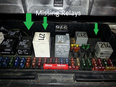

My issue: I have a 1993 Audi 90 (non quattro) v6 5sp which I recently acquired. The car overheats due to the fans not turning on. At first I was loosing coolant because the reservoir was cracked, I replaced that and found that the car was still overheating and noticed the fans do not come on. Also, the heater core is bypassed (in case that matters for anything). So far I have checked: the fans- when connected directly to power they run just fine; the relays for the fans that are present have been tested and are functional. (though there are some suspicious spaces in the relay panel where I am not sure if there are supposed to be relays there.); the temp switch in the radiator was tested and is working as well. I thought about trying to bleed air out of the system but don't know where. I let it run with the reservoir cap off for a while, but I don't know if that will bleed the air or not. I have run out of things to check.

First: there are several missing relays in the relay box. Some of them (according to the pretty picture on the top of the box) are supposed to have something to do with the cooling fans, but I can't find documents/schematics that call out what those relays are and if they are actually necessary in this vehicle.

I uploaded photos of these as attachments (i hope... not sure if they made it)

First photo, you should have a fuse and relay guide on the fuse box cover. Thats how it is on my '91 90. You should be able to determine whether or not the missing fuses and replays apply to your model. I.E. options, diesel, etc.
