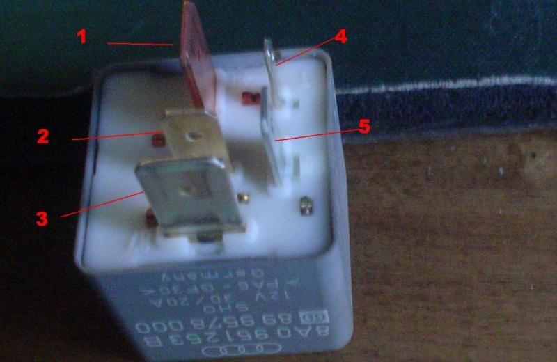

So I have a 1995 90 quattro sport with the 2.8L 12v V6. It recently stopped working on me it started to chug on me, like it wasn't getting fuel, before it died, i got it home replaced the fuel filter and in the process of testing found my pump was intermittently working, it normally pre-runs when you turn the key on but not cranking it. Now it needs a mallet to the fuel tank to get the fuel pump to run about 50% of the time. I checked my fuel lines/rail for any blockages, none found. While doing that I tried to check fuel pressure, now I didn't have the correct fitting to get a tight seal with my pressure gauge but when i would turn the key ON and the pump ran it spiked my gauge right past 100 PSI before the pressure would leak out, I am in the process of getting the right fittings to do a proper fuel test. I also opened up my gas tank to check any connections and they looked much better than expected however i only read 10.3 volts going to the fuel pump and i am unsure whether this is correct or not. I also checked my pump relay and it seems to work fine however when testing the connections in the fuse panel something came up below I have attached a picture of my relay and my labeling of the pins. Now pins 4 and 5 are the 12v power to activate the relay and they appear to work fine. Pins 1 and 3 are the questionable ones when the key is ON i get a +12 on pin 3 but a -12v on pin 1, i.e. if i read across pins 1 and 3 i get 12 volts which doesn't seem right to me. I am unsure of that pin 2 does. I also came upon this link talking about over fuel pressure on the Bosch CIS system.

3. Do I have an electrical issue in my fuse panel causing the relay to work improperly?

Attached Thumbnails Need Help: Low Fuel Pump Voltage???-audi-relay.jpg
