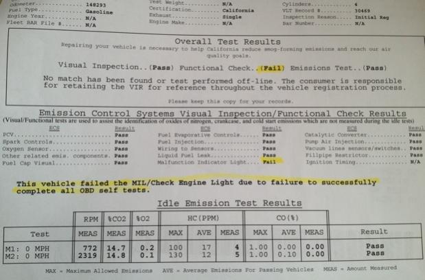

I have a 2002 a4 audi that failed smog. Before smogging the vehicle, I had the following replaced to take my "check engine" light off:
.O2 upstream sensor
.O2 downstream sensor
.catalytic converter (after market)
My check engine light continues to come on. I reset the code about 40 miles prior to smogging. The light stayed off throughout the smog check. However, the smog person told me the reason why he believes it failed. He said, "the MIL/ Check Engine Light did not successfully complete all OBD self tests." Please find an image attached that shows my car's smog numbers.
The code that continues to comes up is, "P0402" which stands for, "Catalyst System Efficiency Below Threshold (Bank 1)."
