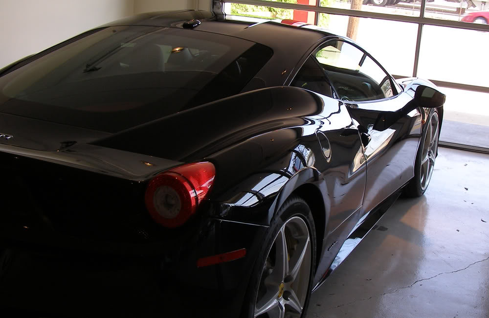

458 italia

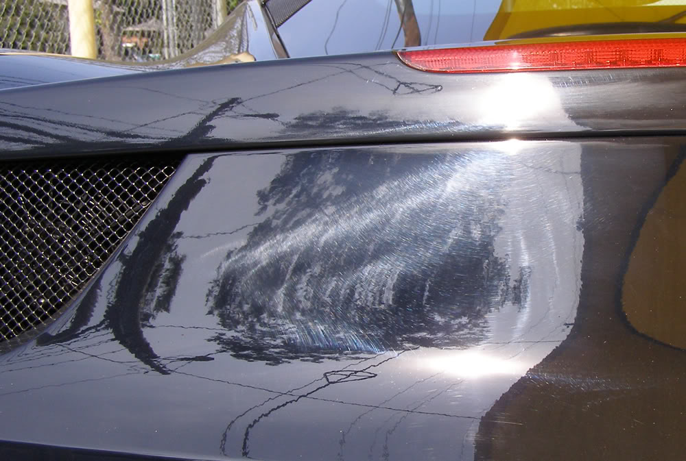

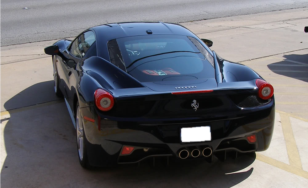

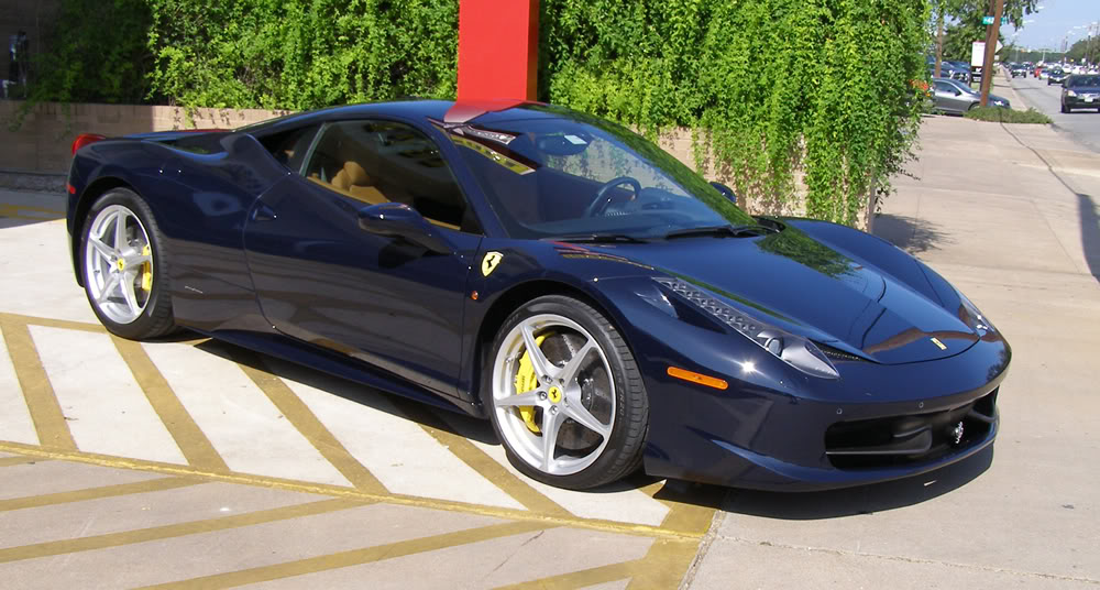

THE MISSION: remove wetsand marks, buffer marks /light holograms , improve exterior appearance.
Material used in correction:
- red cutting pad meg with meg 105 on flex da - 2 passes on wetsand areas , removed with mineral spirits
- green LC light cutting pad with optimum hyper compound on flex da, removed with IPA
- 3m ultrafina on 3m blue pad with flex da , removed with ipa.
- 2 coats of opti-seal
the damage before ( swirls, wetsand)

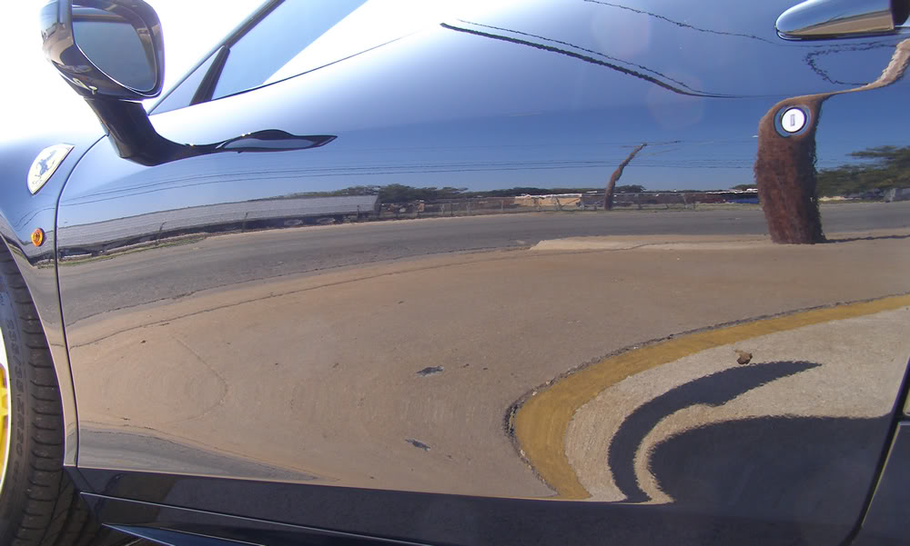

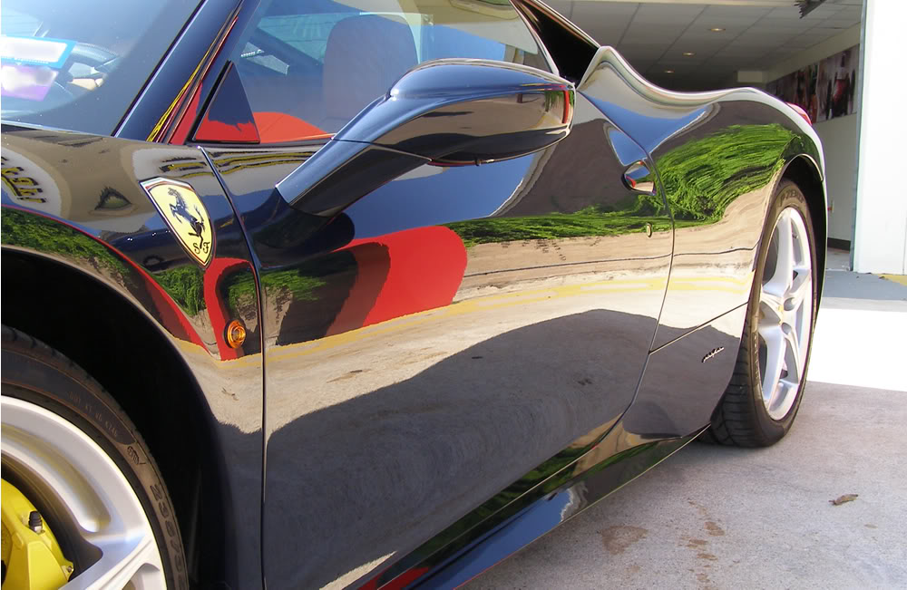

damage after:

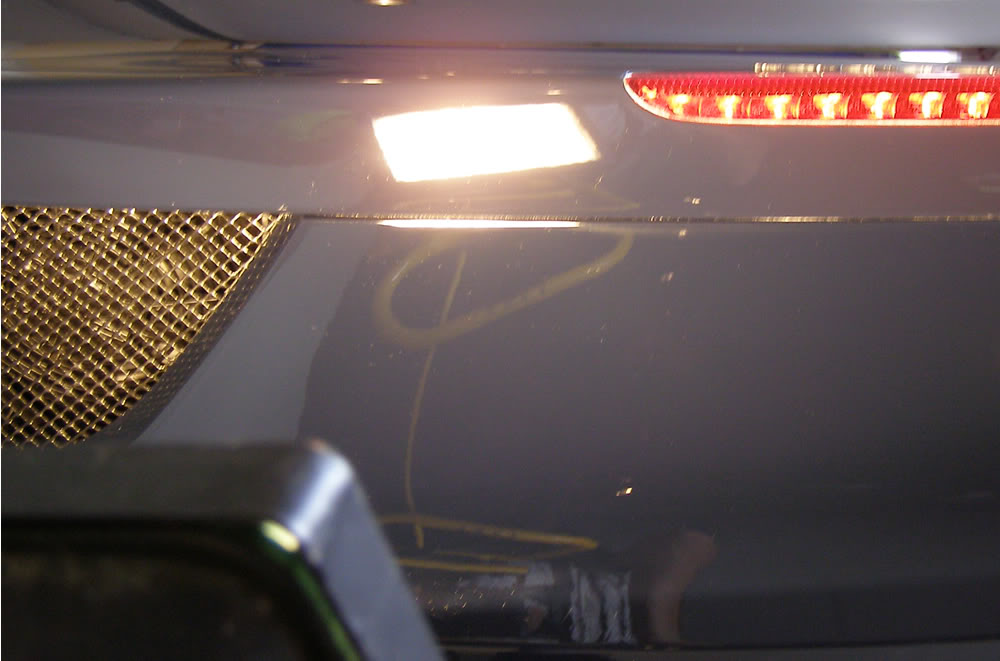

wetsand before:

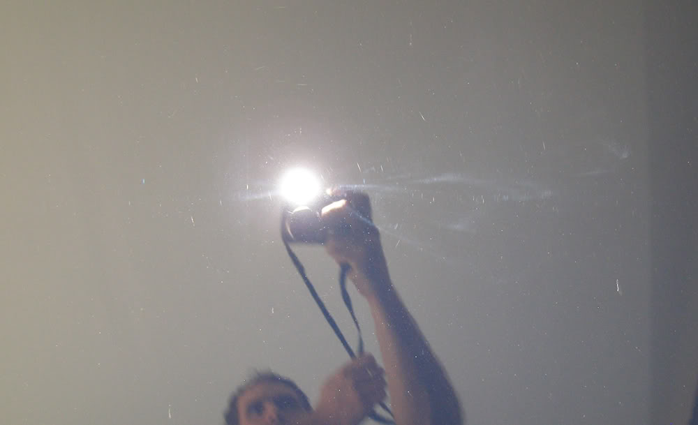

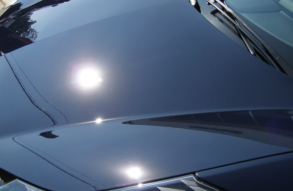

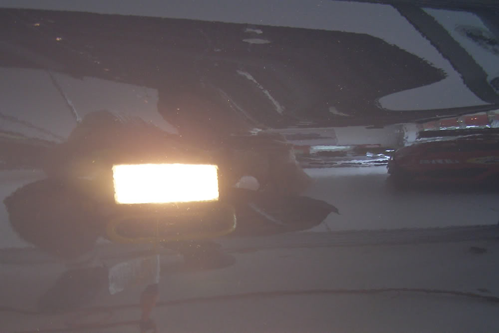

light holo on hood:

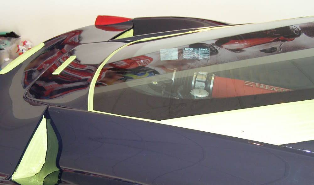

Pictures from process:

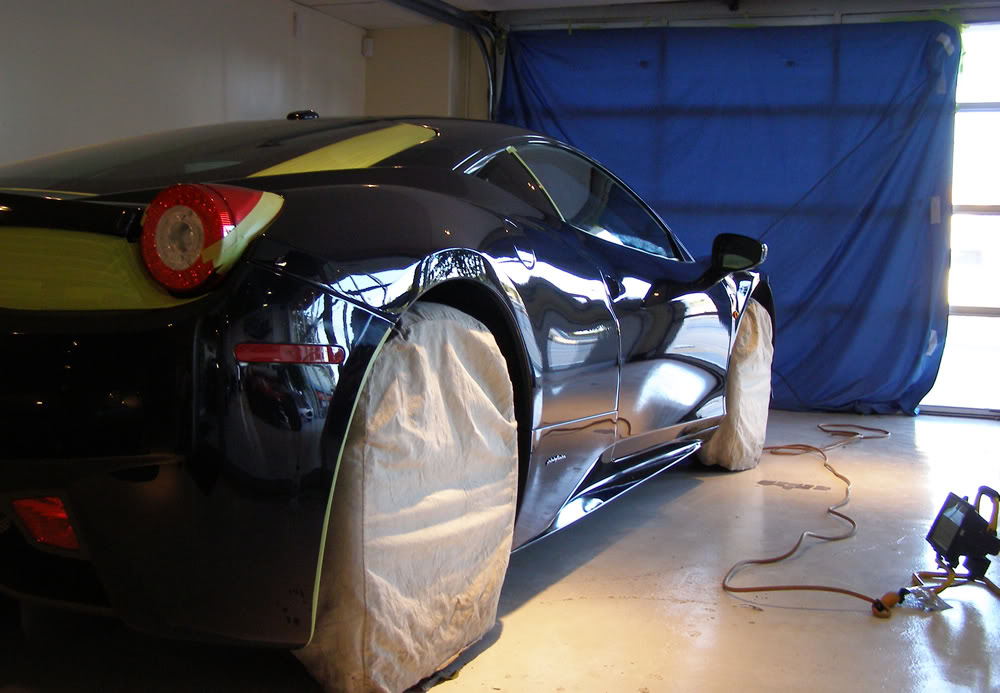

Tape everywhere

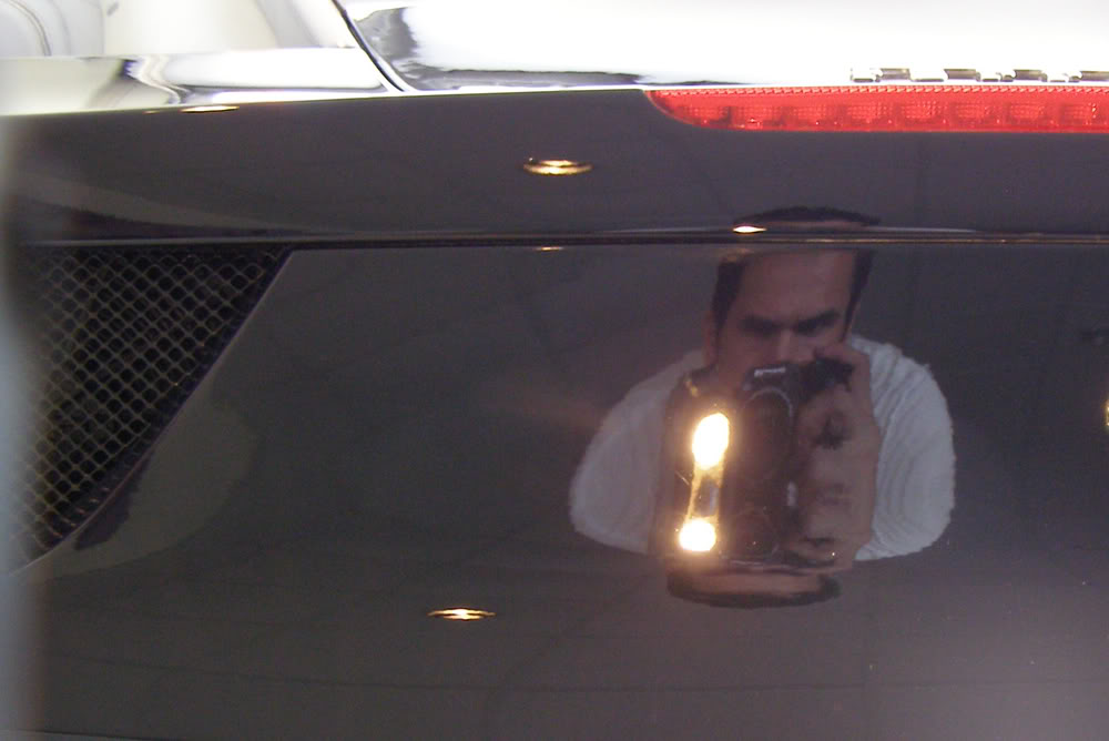

the rear bumper was the last one touched

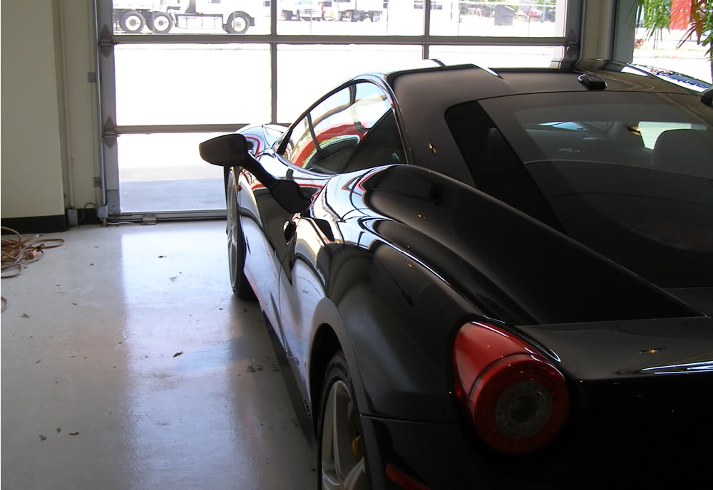

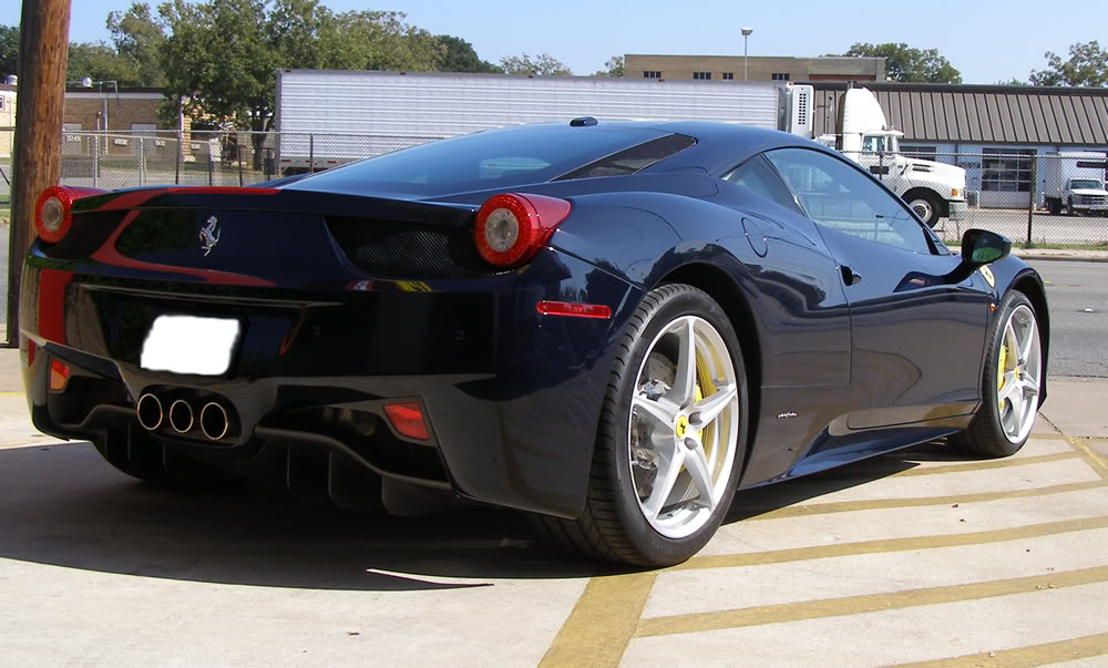

ready to go in the sun

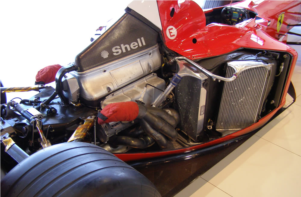

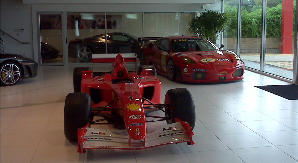

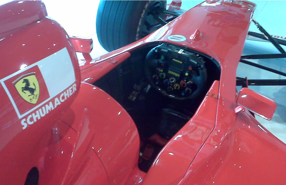

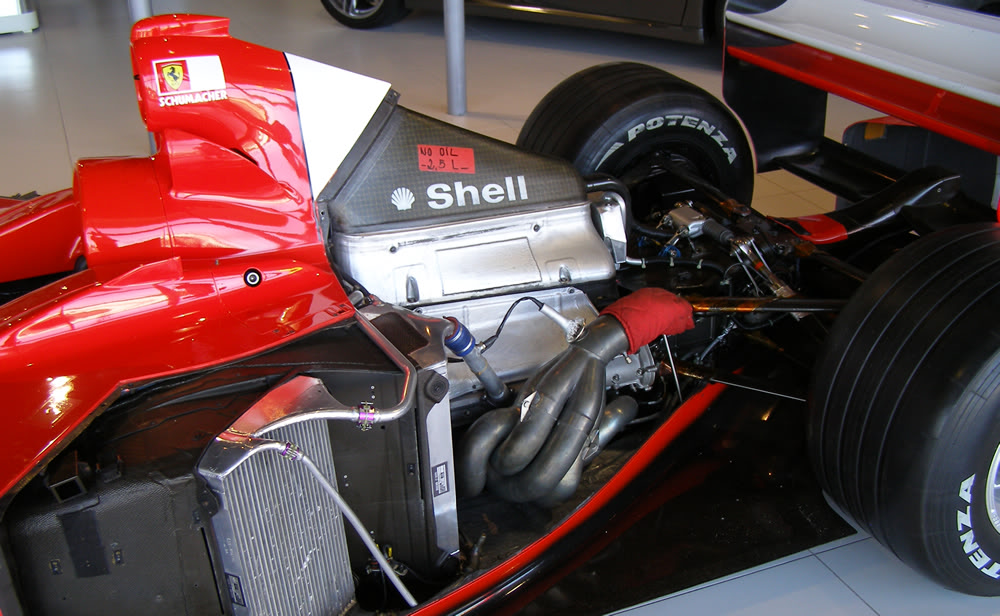

Ferrari F1
the cars was at some event , i was asked to give them a refresh , wipe down , and wax
exterior is beat up, needs a lot of work , but the engine is what matters on those cars.
the pic was taken with cellphone.
