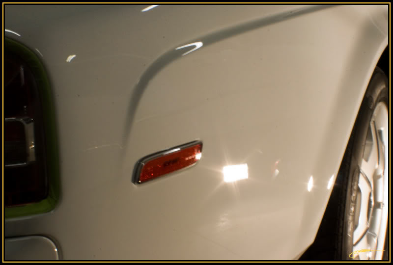

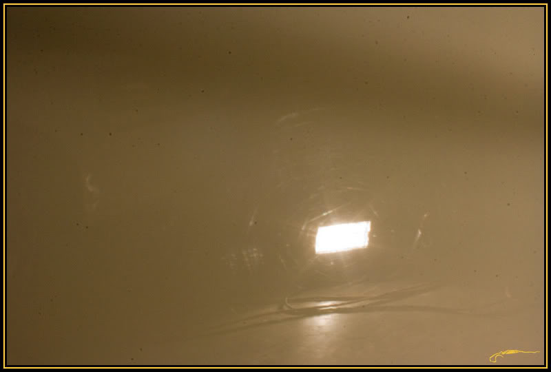

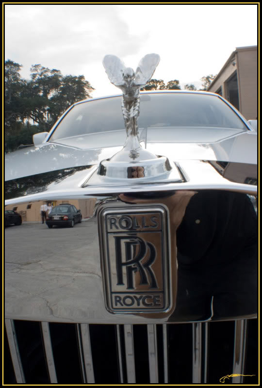

I was contacted by a local Limousine company to fix some obvious issues on the paint of their Rolls Royce they had just purchased used from Miami. I was informed there were buffing trails, etc so knowing that Rolls Royce paint is generaly on the softer side I thought I would have it somewhat easy on a nice car. Boy was I wrong! We wont even mention the what seemed like 4 foot tall door panels and the length a little over 19 feet! Once I started the decontamination process I began finding little clues(orange peel, unfinished sanding, etc) that the car had been repainted at some time, only to find out the entire driver side of the car had been painted after finding the blend spots over the rear A-Pillar and front fender. I had my work cut out for me.

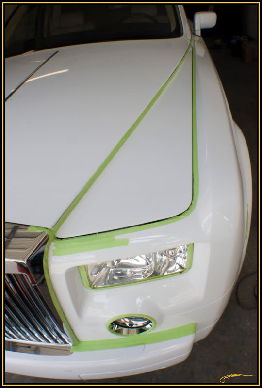

3M Automotive Performance "Green" Tape

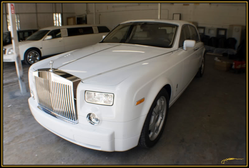

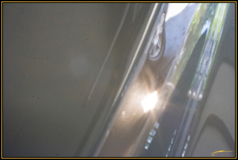

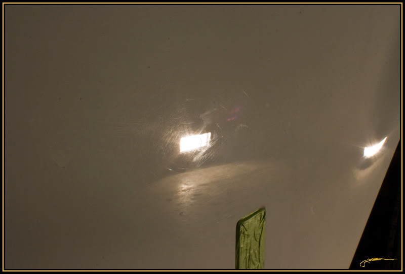

BEFORE:

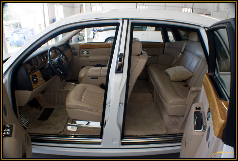

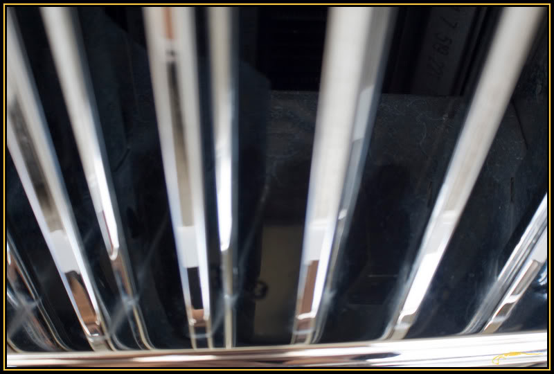

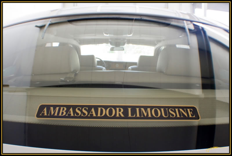

The interior had already been cleaned so I did no work to the interior.

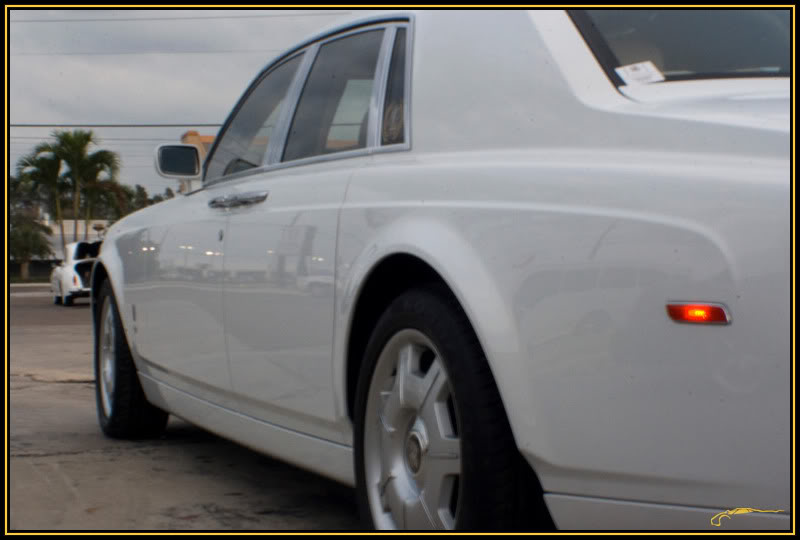

Hard to reach area.

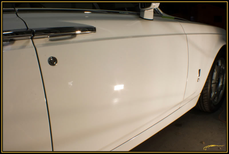

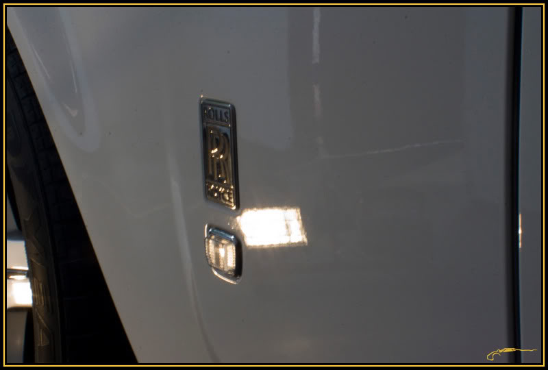

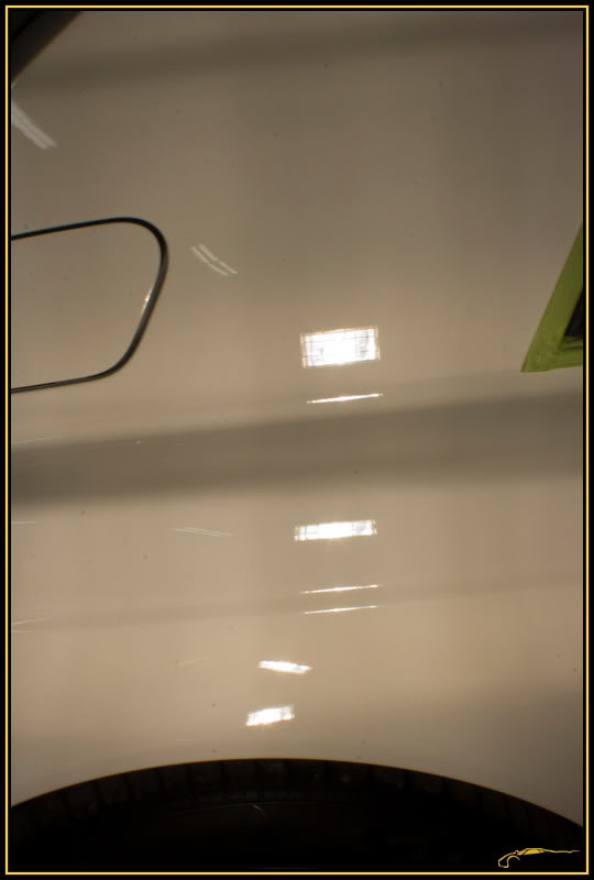

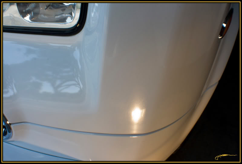

On to the real damage..Series of Before/After shots, none of which have had LSP applied yet.

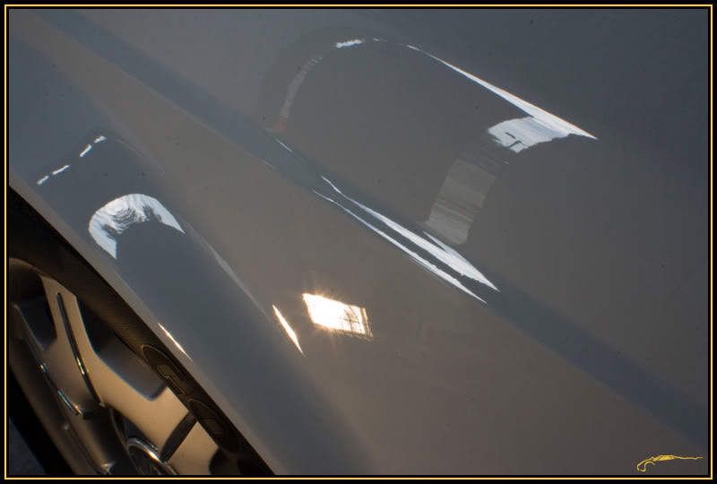

Wheel Arch Before.

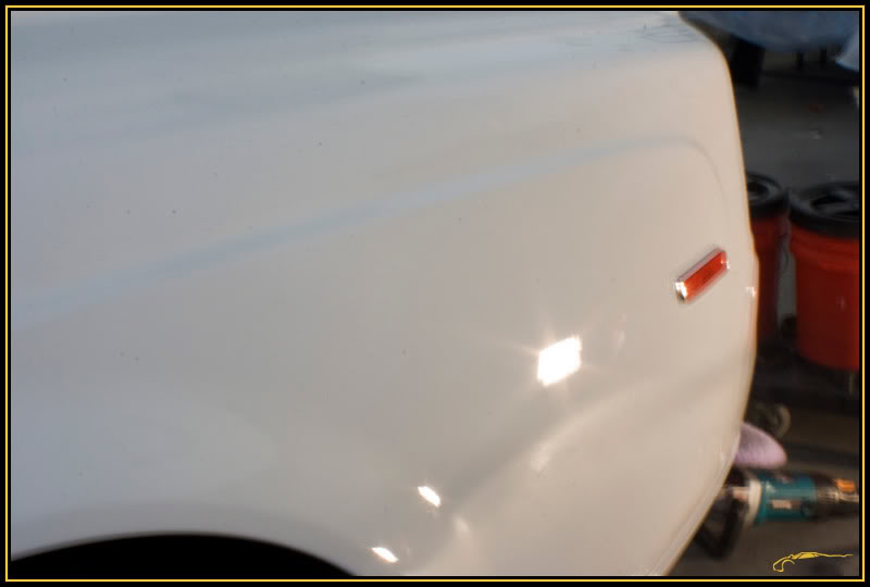

Wheel Arch After.

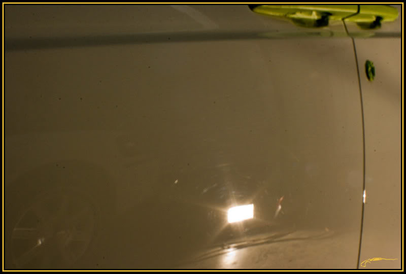

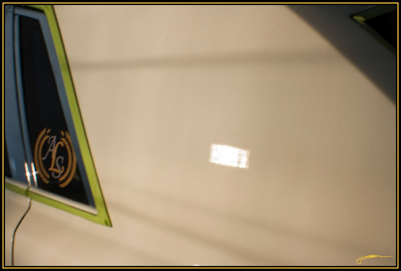

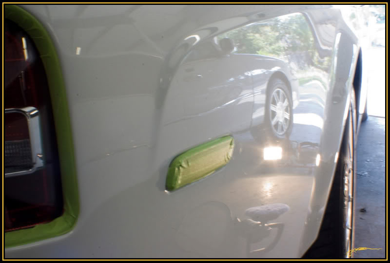

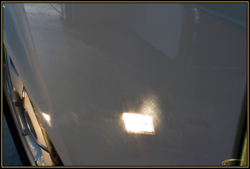

Rear Pillar Before.

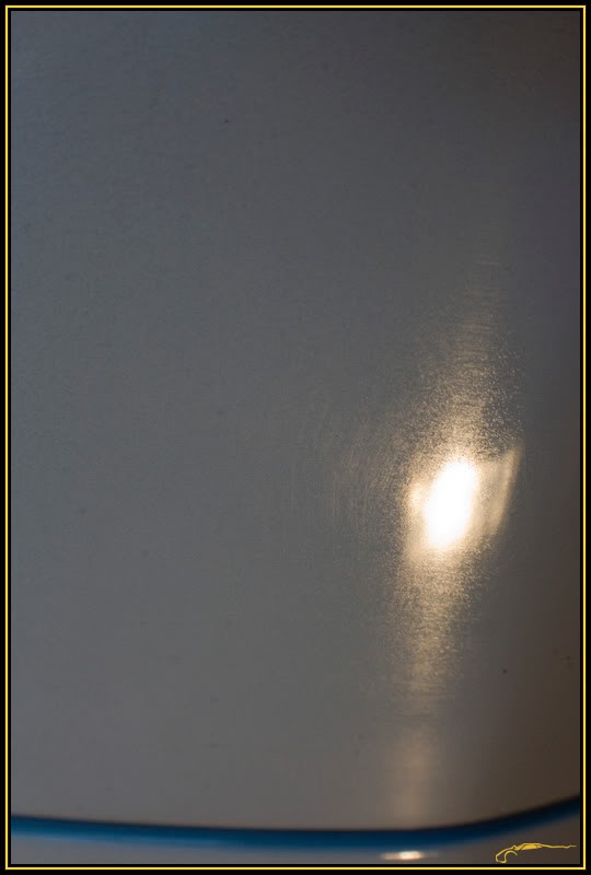

Here you can see the haziness from the buffing trails left even without proper light.
Rear Pillar After.

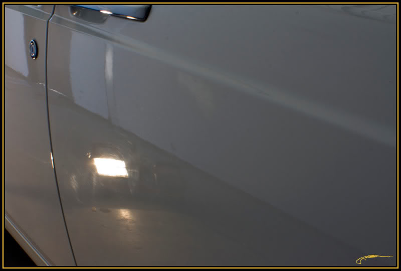

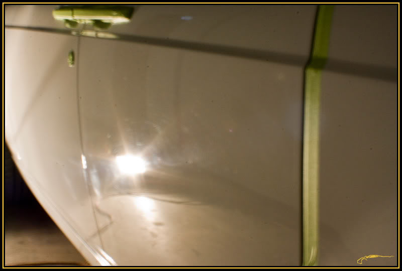

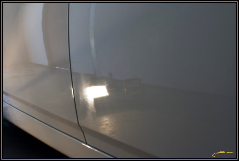

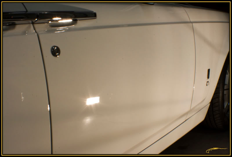

Drivers Doors. Unfinished areas of sanding.

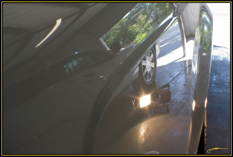

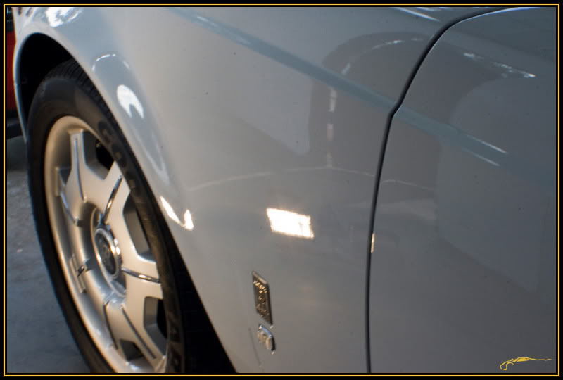

Front Fender Before.

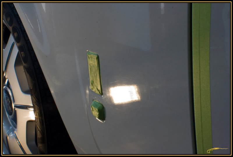

I wasnt able to capture the defects for the top panels with my camera, so I didnt bother taking any, except this one taped off to protect the chrome trim and edges.
