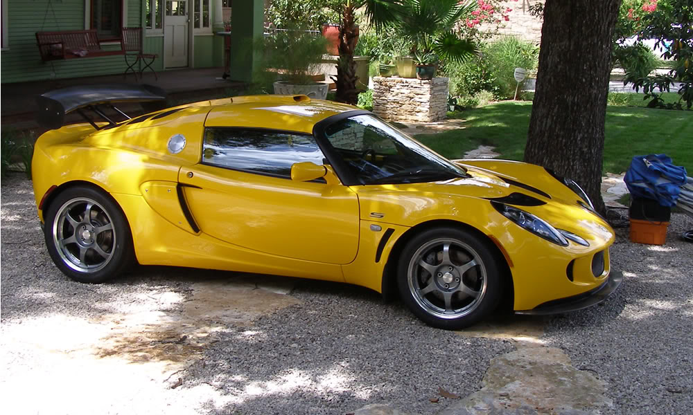

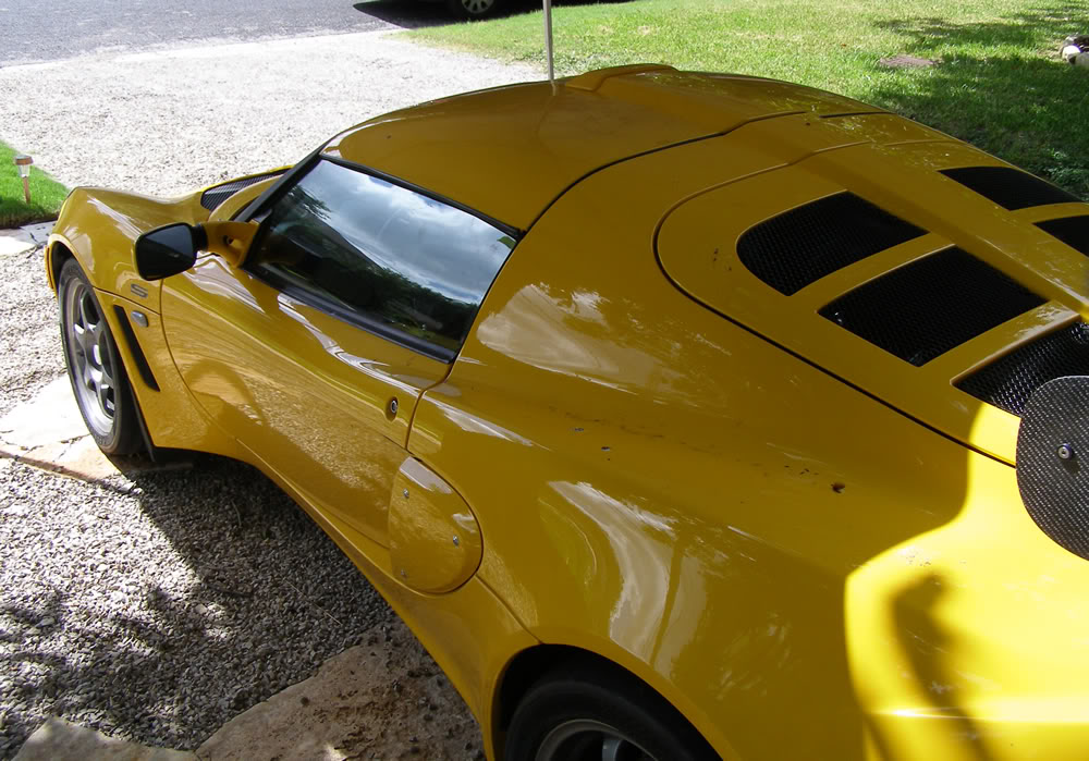

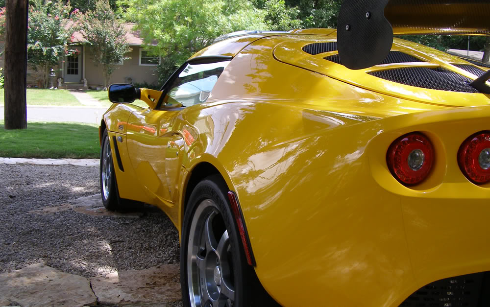

The mission: remove scuff from driver door , claybar the whole car.
The process:
- interior was refresh with 303 protectant , on seats and dash.
- exterior was wash with onr and 2 buckets , fine claybar ,protection 1x optimum car wax, 2x duragloss 105

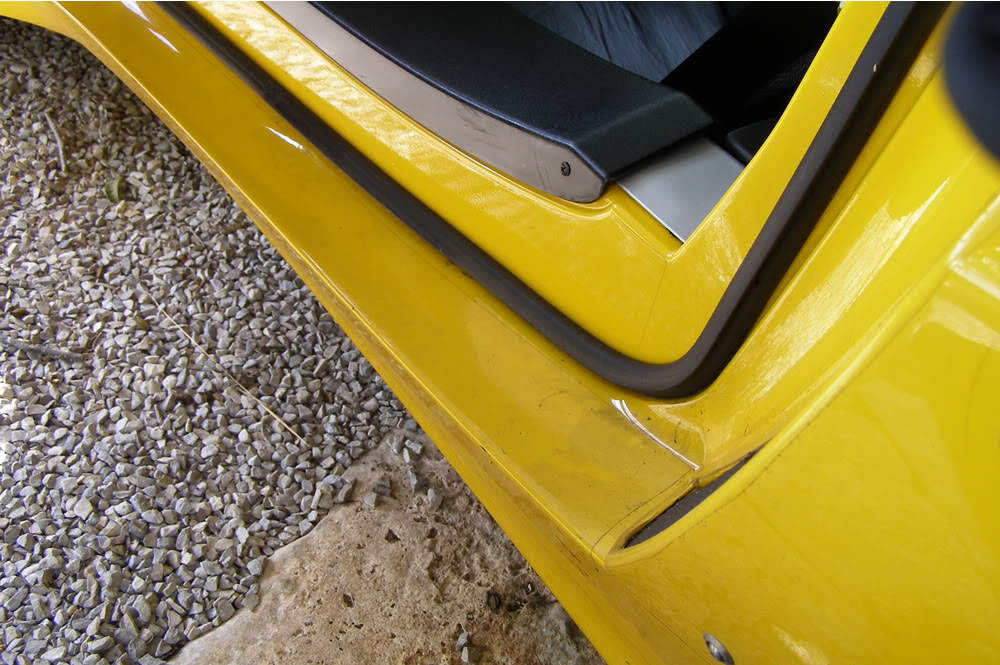

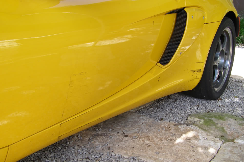

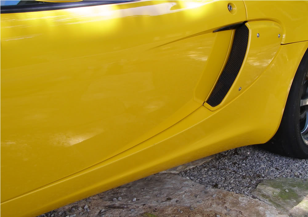

- scuffs was remove with aggressive claybar , alchool and elbow grease , plus polish pad on DA and d151 meguiar`s paint recondition cream.

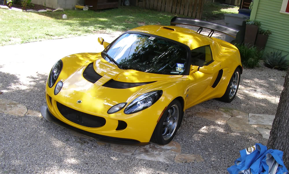

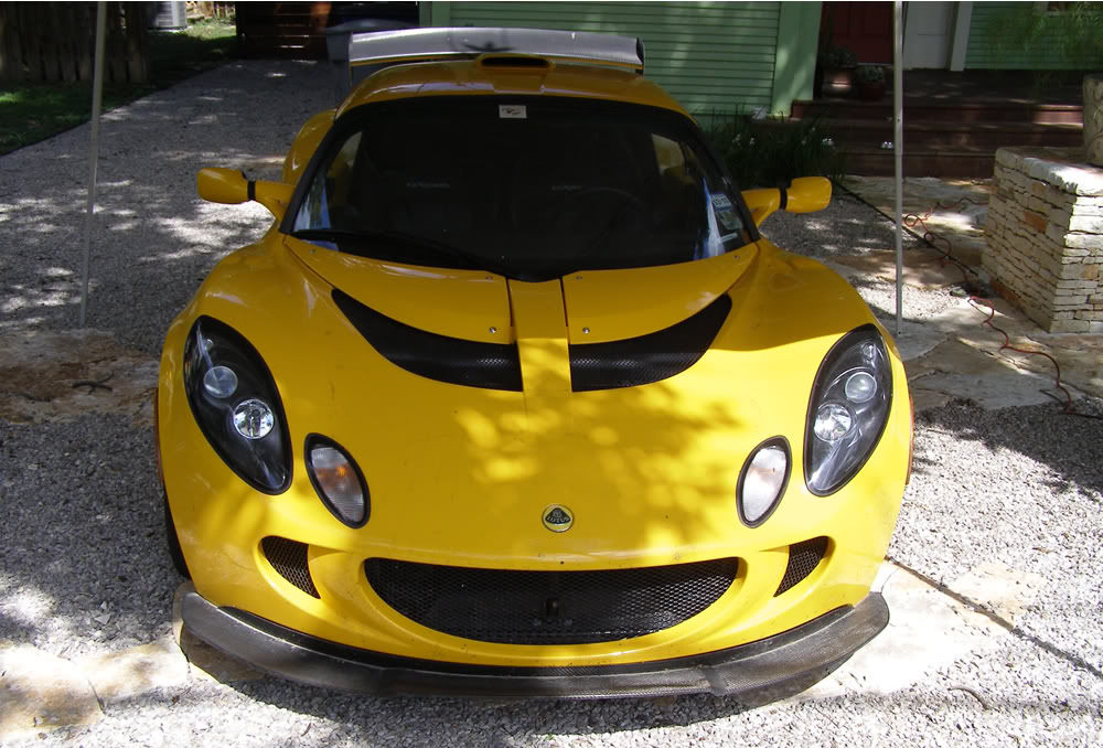

the car before:

scuff before:

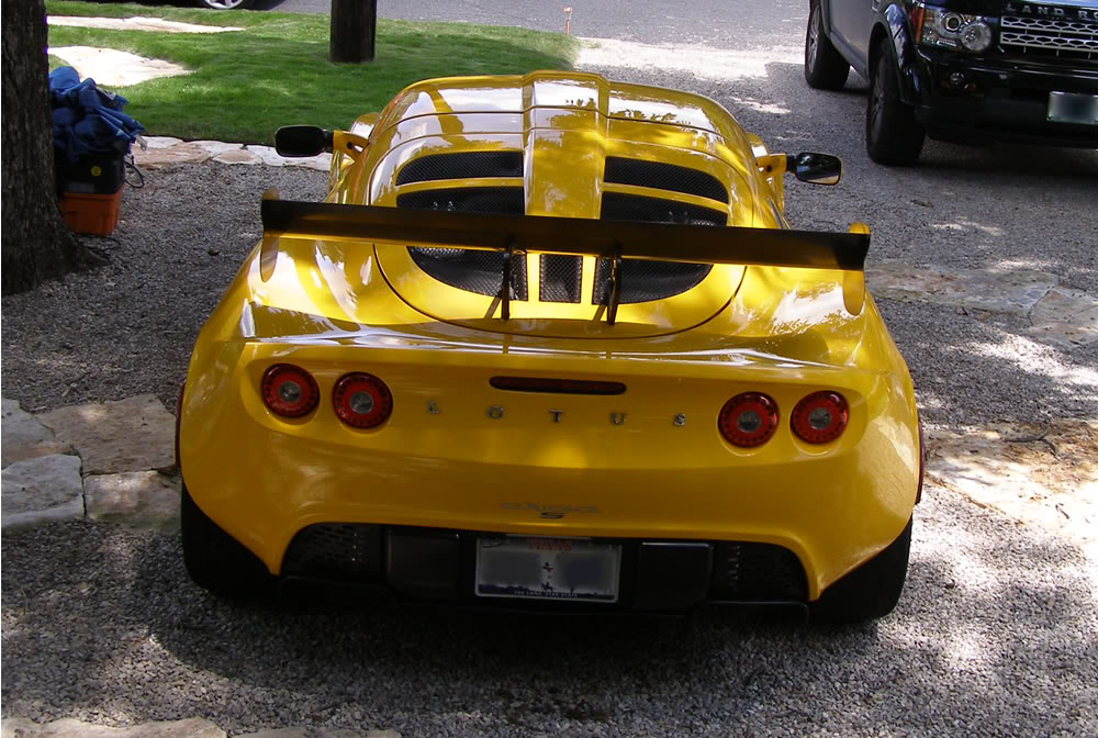

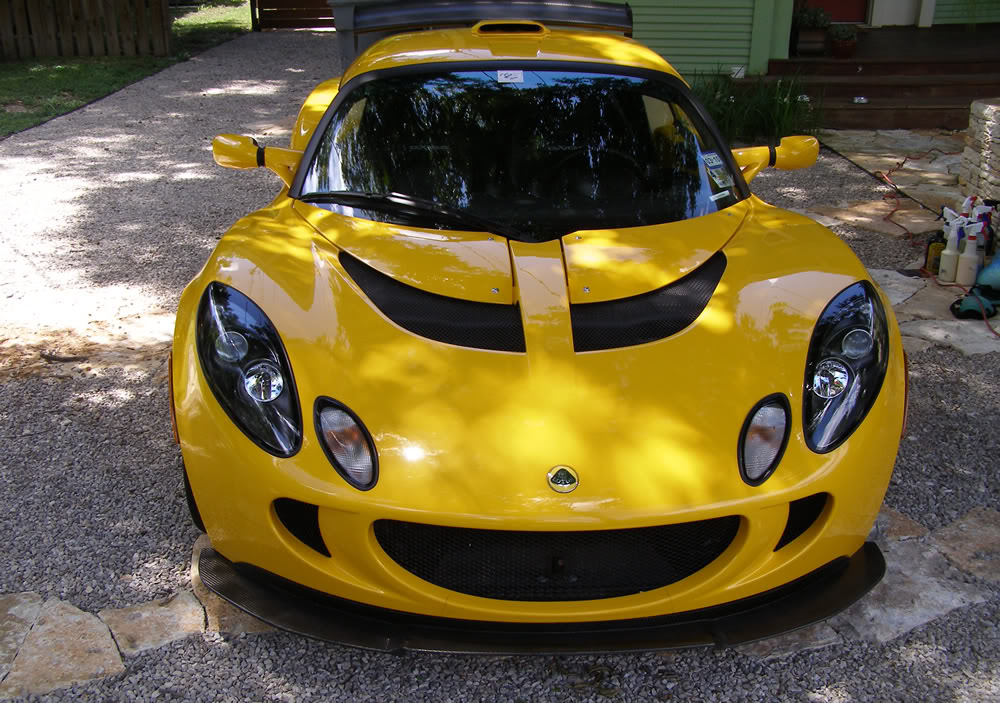

scuff after:
AFTER:
