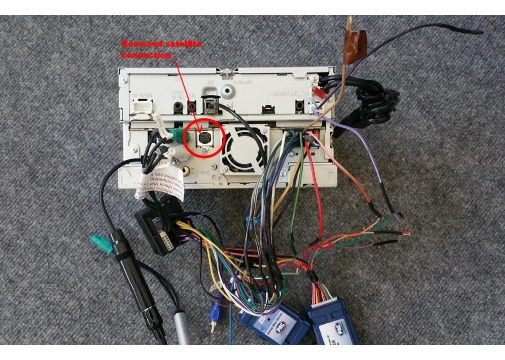

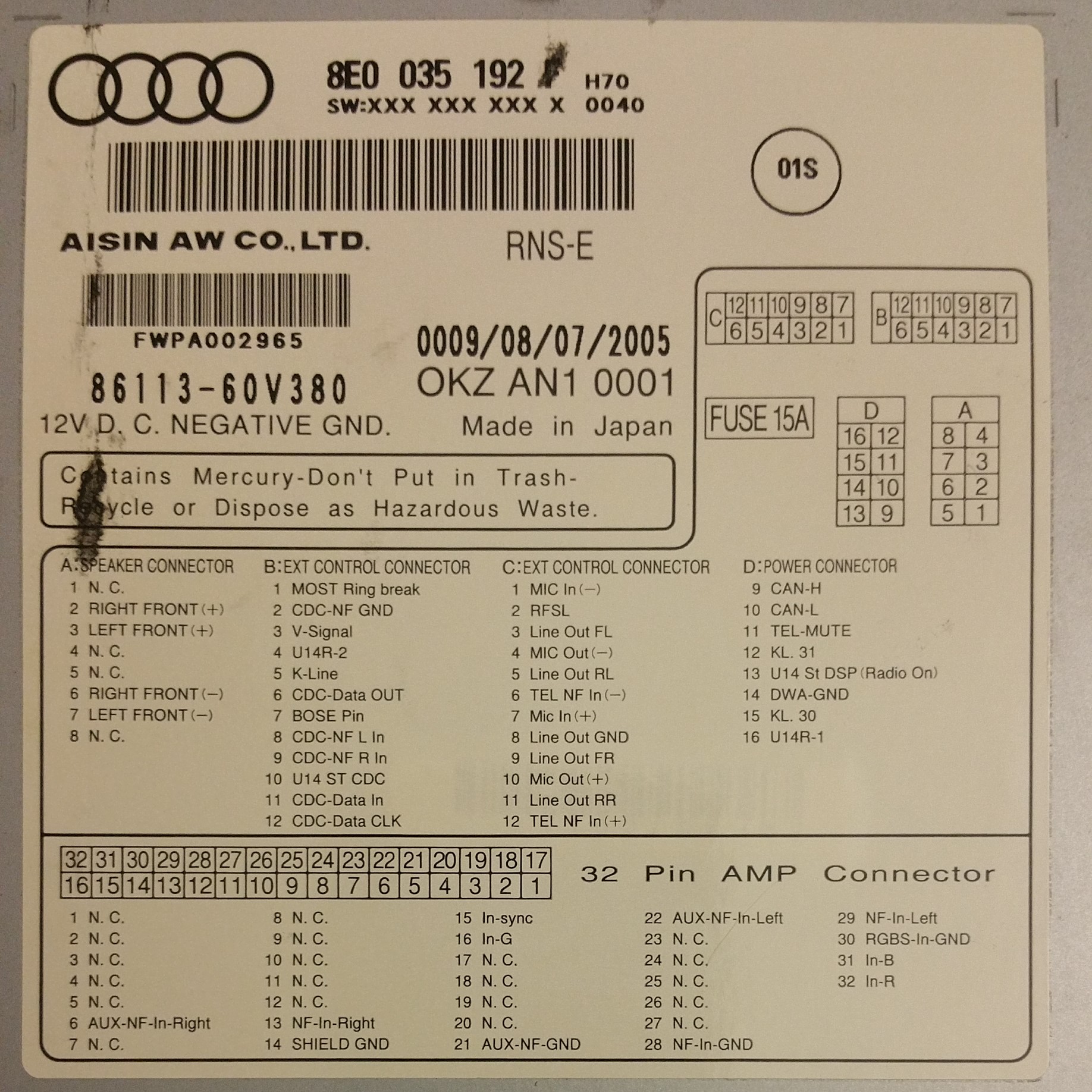

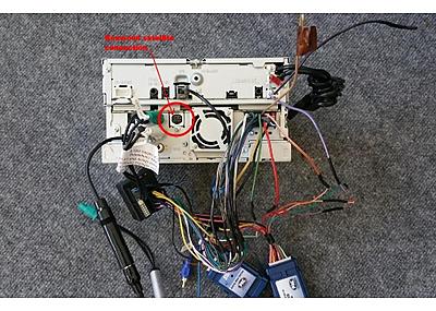

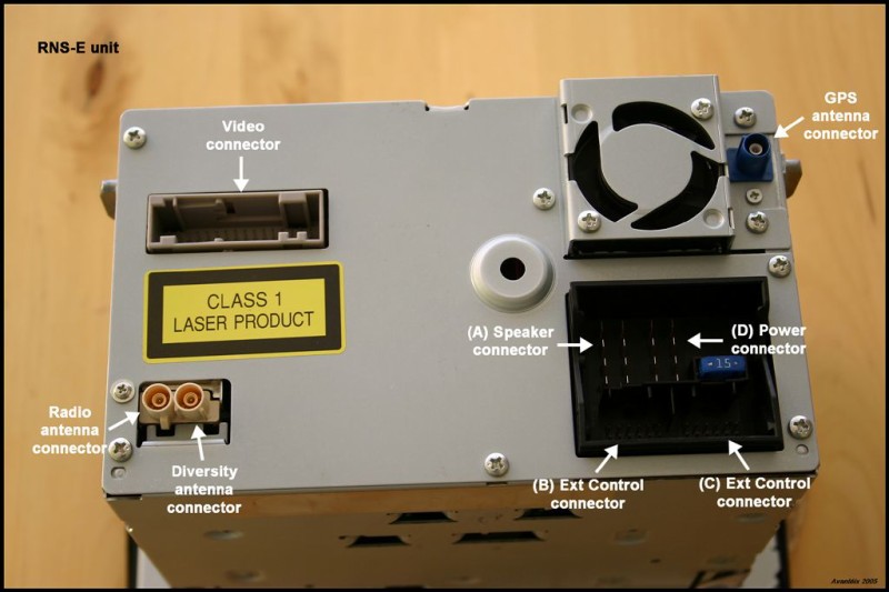

I'm replacing the factory head unit with a Kenwood DNX890HD, I have a good handle on everything except the Sirius tuner, can anyone help with the connection for the oem tuner to the aftermarket headunit? I have attached pictures of what's being taken out and what's going in. Thanks.
