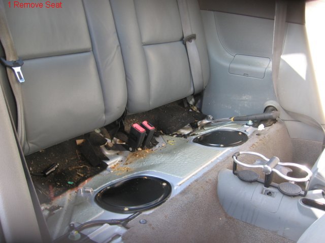

1. Remove the rear seat. You can just lift up in the front and it will pull out.

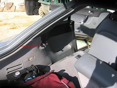

2. Lower rear seat backs, remove the seat latch bolt as shown. The side panels are held on with metal snaps. You can pull
firmly and snap it off. In some cases, I had to use a screwdriver to pry to prevent breaking the panel.

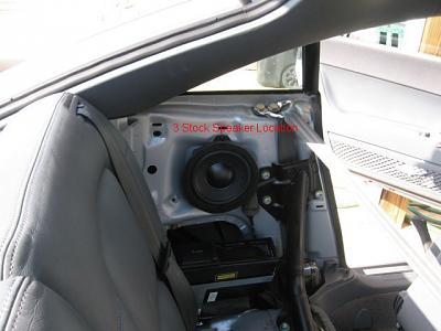

3. Remove the stock speaker with torx bit.

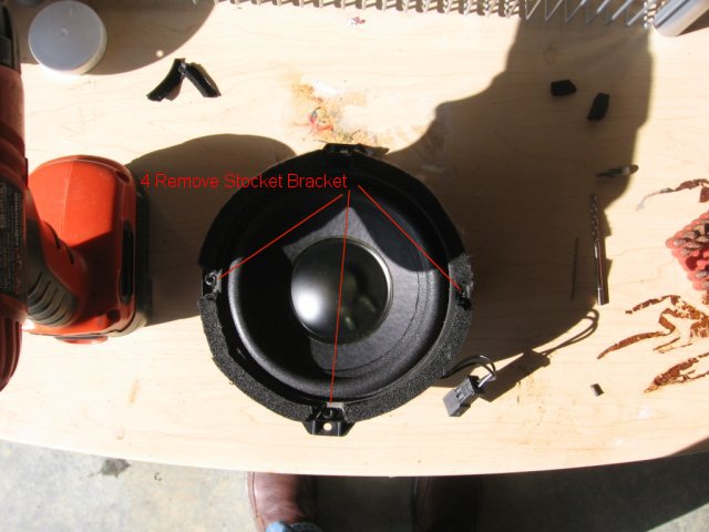

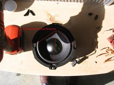

4. Remove the stock bracket from the bose speaker using torx bit.

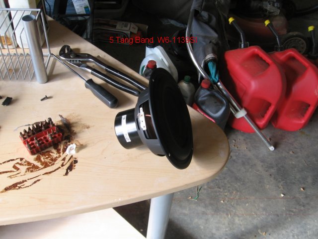

5. Get your sub ready to attach.

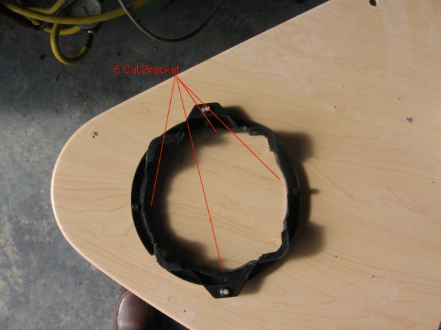

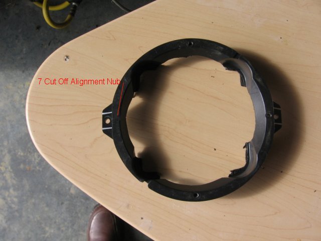

6. Cut the stock bracket with a jig saw to create a rounded opening until it fits securely around the new sub.
7. Cut off the stock alignment nub as shown using the jigsaw.

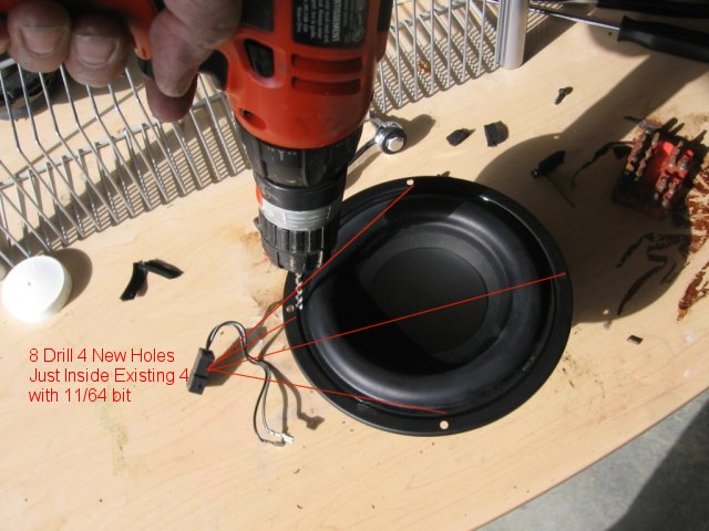

8. Drill new holes in the sub using the 11/64" drill bit. Be very careful to to slip and damage the sub.

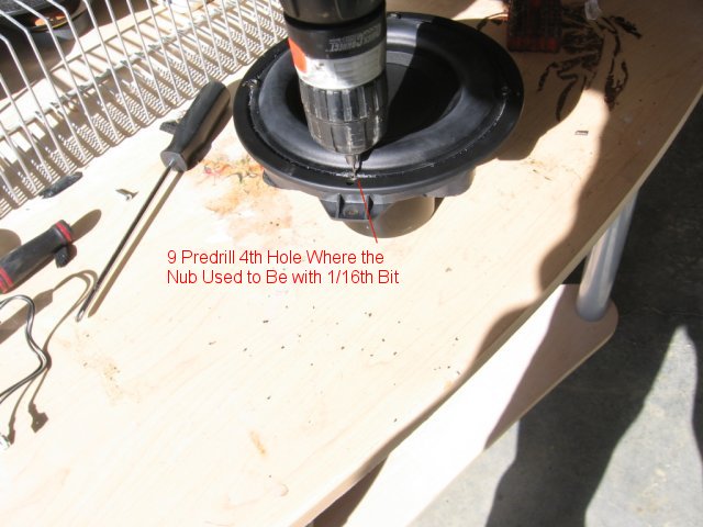

9. Connect 3 of the screws in existing holes, then drill the 4th starter hole using the 1/16" bit or appropriate size for
your screw.

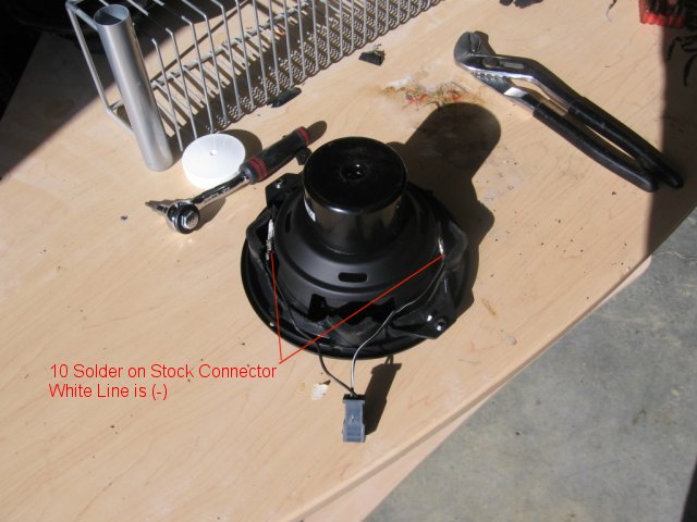

10. Solder on the stock connector. The reason you don't want to crimp and use this on the new speaker is because they are
reversed. If you install then the polarity will be reversed. The wire with the white stripe should be on the (-).

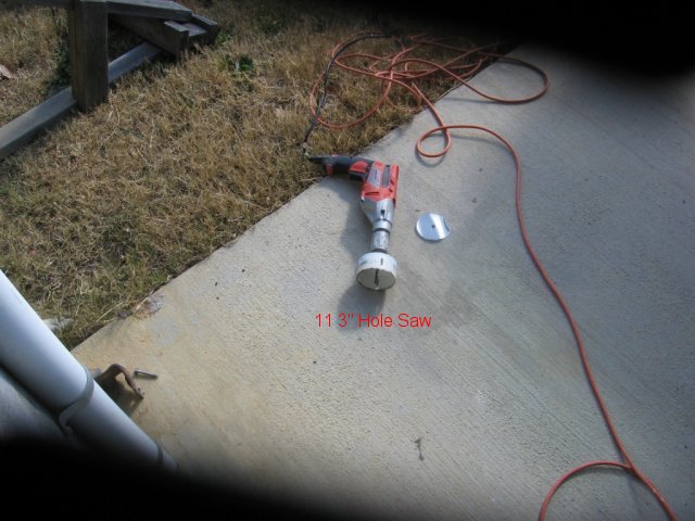

11. Fix the hole saw to your drill.

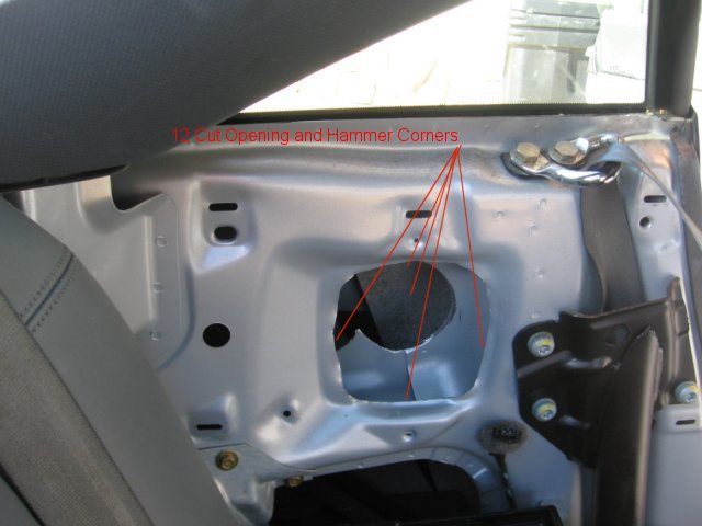

12. The new sub is deeper than the existing hole allows. You must cut out a hole for the new magnet. I used a drill with a 3"
hole saw. The metal is very soft so the hole saw cut it easily. Wear safety goggles because metal flies. Also, cover up your
CD player with a towel to prevent metal shavings from entering. Then hammer the 4 corners out so the larger speaker will fit
snug without rattling.

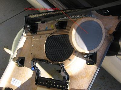

13. Using a dremel with cut off wheel, carefully cut the backing from the side panel. The new spekaer has more deflection and
it rattles against the side panel if left stock. I figured this out after I had them back together, but I'll save you the
time.
14. Here is a picture of the new sub installed. Attach your side panel and you're done.
