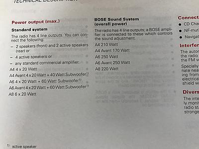

I'd been searching the forums for a while until I realized my car still has all the original manuals, one of which is the Operating Instructions for Sound System Symphony. Attaching the page with the specs. It contains info for the A4, A4 Avant, A6, A6 Avant, and A8, both the standard and Bose options.
Also, I measured the impedance of the speaker from my front passenger door with a multimeter. I got a reading of 2.6 ohms. Since this quick multimeter reading is usually 15% less than the nominal impedance, I would say it's a 3 ohm impedance for the stock speaker.
