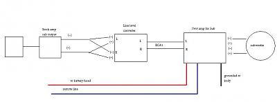

You now what, I stared at the Line level Converter for a minute today trying to figure this out, and I think I did.
So im guessing the sub output for the stock sub is mono. And to go from 2 wires ( - / + ) to 4 (L - / +) (R - / + ), then I would just connect the sub output ( + ) positive to the Line level converter ( R + ) ( L + ), so 1 wire to 2, and then the sub output ( - ) negative to the Line level converter (R - ) ( L - ). again 1 wire to 2. that should split the signal properly and give both the R / L the proper sound it needs so when I connect the sub to my amp in mono?
attached is a line level converter diagram that I drew so someone can help me confirm its how I should wire it

Old Jan 22, 2010 | 07:22 PM
SILVER A6 2.7T's Avatar
Joined: Apr 2009
Posts: 55
From: woodbridge va
honestly ive ran a converter before its going to sound like ****. my bro has the same subs and amp on a converter in his durango. if you get a aftermarket cd player and just get the wiring harness that bypasses the stock amp your subs will hit 2x as hard for sure and i think its easier to hook-up than a line out coverter. if you dont want to do that then all you do is the pos. on LOC go to pos on speakers and same with neg. then just ground the amp run a power wire to batt. and remote to back of stock radio and your done. oh and rcas from LOC to amp.

Old Jan 22, 2010 | 07:27 PM
Joined: Apr 2009
Posts: 55
From: woodbridge va
one more thing you dont have to use the sub for the LOC you can use any speaker in the car. but since the remote wire should be hooked up the back side of the radio you can just put it in back there just find out which wires are for you speakers and its just pos to pos and neg to neg oh and the LOC should have like 2 brown wires and 2 grey or something like that its because 1 set goes to the right speaker wires and the other goes to the left side speaker wires
