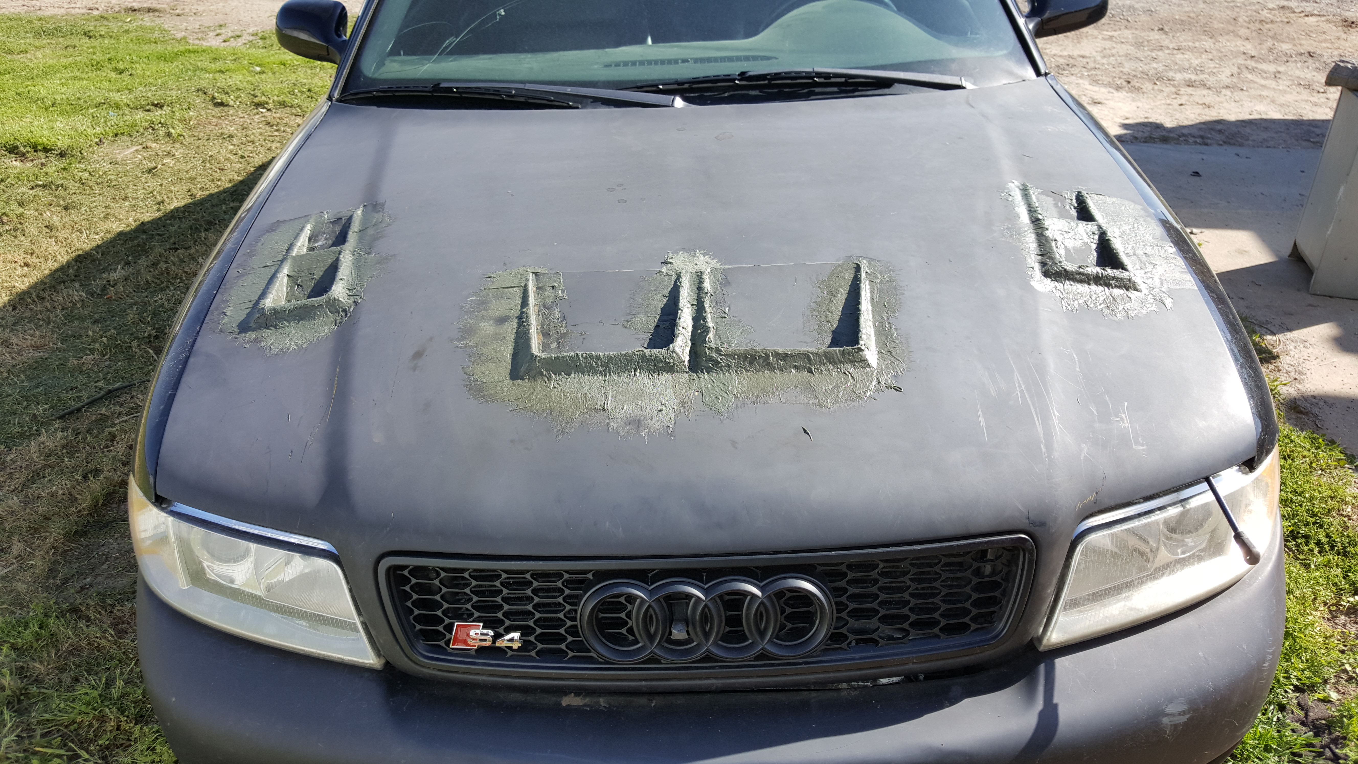

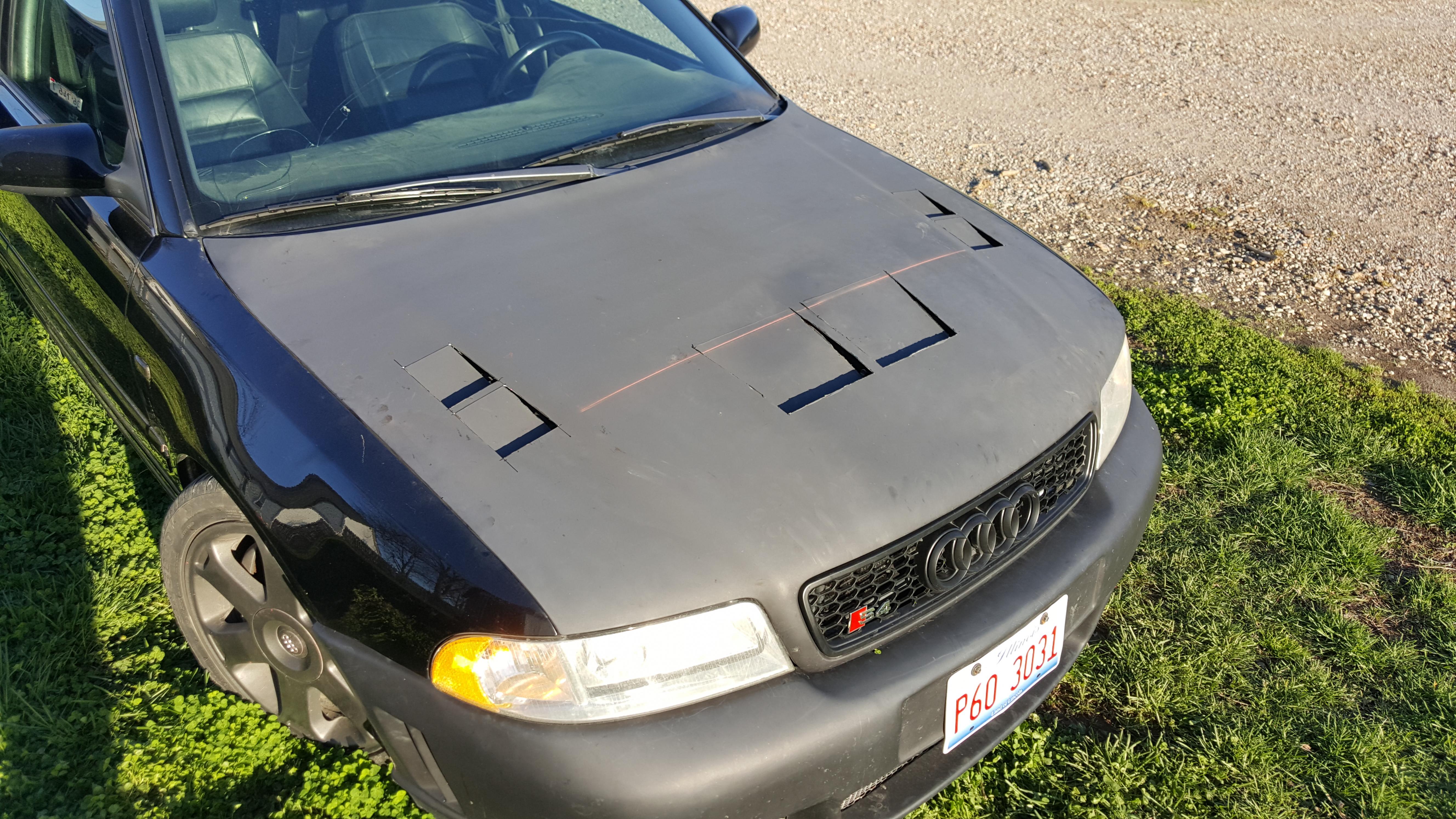

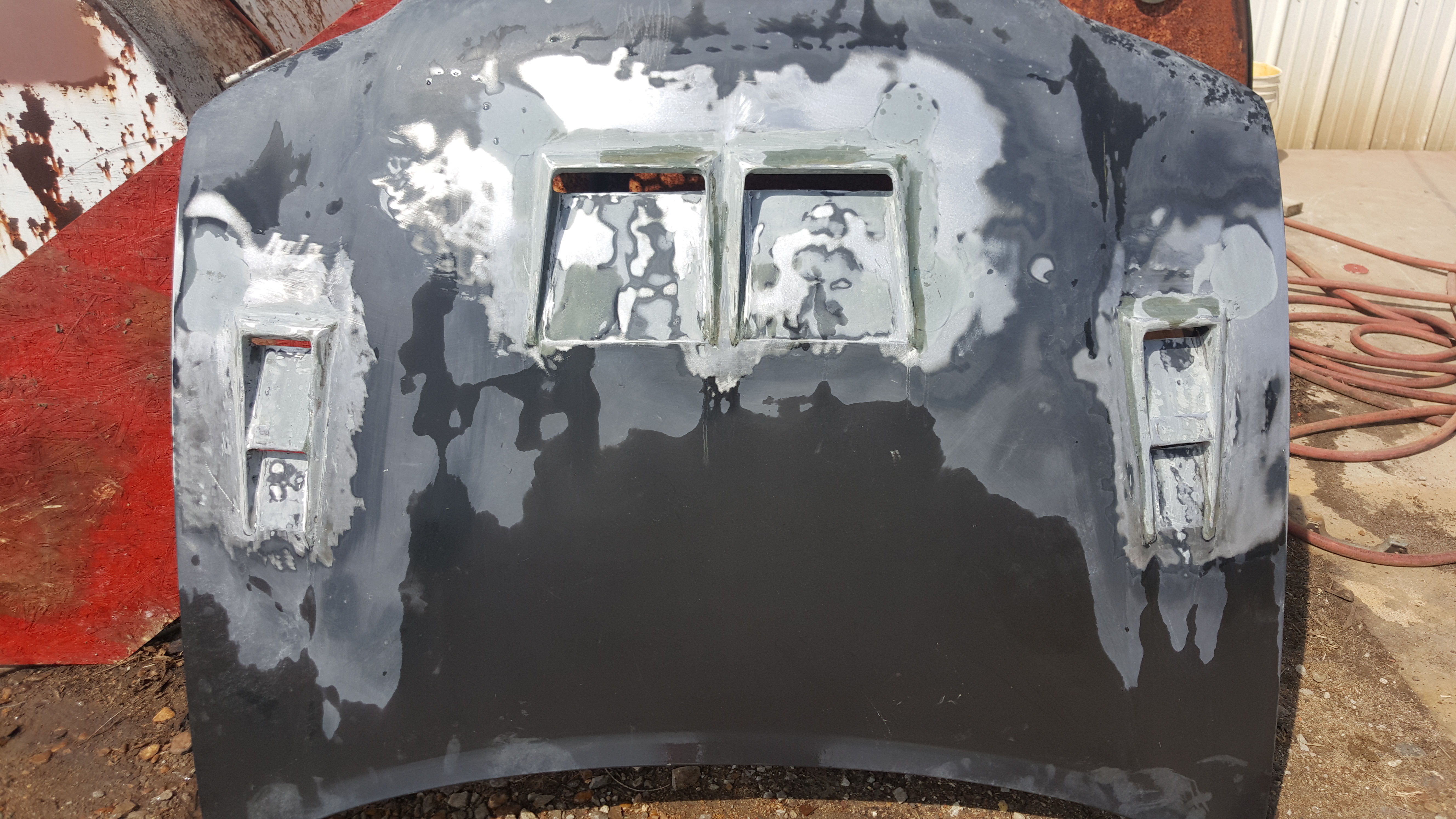

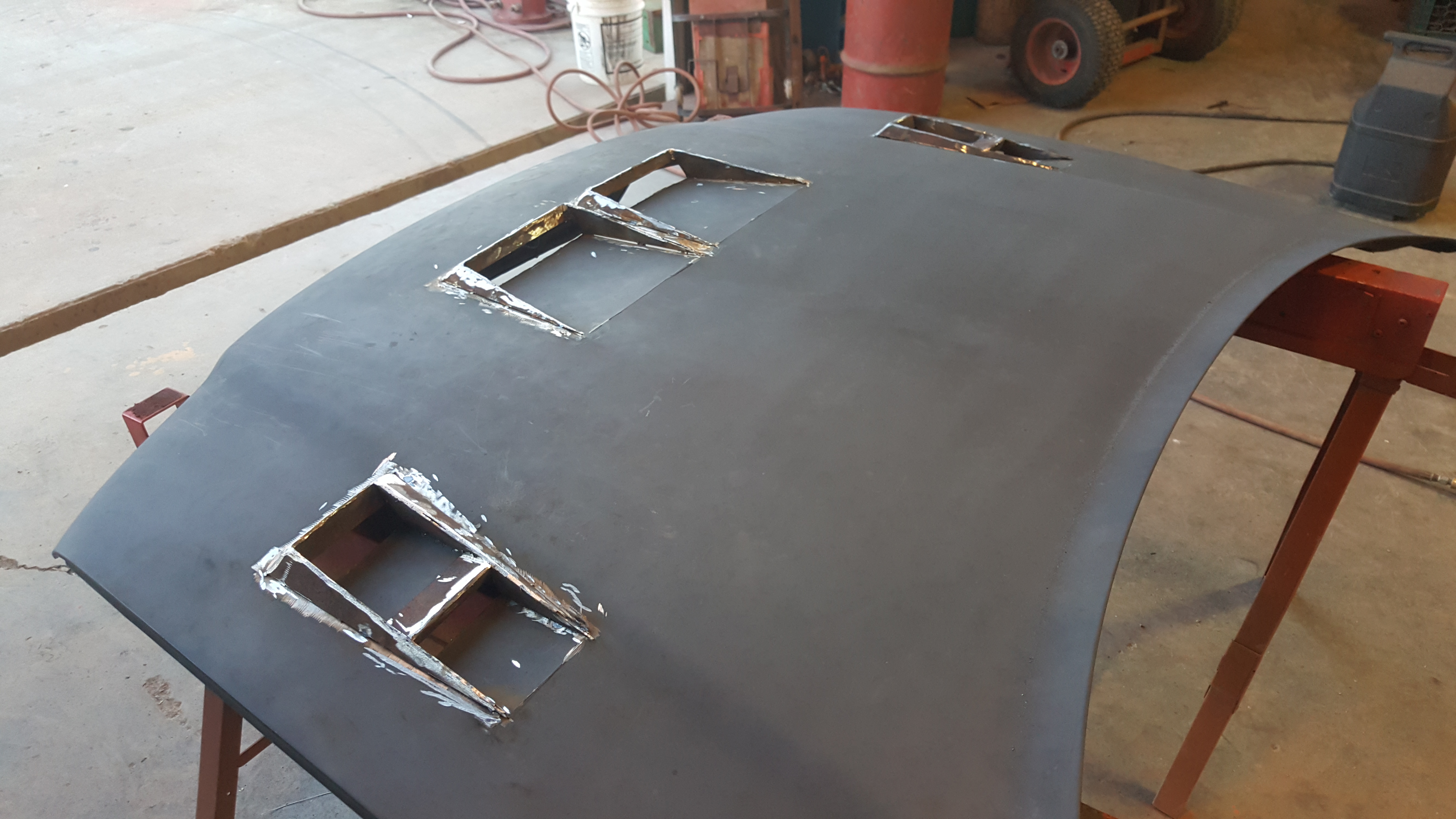

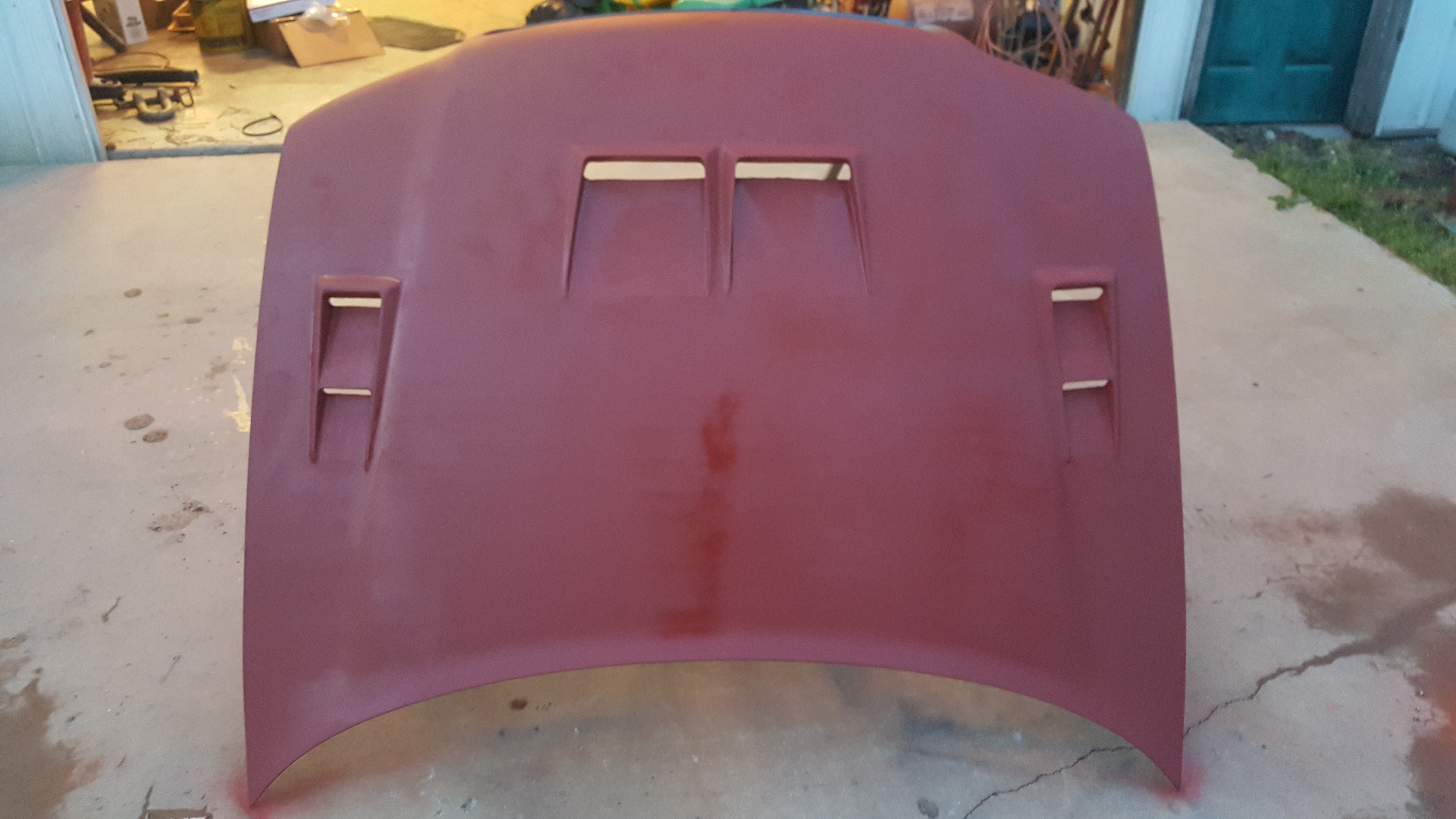

Started cutting on my hood and wanted to share it. Cut the holes where no supports had to be cut. Just measured how wide I wanted them and bent them down an inch and started welding the metal in. Last picture is the final shaping sanding before the finishing coat is put on. The center holes are 4 inches give or take(can't remember for sure) back from the radiator so hopefully they'll help remove the heat. Let me know what you think

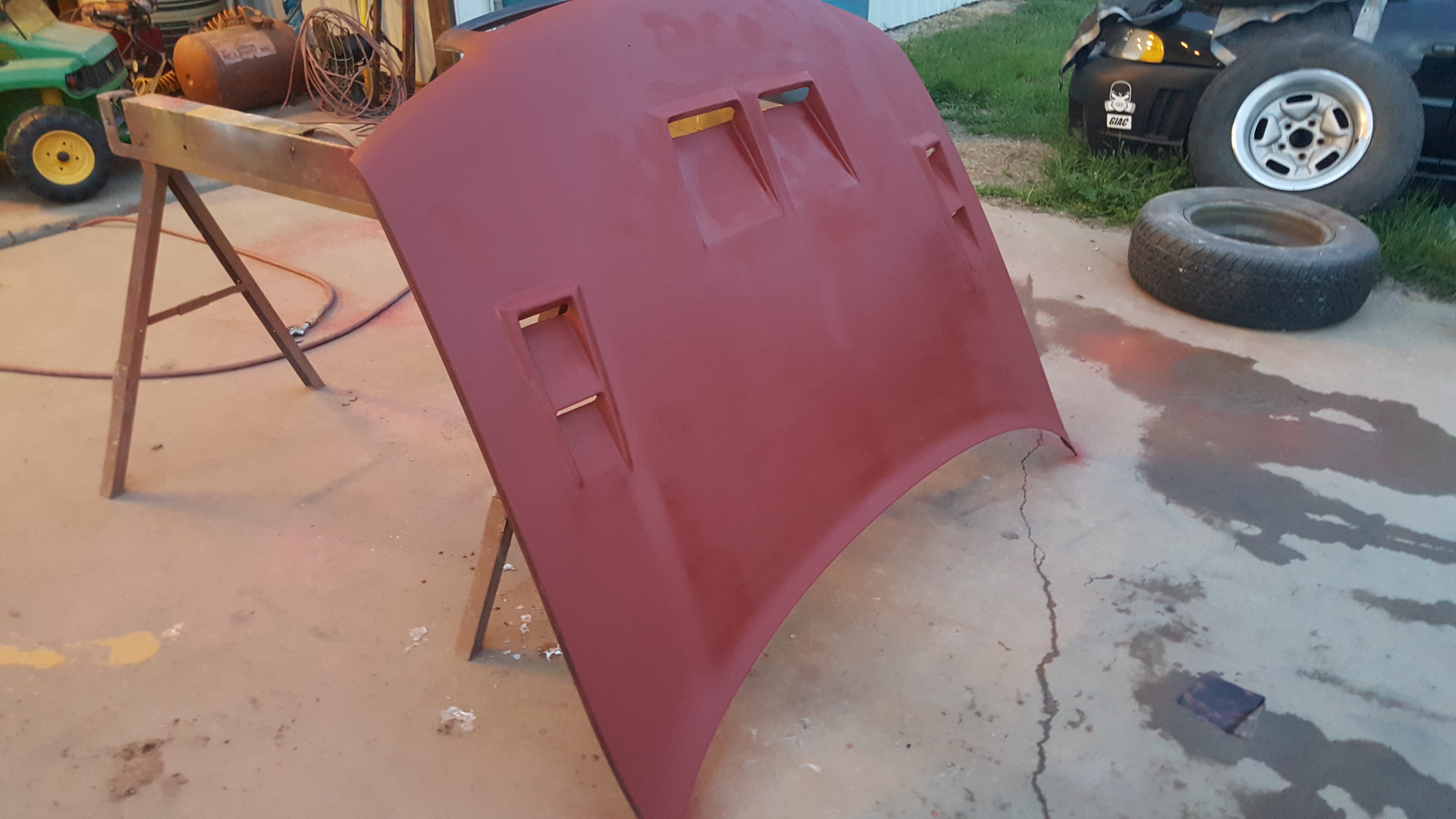

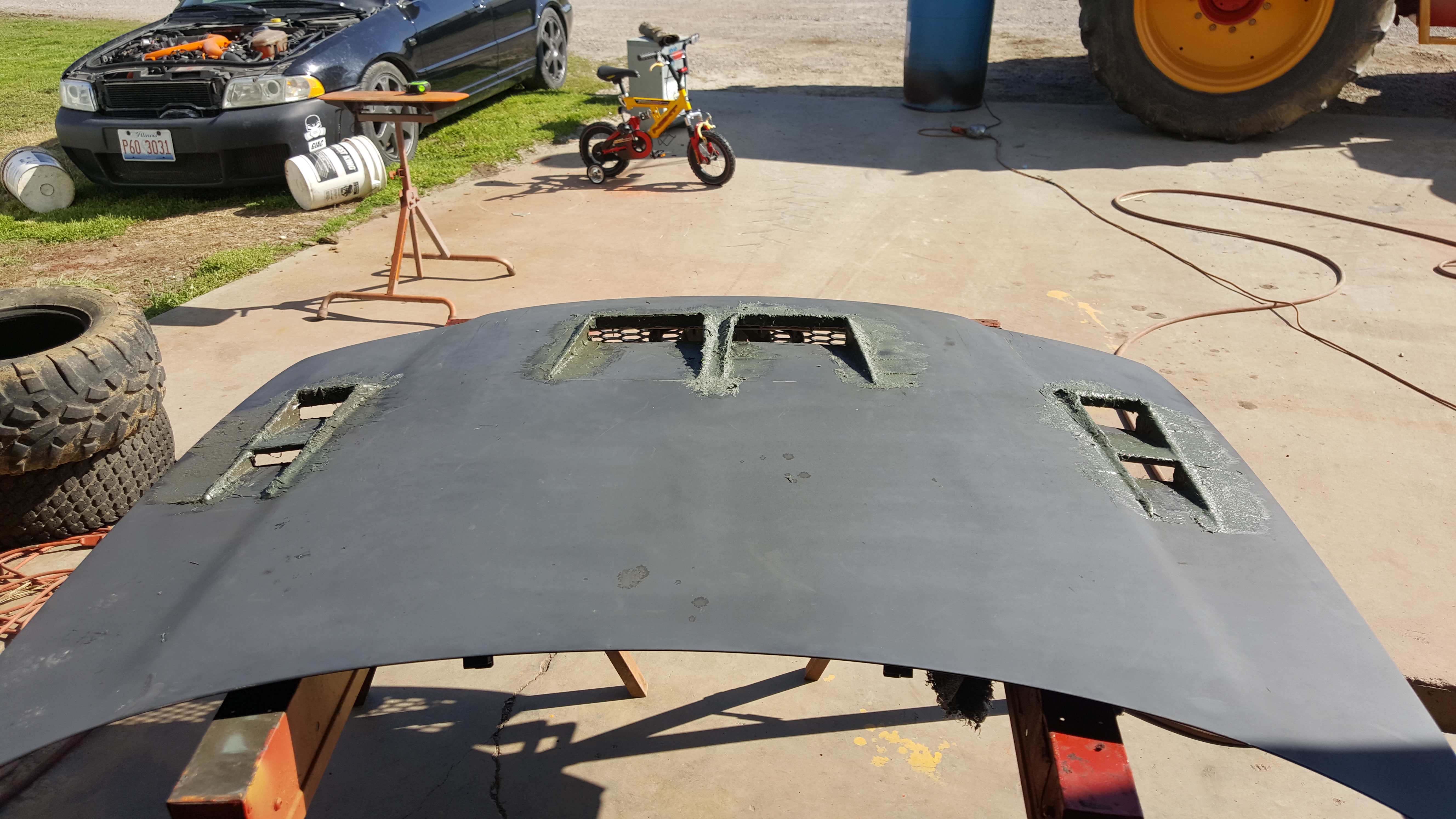

In primer
