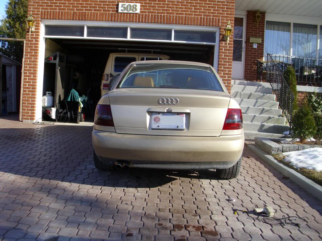

i did mine and a little lighter than in those pics. . Basically you can control how dark they are by the number of coats. So i did mine slightly darker but still look stock unless stock ones are beside them and then you can really tell. I think it gives it a more sporty and classy look. Thats my personal opinion but i'm very happy and have has them on since february with no tickets or scratching on them. heres a before and after when i put them on. P.s. Don't mind the stance because the car was up on a jack in the front right and makes the car look retarded here lol
before:
after:
