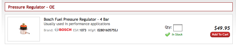

I've replaced only this in regards to "fuel" parts.

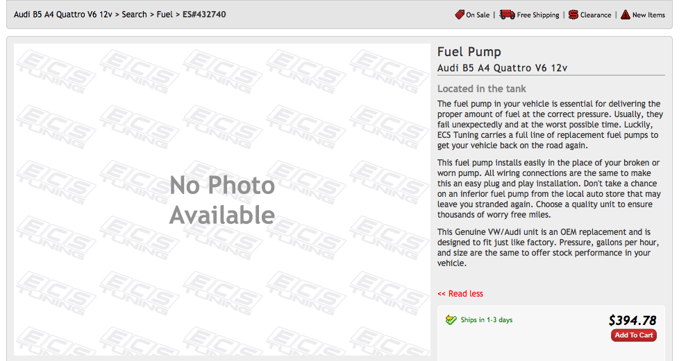

these are what I have on mind that may be the cause:

These are the only "hints" that I know, if you know of any other hint why its leaking please inform me, so I can check the part and see how much it'll cost me.
The only thing I cannot find online is a "FUEL TANK". Do you know a website or any company that sells FUEL TANK or do I have to go directly to Audi or Volkswagon for it? If so, do you know an estimate how much that is?
