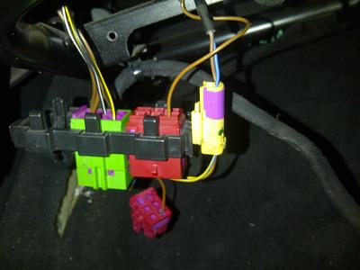

so i change the oem yellow/purple connectors, nd replace them with female/male nylon 14-16 gauge connectors (maybe i shouldnt have done that :S)

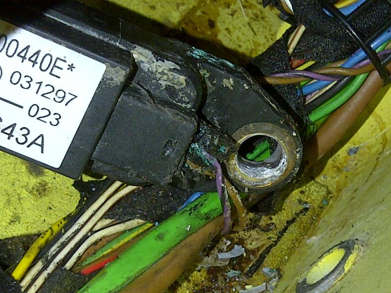

so now i only had the crash sensor open circuit that wouldnt go... so only then (stupid as i am, i never searched the actual codes online til then) i figured i needed a new passenger side crash sensor, i managed to locate it under the carpet, and replace it with a good one i found a scrap yard, i crimped both wires with butt connectors, going to the connector on the good sensor, since the old connector's wire was all corroded, couldnt managed to disconnected it from the sensor
didnt take pictures of the sensor after it was replaced, srry, was too excited to see if it ic could clear the codes... then i scan it, and the 2 codes are still there (the side igniter resistance too high came bck)

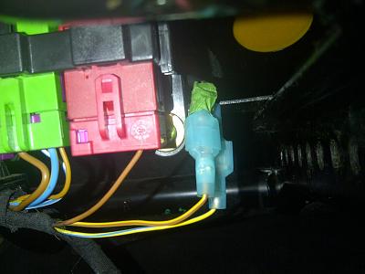

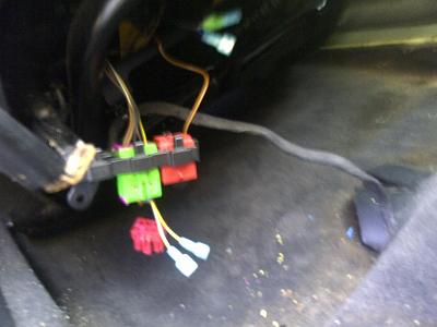

so i managed to clear the crash sensor open circuit, but the side igniter resistance too great/high kept coming back the next day (cleared it 3x, in 2 weeks span) i have to wiggle the new nylon connectors under the seat to clear the resistance too high code (if i dnt, itll clear but be right there if i press read codes again), but it keeps coming back after a few times starting the car (thats what the guys at the safety inspection did to make sure, the problem is really fix, nd i havnt just cleared the codes without actually fixing the issue...
last time i cleared the codes, i wrapped the connectors in electrical tape b4hand, see if it would help, but nothing, still came back...

anyways so now im positive my problem is either the male/female connectors are causing too much resistance due to the friction when u connect them (i think i might have plugged them together to tight) or its the wiring from the crash sensor under the carpet to the the connectors under the bench... im debating on what should i do to pass the safety, either inserting a 4.7ohm resistor into the wires (temporary solution), crimping butt connectors instead of the nylon male/female ones, or soldering and adding heat shrink tubing over the connection points: VWVortex.com - HOW TO: Perform your airbag TSB
