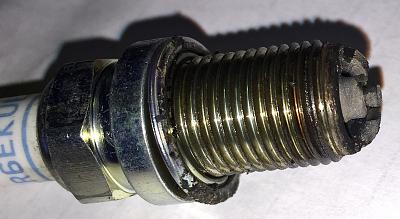

Dave...pulled #1 plug and found this. Is this what you mean?
I think I probably used too much 87 octane gas now that I think back. I'm pretty sure this can foul the plugs. Went out and bought new factory recommended Bosch plugs tonight and will swap in the morning and clear all codes again. The fouled plugs are NGK.
FWIW, I lightly scraped off some of the crud on the plugs and wire brushed them. Seems to have made a nice difference by just doing that, though new plugs are a necessity after viewing these...whether this is the problem or not. These plugs were installed 6 months ago.
Keeping my fingers crossed and make sure I only use 92 octane.
Much thanks for an easy fix (if this is what it turns out to be), instead of the headaches ahead I was dreading.

Yep.. That thing is glazed. Looks just like the ones I pulled from mine the other day. It's damn near impossible to get that crap off since it has basically been melted to the electrode and surrounding ceramic insulator. I'd go ahead and replace them all. Also make sure they are gapped about .032".
You might also want to reset the ECU. This will dump any crappy data that it may be trying to use to run the engine. To do this, remove both terminals from the battery (be sure to have the radio code just in case you need to re-enter it) and touch them together. This will discharge any power storage devices in the electrics including the ECU. Wait an hour or two and then reconnect the battery. Turn the ignition on but DO NOT try to start the car. Let the ignition switch set in the ON position for about 15 seconds. Then proceed to start the car. It may stumble for a few seconds but it should recover. The ECU will forget all the bad "memories" from before and if you have truly gotten the O2 sensor issues and the exhaust is not leaking anywhere between the engine and the downstream O2 sensor, it should be fine again.
