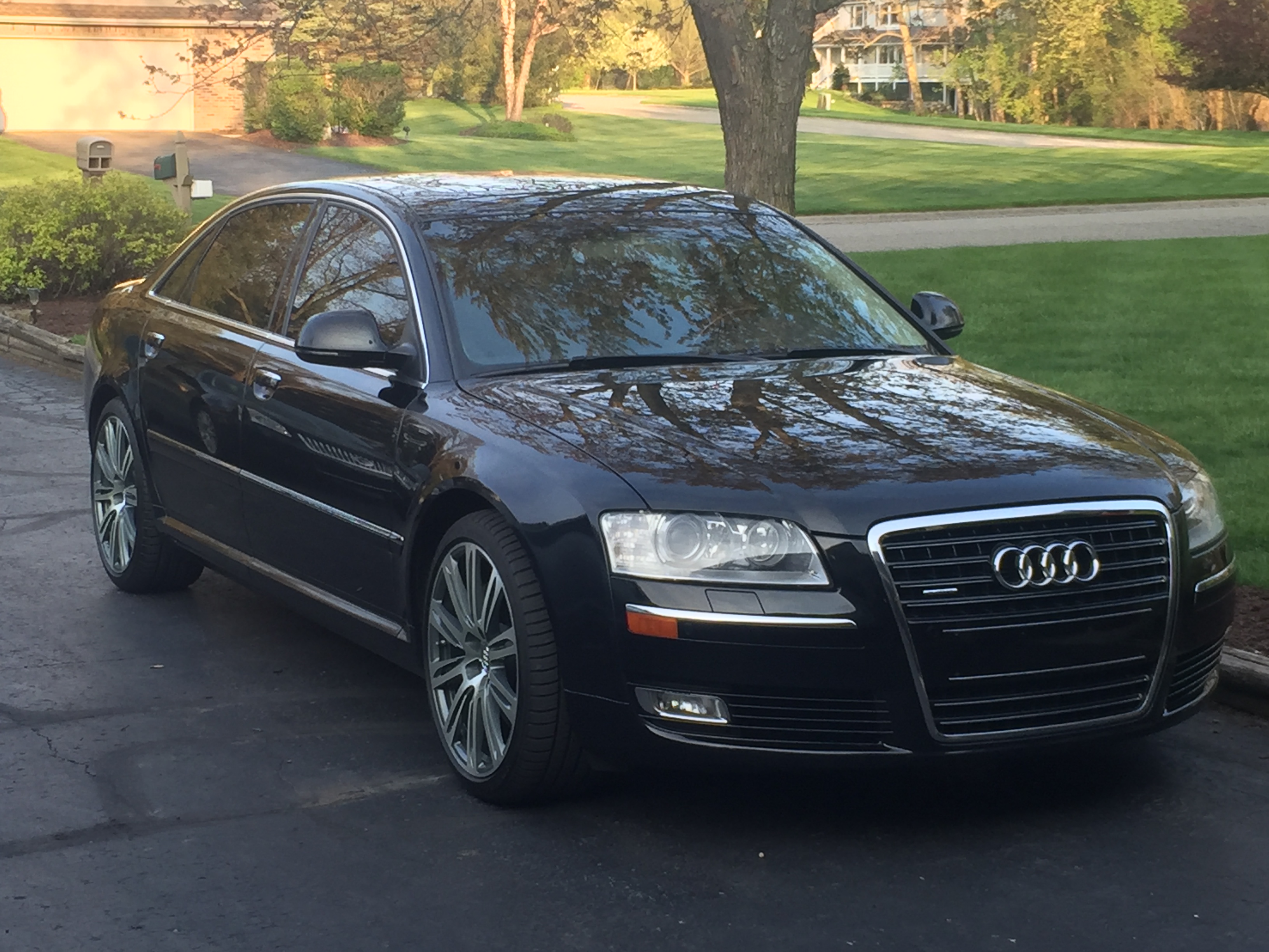

well , ive installed new wheels and tires and now the noise isnt as pronounced and is more like a high pitched harmonic noise from 60 to 70 mph . the sounds is a lot softer and less pronounced but still there. it is over a longer mph range now
i can very faintly feel in steering wheel .
20" Michelin tires 255/35/20
Attached Thumbnails Noise @ specific speed 2008 A8  w/video-img_1102.jpg
