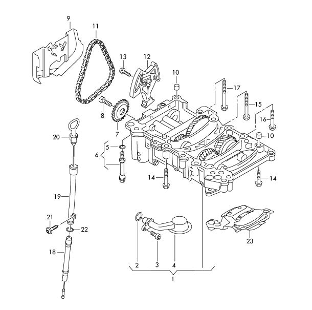

I don't have any advice for you, and believe those metal parts must have come from something farther inside your engine than you were able to check into. Did you take one of the rod caps off and look at the bearing? That would be another way to see if any damage was done and possibly how long the engine ran without oil pressure. My opinion, if you can still get at the bearing and the shell is damaged, meaning there is copper or scoring on it, don't put it back together, time for a rebuild. If nothing looks bad, I would take a look at the pump. This picture below shows there might be more to it than you'd think.
