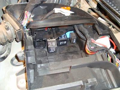

Shopkey lists P0688 as 'Power Supply Relay J271, Load Circuit Open' and suggests to check the ECM power supply relay, J271 for fault and/or activation, then runs through a wire/voltage check which if good means to replace the relay.
#3 in the E-box

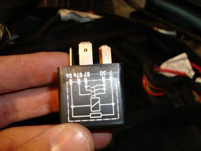

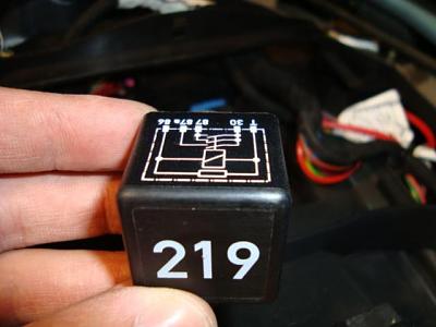

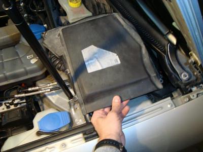

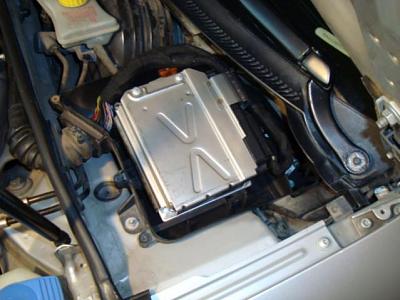

I opened the e-box plenum chamber, there is nothing suggesting J271, however, as per the ebox diagram, the voltage supply relay is at position 3, and this relay switch has number 219 on it...
The relay switch is $75.00 – Before I go purchase one, how do you test if it is indeed the root of the problem??? It doesn’t look burnt or damaged?!..!

I cant see the prongs, but if its the same as any Bosch 30amp relay like 99% of the others out there, you can get them cheap... or free at the junkyard
http://www.google.com/products?hl=en...ell=1&oi=spell
How ever.. 12v applied between 'T' and '86' should click the relay. When clicked, you should be able to read 0 ohms between '30', '87', and '87A'. There is also a diode in there to prevent voltage spikes when engaging/disengaging. If it goes, it can spike your ECU...

Hey Jim,
I've performed the test you suggested, the relay switch click and they all come back to 0 - which shows that the switch is working fine...
