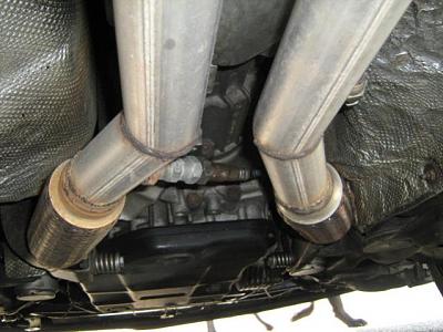

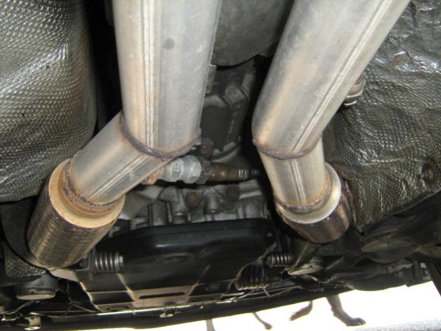

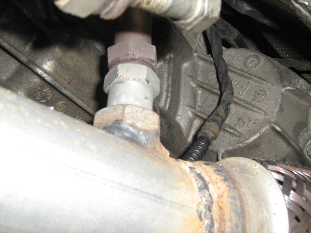

I have a 2001 A6 2.8 that i took the cats off of. Basically what i did is make a homemade test pipe.... I just cut the cats off and welded a angled pipe in their place. Put the non fouler trick in place. Basically a test pipe but home made.
With that being said, I keep getting error codes.
Code:
P0170 Fuel trim (bank 1)
P0160 O2 Circuit no activity detected (bank 2, sensor 2)
I have tried various things to fix that like backing the O2 sensor further away from the flow and angling it back but that gave me more codes(pic 1) also tried using one non fouler(pic 2) with no luck.
the passenger side is giving me the P0160, which is the right side(passenger) Pic 3 is just a pic of the setup
Im starting to gather my own opinions but I want everyone's input first...
Attached Thumbnails test pipe error codes-img_1613.jpg   test pipe error codes-img_1616.jpg   test pipe error codes-img_1622.jpg

Are the pictures of just the post cat 02 sensors location?

yea those pictures are of the post cat O2 sensors
