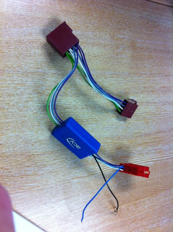

I have been out and checked everywire there is voltage on each wire on both sides of the loom i dont understand. This is the loom supplied by motormania can anybody confirm is this is the right harness any advice would be sooooooooo much appreciated.

I'd have to pull, my radio out, but you may have the wrong harness. I don't remember having the blue converter box as a part of my harness.
My B5 does have the Bose option, I'm not sure what your boss's setup is
