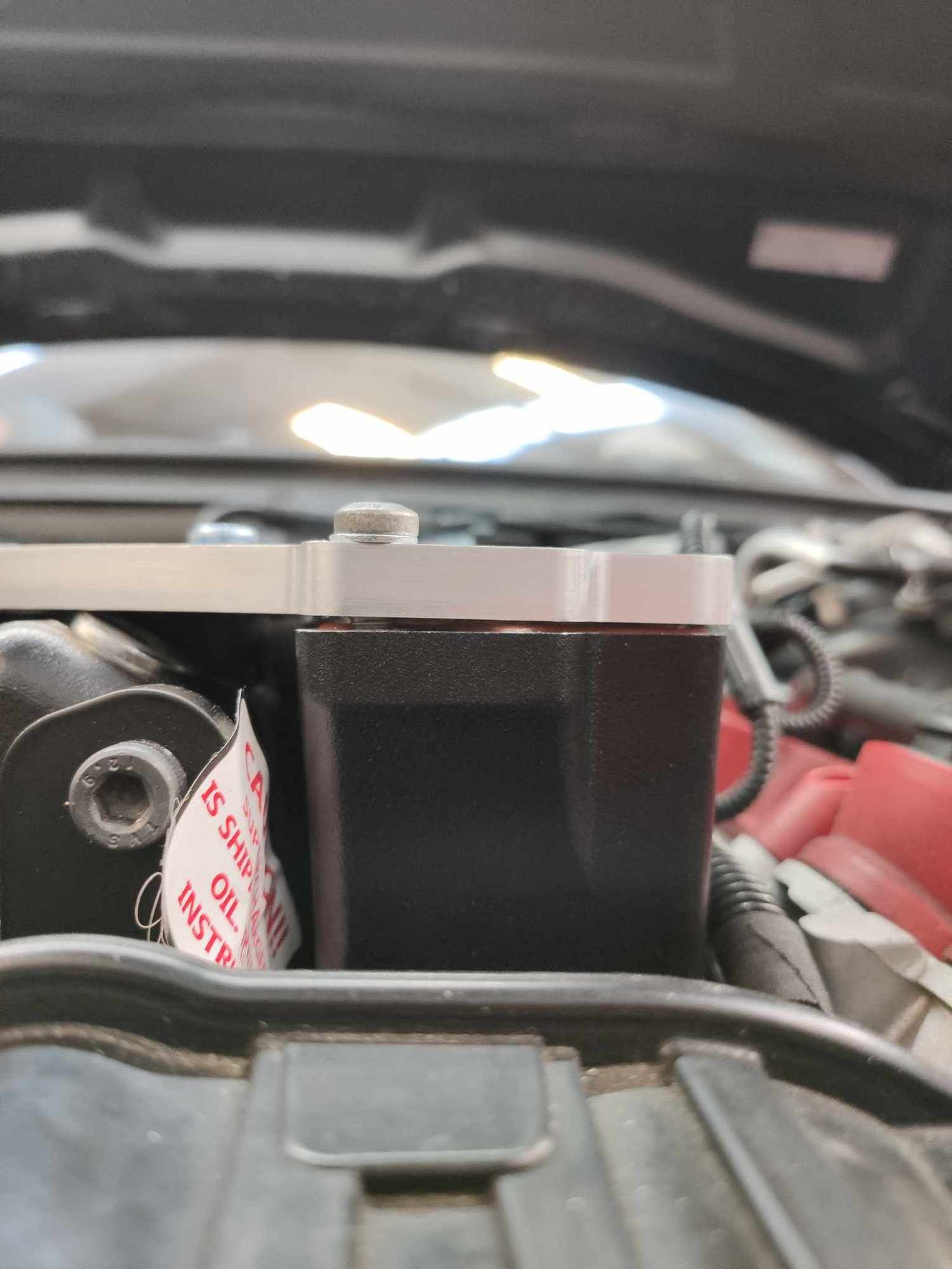

  • Supercharger clearance was off, first was that the charge cooler cores were sitting proud so the supercharger plate wouldn't seal, we found one of the end tanks on the core was welded crooked so the o-ring wouldn't sit in properly, required cutting off end plates and re-welding straight, we also had to linish the welds and cores down to fit.
    • When the Supercharger was bolted to the plate it was bowing it out as it was fouling on the supercharger itself, we had to clearance the plate to make it fit.
