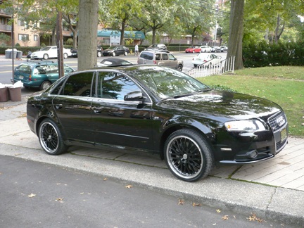

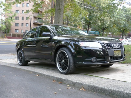

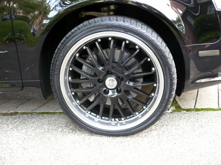

So I got my new rims and tires on yesterday. After what seemed like an eternity I was able to pull everything together. I want to thank egreenmachine for his part in this (he bought my old rims and tires).
So here they are: Privat Netz 19x8 with 40mm off set. Tires are Exclaim UHP 235/35/19
Yes, I know they look a lot like my old rims, but I wanted to go with a better wheel.
I did have to use wheel spacers otherwise the large front brake calipers hit, I ended up using a 6mm spacer on all 4 wheels just so they would be the same.
I have only had the combo on for one day but so far I can say I like the feel of these tires even better than the last ones. Over on tirerack these have a real good rating.
